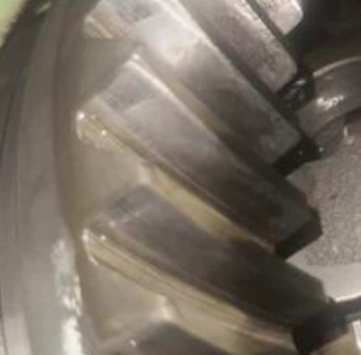

Here is the diff oil removed. Mostly a dark brown color with maybe a light metallic sheen. No metal chunks or shards. Maybe like one slight flake about the size of a grain of sand. Diff internally looks ok with no gears exploded or any visible wear. The black stuff wipes off, I think it is burnt diff oil. Lots of metal sludge on fill plug magnet.
I pulled the diff from the car so that I can further analyze it. I don't know if the whole thing is now junk, or if I can rebuild it on my bench? I have a press and tools, but I don't know if it is saveable. At a minimum, I know the bearings and seals should all be replaced, even if they look somewhat ok. Running with almost no fluid makes that seem like a must.
I checked backlash. Absolutely zero backlash at the ring gear when holding the pinion still. Ok, so somehow I lost all backlash. Does anyone know what would cause this? Some sort of bearing failure maybe? I would think if the gears themselves failed the backlash would be much greater as they ate away at each other with no lubrication??? I just bought some gear marking paint, and I will analyze that pattern when it arrives in the mail.

Could be bearings or it could be gears.
The pattern on the teeth looks good, but probably shouldn't be seen so easily.  Looks like wear, you might take a really close look at individual teeth faces.  If that's where the noise is coming from then you might need to move the OEM gears over to the CLSD carrier and give it a full rebuild.  Regardless I think that the CLSD portion is probably fine.
Differentials can survive and function with some pretty bad looking gears.  If it's not too noisy with a full oil level, maybe just drive it and see what happens.

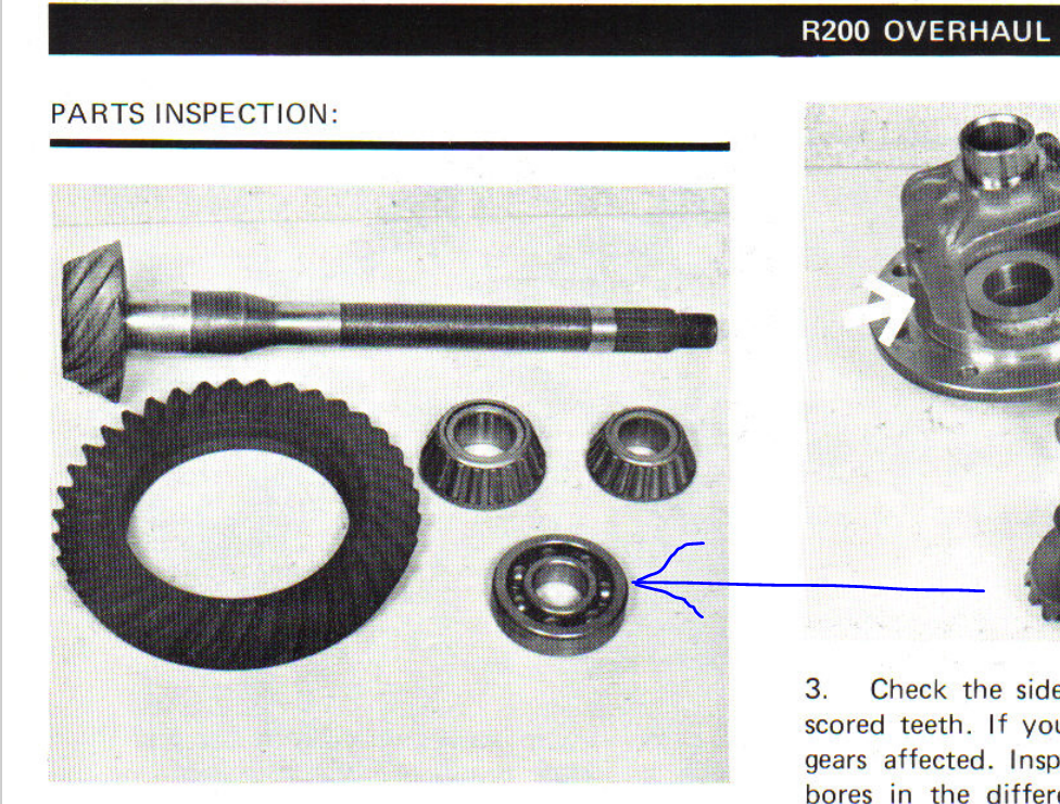

@inline6 Thank you for the detailed advice. I am just learning about the realm of differentials. They don't seem too complicated, just a very exact science like you mentioned with the pinion depth and bearing preload. Something I would like to avoid, but I never have backed down from a challenge yet. Can you describe to me which one is the pilot bearing? I can't seem to locate it in general diagrams.

It is the front-most bearing on the pinion gear - in the nose of the differential - blue arrow.
