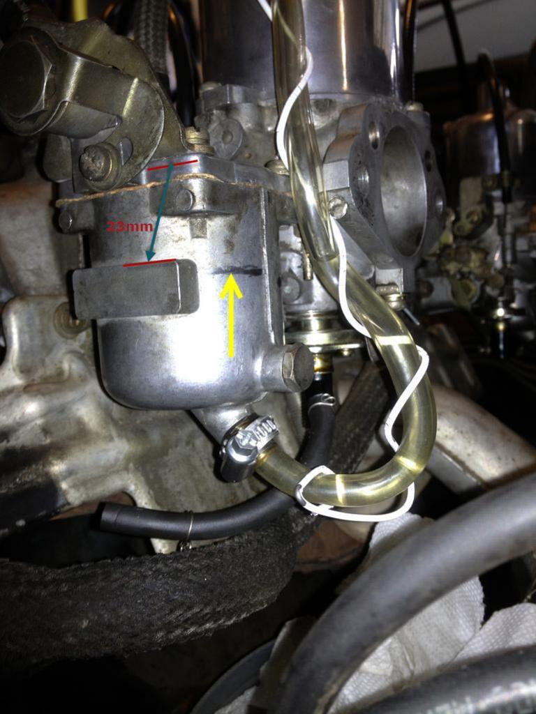

My float chamber lids had loosened over time and caused me some problems. Make sure those screws are snug and the gaskets are complete, no wrinkles.
My filter was low of fuel but after I got the float levels right it stays pretty full at idle. I have '72 carbs though, they're a little different than your's and @Mark Maras
My favorite pic I "borrow" from @zKars (I think) shows it done on the car.
