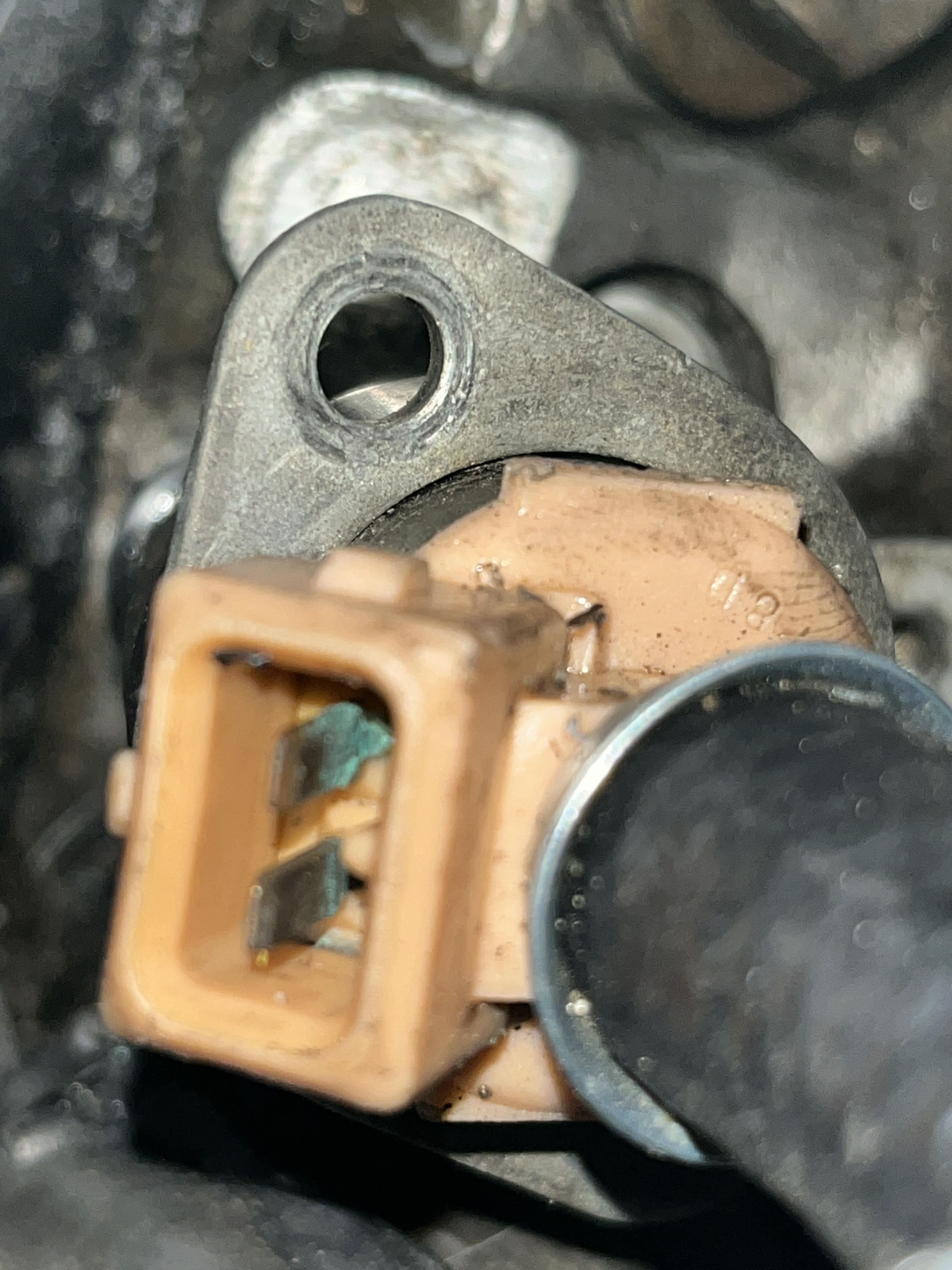

Hi gang,
So I pulled my injectors, put them all in individual cups and cranked the engine for a bit and all seem to have the exact same level and spray pattern (see video here).  I did however notice cylinder 1's injector connector teeth had a pretty solid amount of green corrosion on it which is weird considering these are only a year or so old with brand new harness connectors.  I did also notice small black particles in the gas coming out of the injectors - I'm not sure if that is just dirt from them resting on the head while waiting to be put in the cups or not.
Long story short here is where we are:
  • I filled up the injector's plug area with caig de-oxit and let it sit all night and ill remove the corrosion this morning
  • I will get a new engine bay fuel filter just in case it's not just dirt sitting on the engine intake plenum while they were resting there
  • Switch injector #3 with a different one to see if the darker plug on cylinder #3 darkens darkens on the cylinder with the moved injector or not
