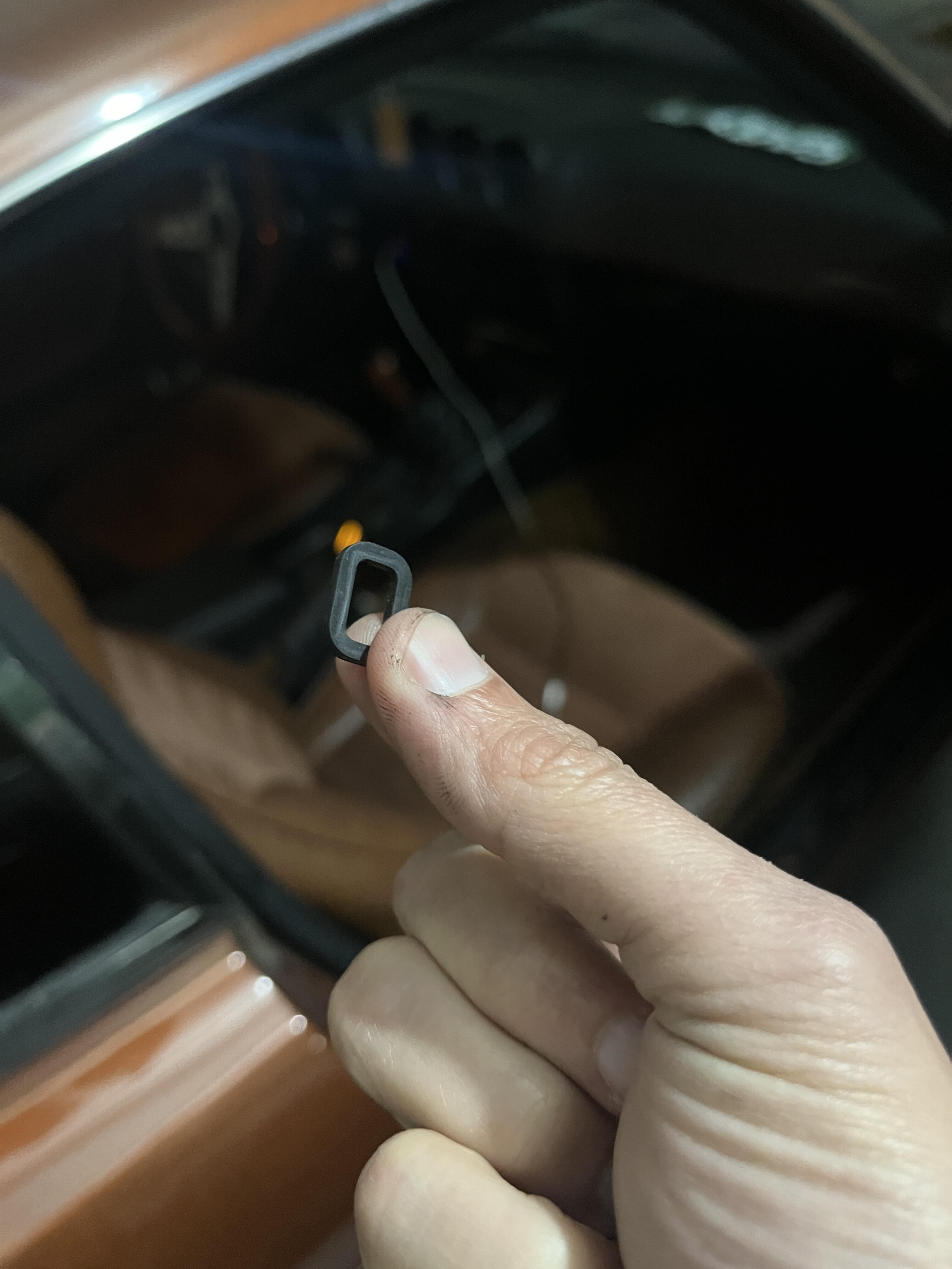

Final update: Culprit found - case closed
The weatherstrip (the rubber rectangular gasket that goes inside the efi connector) for cyl1 was working its way out of its mount when the car warmed up and prohibited cyl1's efi connector from fully seating.
I noticed that today when I needed to pull over to the side of the road due to the engine (now I know as cyl1) running prohibitively lean on my air/fuel ratio gauge.  I found I was unable to push cyl1's injector power cable fully in so I removed that piece of rubber, could plug the connector in firmly, and now the car runs awesome with power throughout the rev-range for the first time in a while.
I originally noticed this issue when I pulled the fuel rail to run tests on injector flow and reseated the rubber piece back in the connector - but I guess it had other ideas.  I have permanently removed that piece and may pull the others to prohibit this in the future.
Thanks for all of your help with this
-chase

I'm sure you already know this, but that seal (in theory) should not affect the electrical connection function. In theory.
But it's completely conceivable that mixing and matching different vendors parts with various levels of design and manufacturing pedigree... Seems something wasn't done quite right. And if pulling that seal out fixes it, so be it!  I'm glad it's that simple!   :beer:
Honestly, I feel a bit silly posting this, but I did take a second look today in the light and there were actually 2 of those rubber seals in the plug instead of 1.  There was no way that was ever going to make good contact like that - there isn't enough physical space inside the connector for that to happen.
That said, I'd rather feel like a doofus than have the car run like it had been and at least now I know all of the other systems are working as intended.
Haha!! You know... I was gonna suggest that as a possibility! I should have! Would have looked like a rock star! LOL
Don't worry about looking like a doofus. I do it all the time!  Hahaha!!
