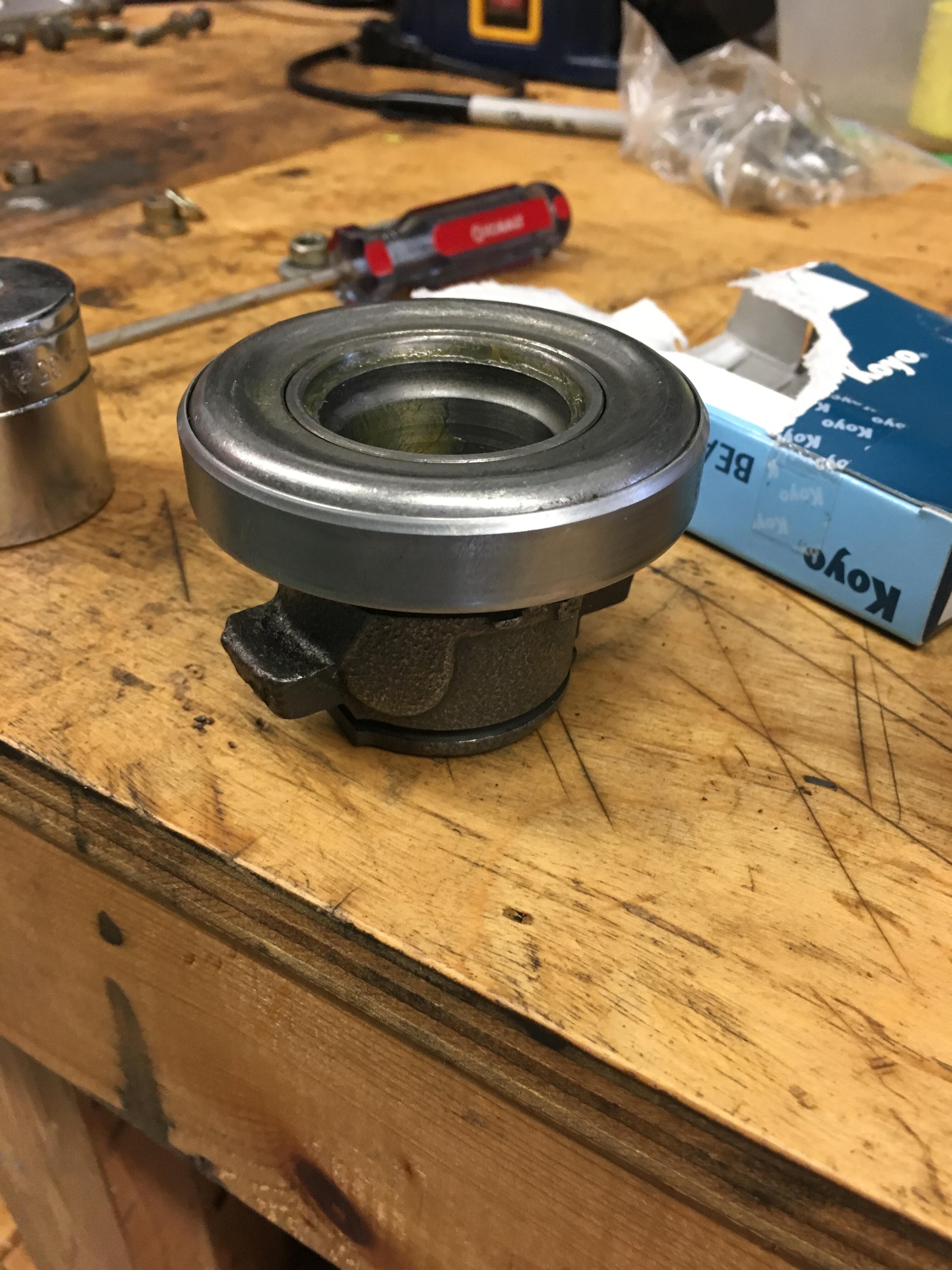

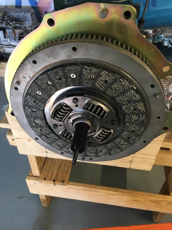

February 9, 20241 yr Author comment_661868 I’m as perplexed as both of you. I think it’s just a hodgepodge of “make it work” pieces. Who knows.Like zed mentioned, I’m just replacing it all to be sure.Asked my machinist about lightening the flywheel while he was resurfacing it, but the cost would’ve been darn near the price of a fidanza aluminum piece. So I just decided to resurface it for $65. Done, picture attached.Now, selecting a clutch kit. The only 225mm kit that includes a collar, is the perfection clutch kit. It seems to be sold by summit and autozone as well, just with different branding (zoom, duralast). It’s economical and seems to have decent reviews. Zed, I know you weren’t a fan. But it’s the only kit that includes a collar and would eliminate that headache.I’d like to consider exedy, but it doesn’t come with a collar, so I’d then have to do the whole 92mm measurement mess and then spend another $50 on a collar, maybe.Unless someone can confirm that my existing collar will work with the exedy kit, I’ll prolly just order the perfection kit because I know the collar will be right…Sent from my iPhone using Tapatalk Link to comment https://www.classiczcars.com/forums/topic/68807-is-my-throw-out-bearing-correct/?&page=4#findComment-661868 Share on other sites More sharing options...

February 10, 20241 yr Author comment_661911 I have Exedy 240Z clutches (Made in Japan) in all five of my L28 Z’s and they are perfect. Do what you want, but if you order an Exedy pressure plate and disc and specify 240Z, you can then order the 240Z collar and throw out bearing from Motorsports and if you have any questions, those guys know what they are doing and can help you. They probably have the Exedy clutches too. If you do that, you can forget measuring…..you’ll reinstall with confidence! PS Make sure to confirm the size of your flywheel is a 225 mm (the facing looks awful wide in your pic) or you’ll need to order the clutch and collar for a 2 plus 2. Motorsport sales folks can help you with that too. [emoji106] Agreed, I’d love to get the exedy kit. This is the correct kit for a 280z with a 225 flywheel (which I measured and confirmed is what I have)…https://a.co/d/iPBEEjiI also have the Type B collar circled below…Would love to know if the type B 4 speed collar is correct for the exedy 06009 clutch kit but I cant seem to confirm that.It would make sense that the two are compatible given the Type B collar is typically found in 280z’s. And this exedy kit if for a 280z.Anyone out there able to confirm?Sent from my iPhone using Tapatalk Link to comment https://www.classiczcars.com/forums/topic/68807-is-my-throw-out-bearing-correct/?&page=4#findComment-661911 Share on other sites More sharing options...
February 10, 20241 yr Author comment_661913 Pretty sure I found a post that answers my above question, and the answer is yes, my longer collar should be correct for the exedy 06009 kit. Answer is in the very first post…https://www.classiczcars.com/forums/topic/64999-variable-clutch-cover-height-or-thickness-availability/Sent from my iPhone using Tapatalk Link to comment https://www.classiczcars.com/forums/topic/68807-is-my-throw-out-bearing-correct/?&page=4#findComment-661913 Share on other sites More sharing options...
February 10, 20241 yr comment_661914 It’s really very simple. If you are sure you have a 225mm flywheel, you can use a 240Z clutch and 240Z collar or a 280Z clutch with a 280Z collar……your choice. Call Motorsports and tell them you want a 240Z clutch and a 240Z collar and throwout bearing. They will send you the correct combo. My 280 motors with 225mm flywheels all run the 240Z cluches. I like them best. Edited February 10, 20241 yr by Diseazd Link to comment https://www.classiczcars.com/forums/topic/68807-is-my-throw-out-bearing-correct/?&page=4#findComment-661914 Share on other sites More sharing options...
