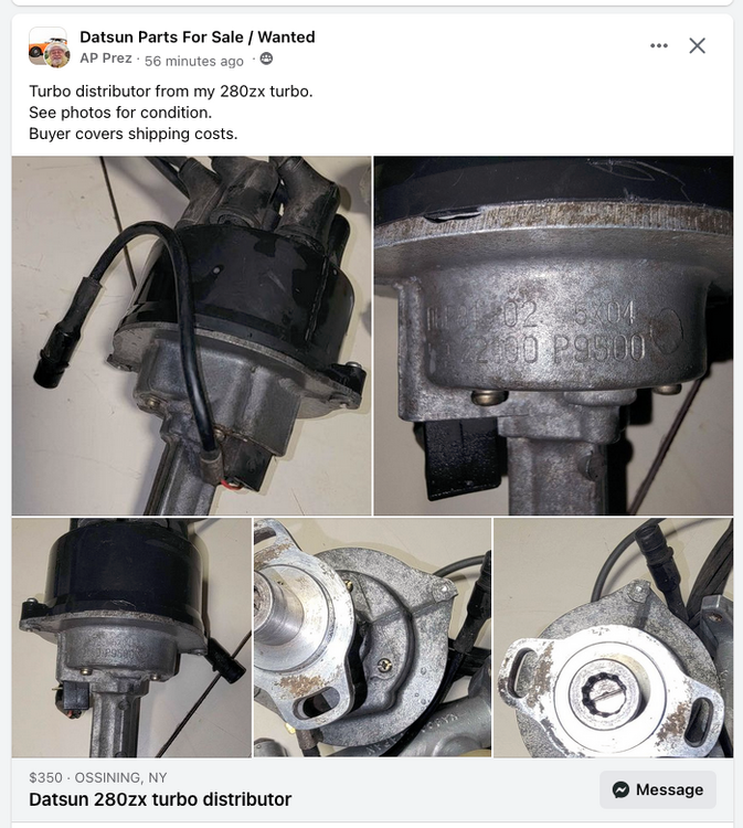

February 7, 20241 yr comment_661791 I saw this on Face Book. $350 seems a bit steep though. Link to comment https://www.classiczcars.com/forums/topic/68808-parts-wanted-280zx-turbo-distributor/#findComment-661791 Share on other sites More sharing options...
February 7, 20241 yr Author comment_661793 @Terrapin Z I saw some on ebay for like $1000 dollars which is rediculous. I agree even $350 seems steep, especially because that one doesnt look to be in the best condition. Going to check it out now. Thank you! Link to comment https://www.classiczcars.com/forums/topic/68808-parts-wanted-280zx-turbo-distributor/#findComment-661793 Share on other sites More sharing options...
