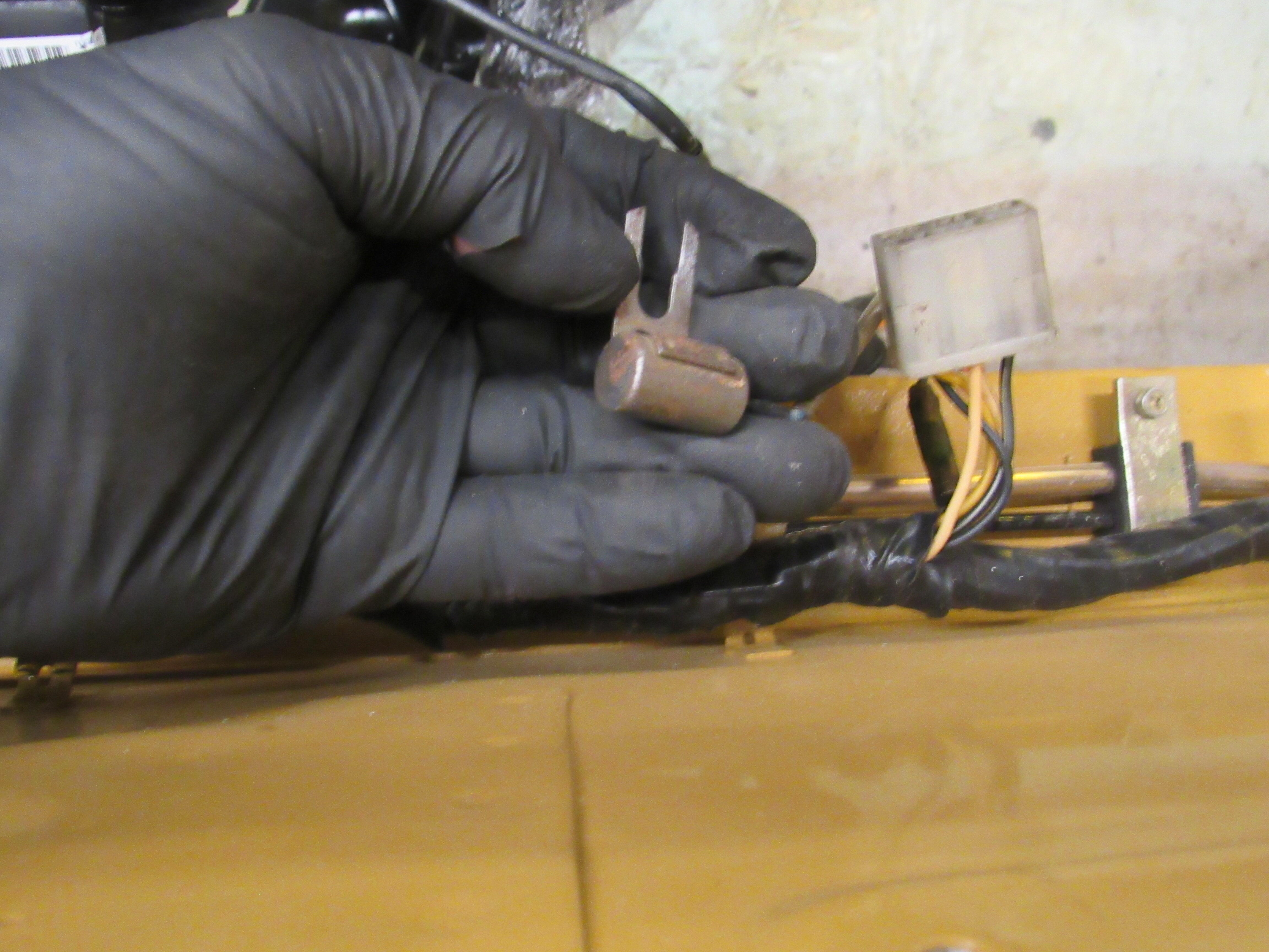

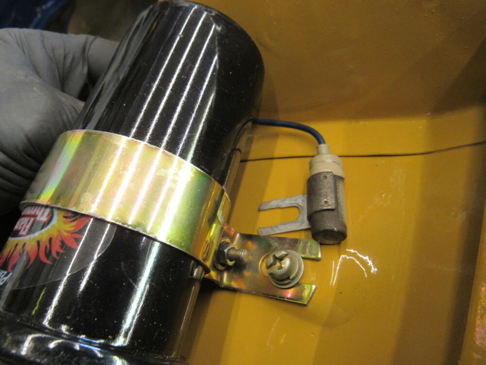

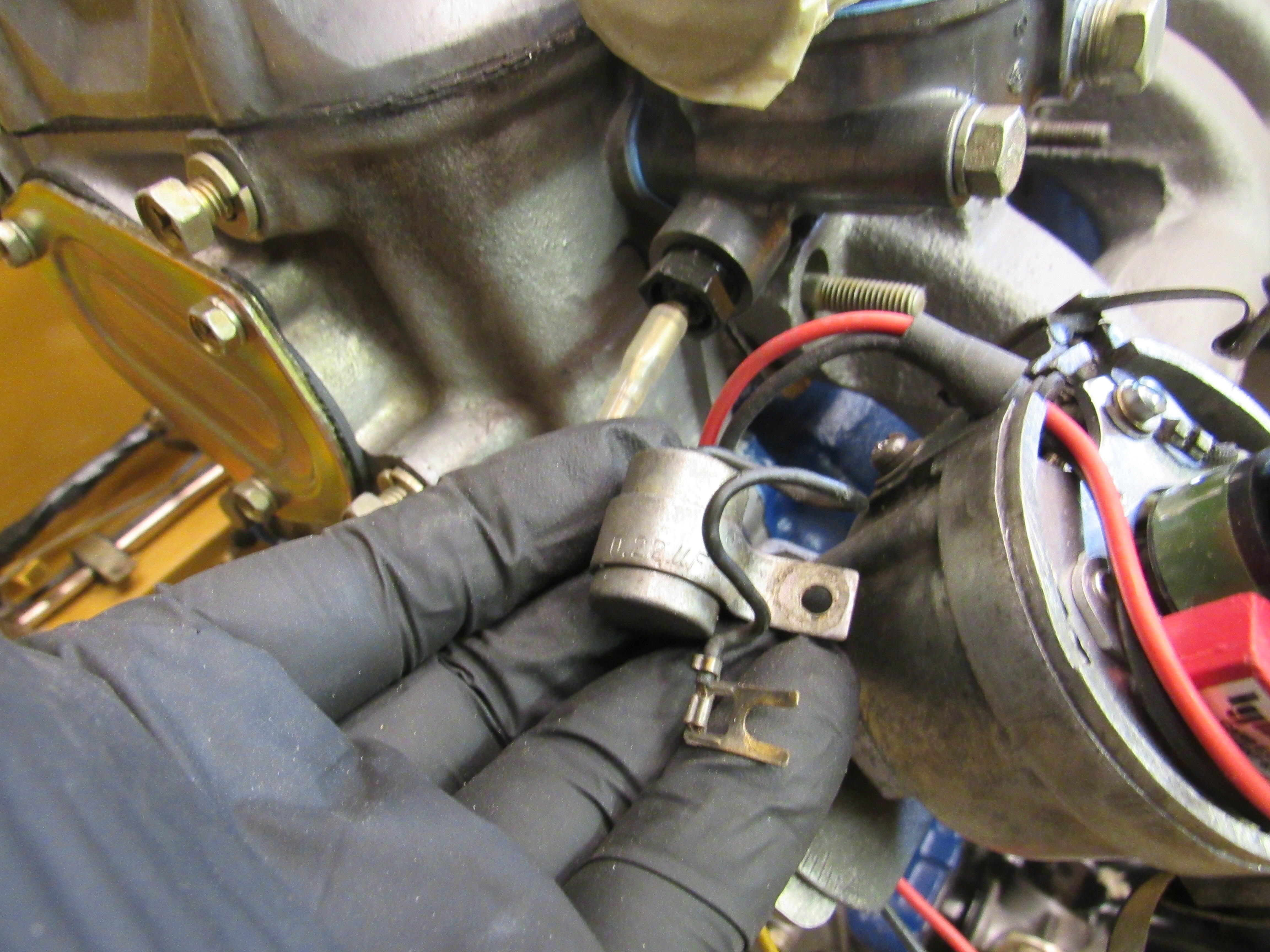

Posted February 22, 20241 yr comment_662320 There are three of them, one on the distributor, one on the coil and one near the alternator. There is a new alternator coming with an internal regulator, the spark is going to be handled by a Pertronix II unit and the spark plugs are NGK BPR6ES, do I need them? Thanks Link to comment https://www.classiczcars.com/forums/topic/68826-what-are-these-things-and-are-they-still-needed/ Share on other sites More sharing options...
February 22, 20241 yr comment_662321 Condensers (aka capacitors) for electrical noise reduction (alternator) and protect points & electrical noise reduction (ignition). Unless you're using a stock radio or similar vintage, you don't need them. Link to comment https://www.classiczcars.com/forums/topic/68826-what-are-these-things-and-are-they-still-needed/#findComment-662321 Share on other sites More sharing options...

February 24, 20241 yr comment_662398 9 minutes ago, dutchzcarguy said: Don't they protect the ign.points so they don't ware out faster? My 240z has the one on the ignition standard and i used the last 24 years one for 20+ years and it was still good but i installed one new after 20 years.. Cap. is still the same.. I think the points spark less with the capacitor on? He said he's going to Pertronix II, so there won't be points. Link to comment https://www.classiczcars.com/forums/topic/68826-what-are-these-things-and-are-they-still-needed/#findComment-662398 Share on other sites More sharing options...
