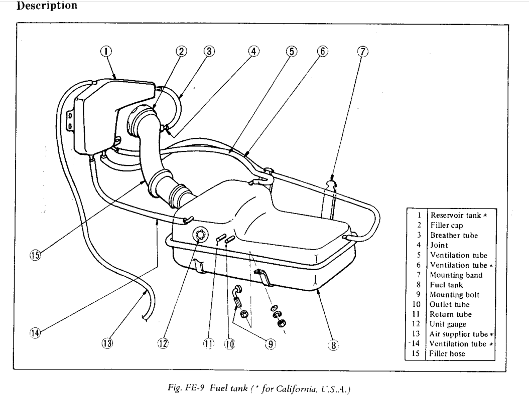

February 26, 20241 yr comment_662504 6 hours ago, Zooter71 said: So I removed the fuel tank and all hoses and replaced said hoses because I found 52 year old hoses.... I'd check the air supplier tube and/or the gas cap. And the breather tube. (Edit - actually all of the ventilation tubes. There seem to be many. Must be important.) I see that siteunseen has just replied. Same thought... . . . Edited February 26, 20241 yr by Zed Head Link to comment https://www.classiczcars.com/forums/topic/68830-1971-240z-engine-wont-idle-smoothly-after-fill-up/#findComment-662504 Share on other sites More sharing options...
