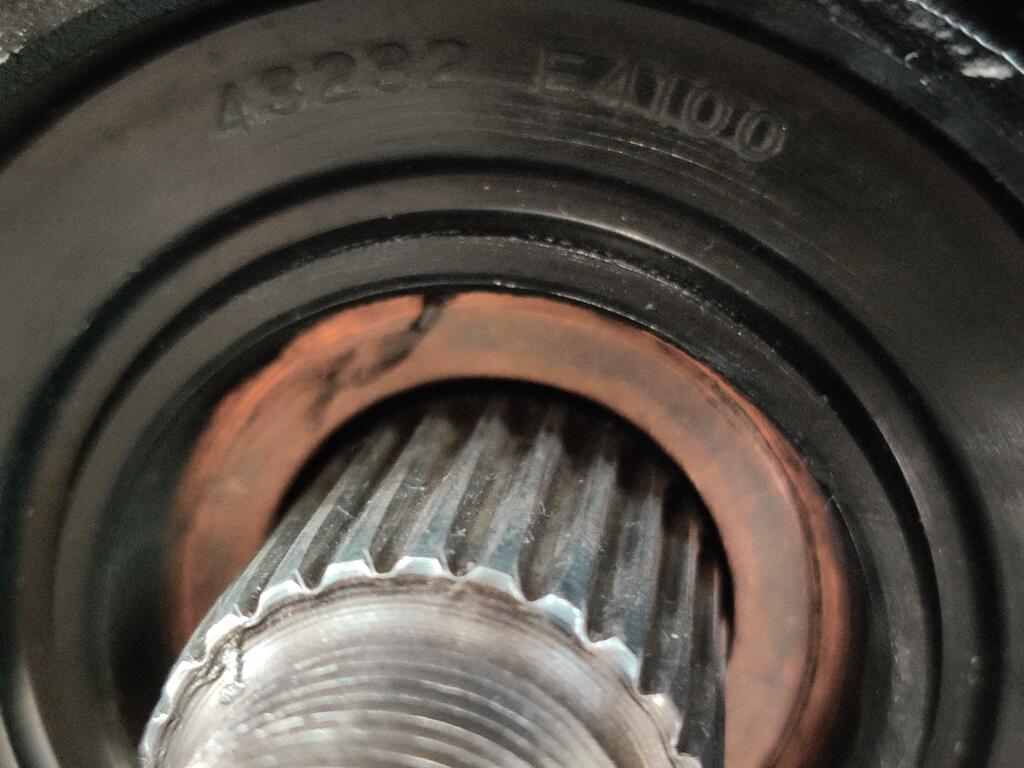

Posted February 27, 20241 yr comment_662518 1972 240zAlright, I’ve read all the posts regarding this copper washer that was installed as part of a TSB to reduce noise of some kind, and then was done away with in later models. Mine are in fine shape. Leave them in? Or toss them? Or indifference? I can’t seem to arrive at a consensus with what I read. The one advantage to leaving them in is that the TSB says to torque the axle nut to ~120ft/lbs, which is actually attainable with my torque wrench, as opposed to the ~200+ ft/lbs required if you leave the washer out. Sent from my iPhone using Tapatalk Link to comment https://www.classiczcars.com/forums/topic/68832-copper-%E2%80%9Cnoise-reduction%E2%80%9D-washer-in-rear-hub-assembly/ Share on other sites More sharing options...
February 27, 20241 yr comment_662519 They were in there before, correct? Did you have any issues or problems? If not I'd reassemble as before. Dont break it, if it ain't broke! Link to comment https://www.classiczcars.com/forums/topic/68832-copper-%E2%80%9Cnoise-reduction%E2%80%9D-washer-in-rear-hub-assembly/#findComment-662519 Share on other sites More sharing options...
February 27, 20241 yr comment_662521 I put mine back in. I also like that lower torque setting. Where is your seal? It is missing from the picture you shared. It goes in before the axle flange goes on. Link to comment https://www.classiczcars.com/forums/topic/68832-copper-%E2%80%9Cnoise-reduction%E2%80%9D-washer-in-rear-hub-assembly/#findComment-662521 Share on other sites More sharing options...
February 27, 20241 yr Author comment_662522 Bought this car as a non running project, so no experience with it before, but everything appeared OK. Yes, they were originally on the car.Yeah, I’m liking that lower torque spec.Yep, I have the oil seal, just didn’t have it installed for the pic.Appreciate the feedback.Sent from my iPhone using Tapatalk Link to comment https://www.classiczcars.com/forums/topic/68832-copper-%E2%80%9Cnoise-reduction%E2%80%9D-washer-in-rear-hub-assembly/#findComment-662522 Share on other sites More sharing options...
