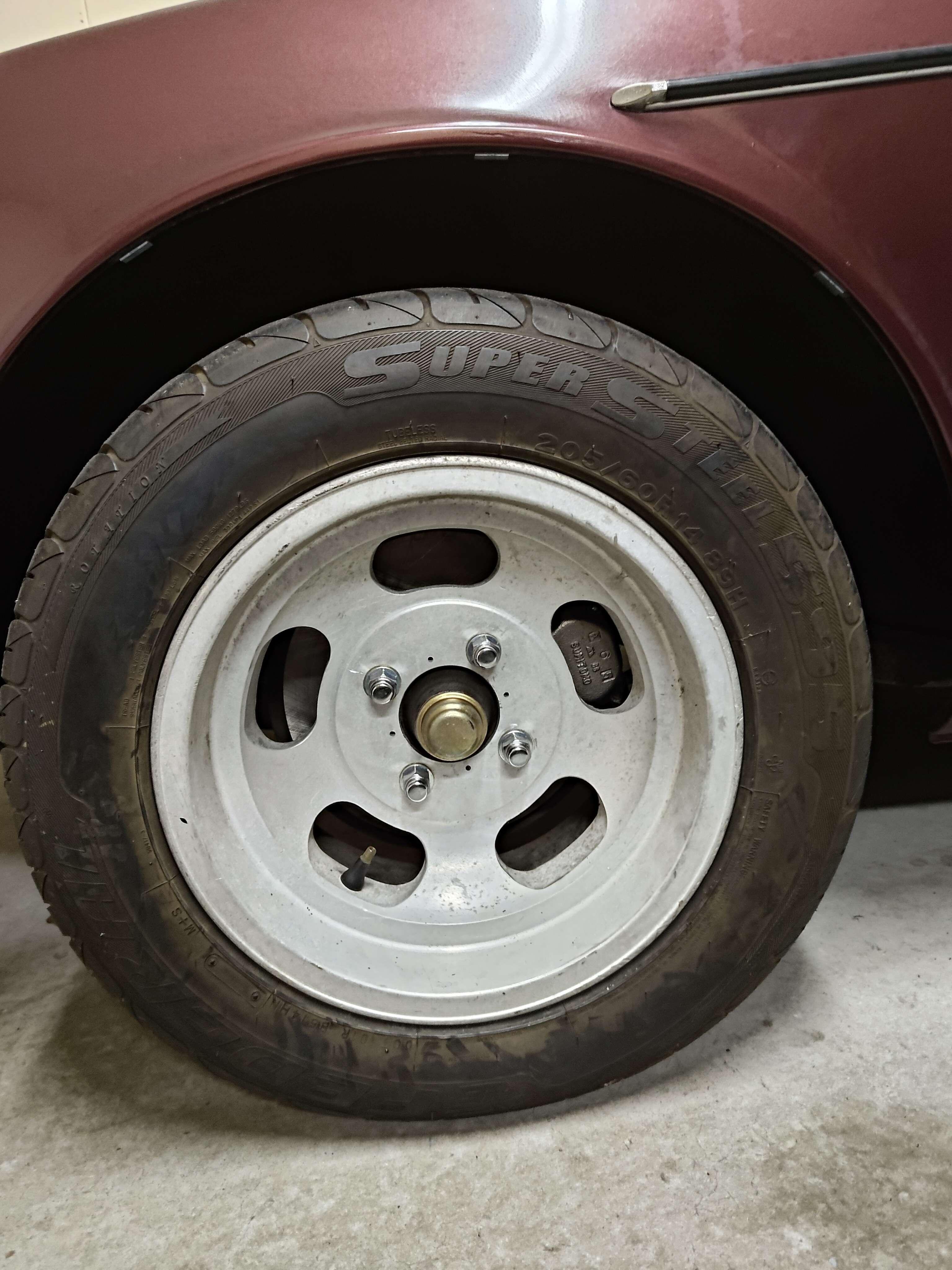

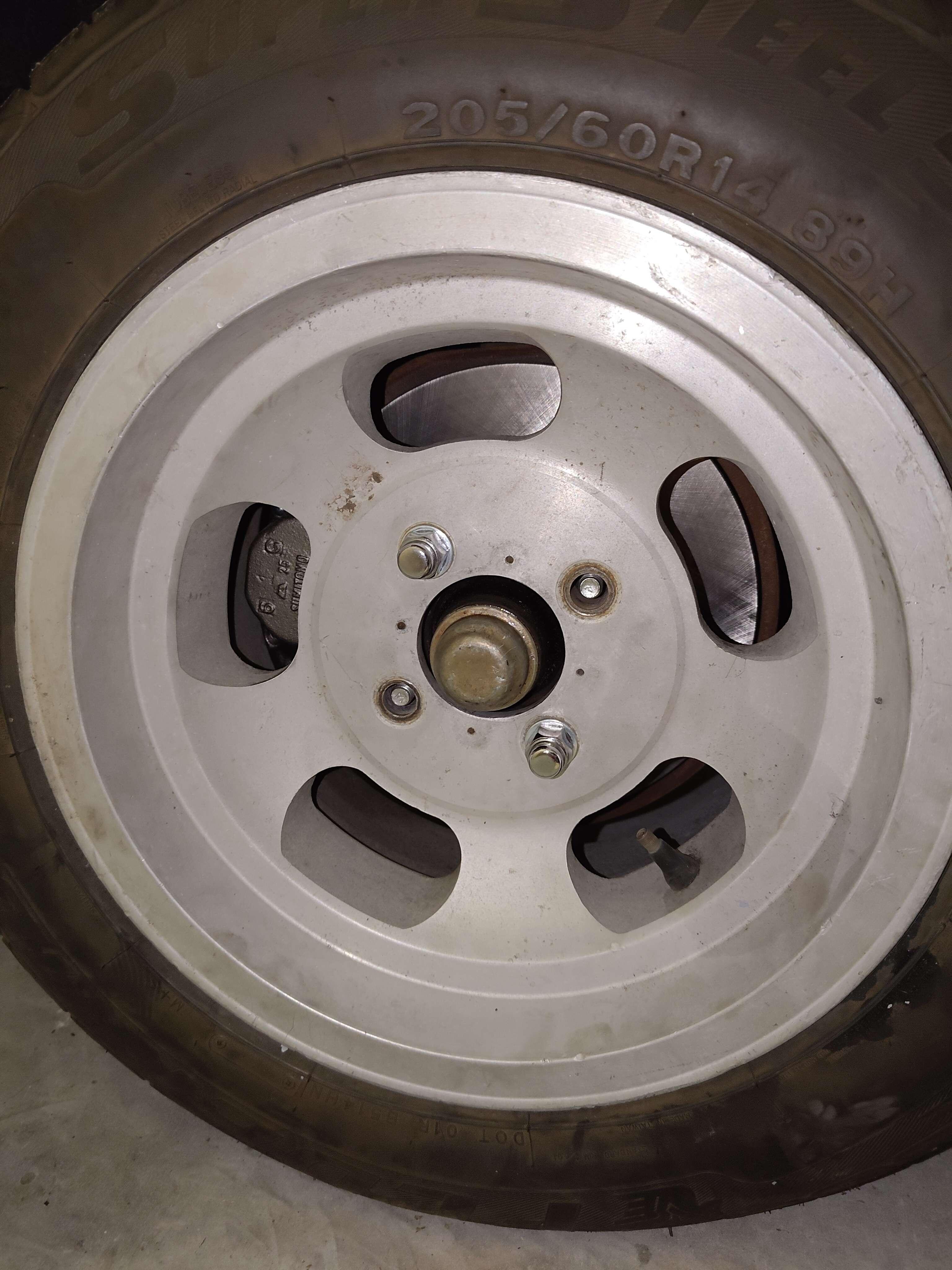

February 27, 20241 yr Author comment_662535 On 2/27/2024 at 10:53 AM, jonbill said: I don't quite understand what you're describing, but it sounds wrong. It should be the same left and right. I don't know what wheels you have, some fit different wheels front and back, but the standard is the same wheels front and back. Trying to find a better way of saying it... If you put the rim against the hub like you're about to thread the lugnuts on: The drivers side front has studs that stick out past the lug holes. The passenger side front, the studs are recessed inside the wheel. They are the same studs in each hub, I ordered a set of eight and thats what were pressed in, so it just seems weird that the studs on the drivers side would stick out further than the ones on the passengers side when they're the same studs. Do Z's have different front and rear wheels? I took a photo of the driver and passenger side front wheels: Driver side front: Passengers side front: You can see how the studs don't stick out past the surface of the rim on the passengers side, and I can't get it to line up with the other two lugs to get them on. As for the drivers side, I think the lug nuts may also be an issue...The washer on two of them could be freely spun, even though the lug nuts are torqued down, I'm going to try replacing the new lug nuts on the drivers side with the old four lug nuts it had on it before and see if that stops the noise. For all I know the wheel isn't torqued down, and thats causing the noise. Link to comment https://www.classiczcars.com/forums/topic/68833-repetitive-clunking-noise-from-driver-side-only-when-in-motion-how-concerned-should-i-be/#findComment-662535 Share on other sites More sharing options...
February 27, 20241 yr comment_662544 The wheel isn't seated all the way against the hub face. Driveshafts would also be a suspect for clunky noises Link to comment https://www.classiczcars.com/forums/topic/68833-repetitive-clunking-noise-from-driver-side-only-when-in-motion-how-concerned-should-i-be/#findComment-662544 Share on other sites More sharing options...
February 27, 20241 yr comment_662545 On 2/27/2024 at 12:31 PM, Patcon said: The wheel isn't seated all the way against the hub face. Driveshafts would also be a suspect for clunky noises Or the new studs weren't fully seated when installed and still need to be drawn out with the nut. There is a reason all new wheels are hub concentric these days, the old stud concentric wheels like yours were problematic. Link to comment https://www.classiczcars.com/forums/topic/68833-repetitive-clunking-noise-from-driver-side-only-when-in-motion-how-concerned-should-i-be/#findComment-662545 Share on other sites More sharing options...
February 27, 20241 yr comment_662548 On 2/27/2024 at 11:13 AM, NocturnalEmber said: The washer on two of them could be freely spun, even though the lug nuts are torqued down, I'm going to try replacing the new lug nuts on the drivers side with the old four lug nuts it had on it before and see if that stops the noise. For all I know the wheel isn't torqued down, and thats causing the noise. You've been lucky. Your wheel is probably wobbling and that can cause the nuts to loosen. Once they get loose they spin off pretty fast. I lost two lug nuts on about a 1/2 mile drive because I forgot to torque them down after putting a wheel back on. The remaining two were trying to be free also. Stick the lug nut in the holes before installing the wheels. If the nut sticks all the way through the hole it's too long. Link to comment https://www.classiczcars.com/forums/topic/68833-repetitive-clunking-noise-from-driver-side-only-when-in-motion-how-concerned-should-i-be/#findComment-662548 Share on other sites More sharing options...
