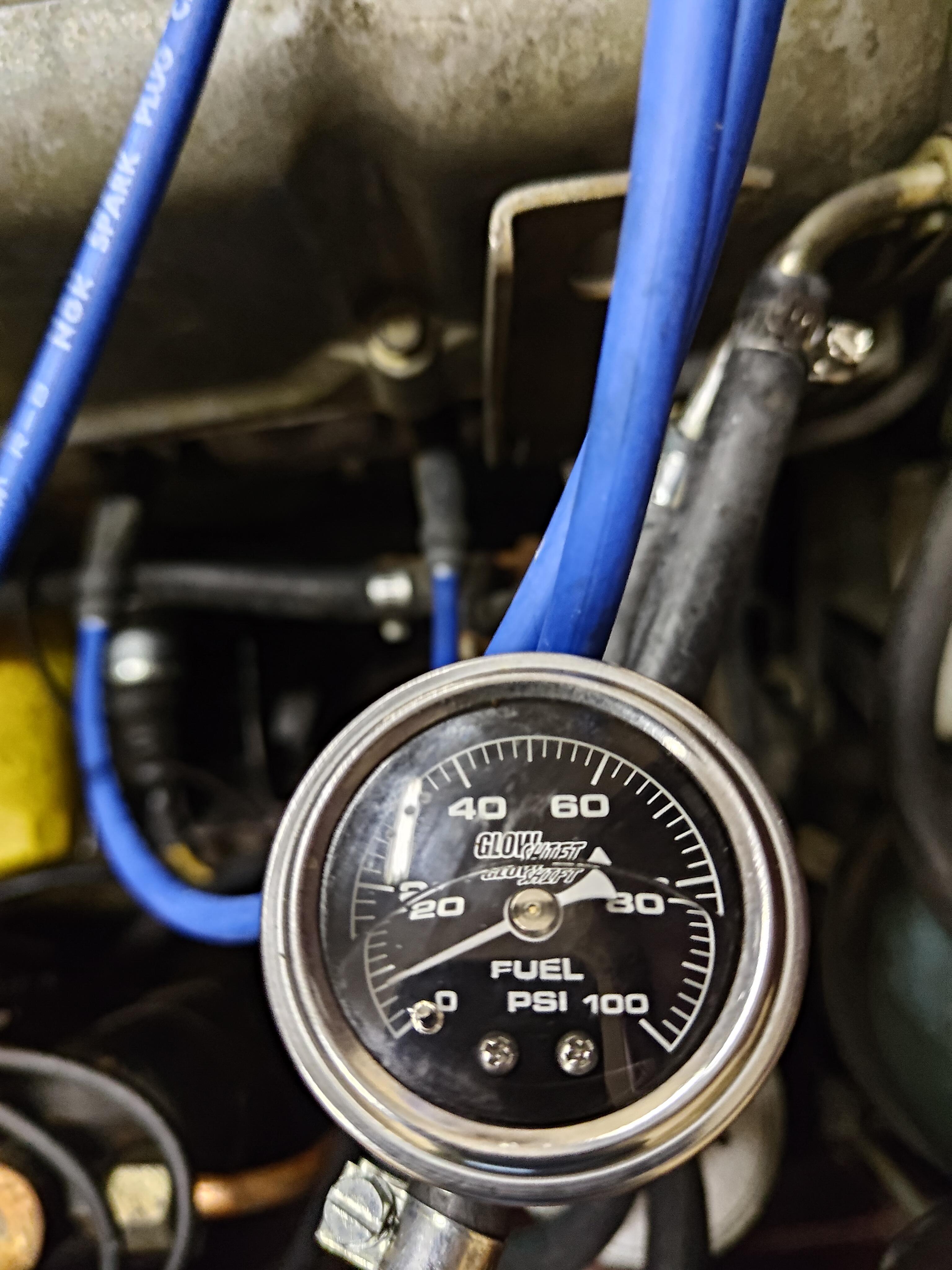

@Yarb @Zed Head, like you suggested, I took the feed line off the tank, and stuck it down into my two gallon gas can that was basically at capacity. Left the return line going to the factory tank.
Started the car up, fuel pressure was spot on, car sounded great. I didn't try to rev it, but it was a noticable difference from its shaking/misfiring, etc.
However, after about a minute or so, the pump had sucked up so much fuel from my two gallon gas can (and started puking gas out the feed line in the cars gas tank while it was at it) my fuel pressure again dropped into the teens and it died.
So I attempted the test later tonight, refilled my two gallon gas can, but this time I blocked off my feed line on the cars gas tank to keep fuel from spilling everywhere.
Same result, initial startup, fuel pressure was great, in the 30's, but as the two gallon can started to run out, the fuel pressure dropped and I shut the engine off by the time it had gotten to 8~ psi.
Fuel pressure at initial startup:

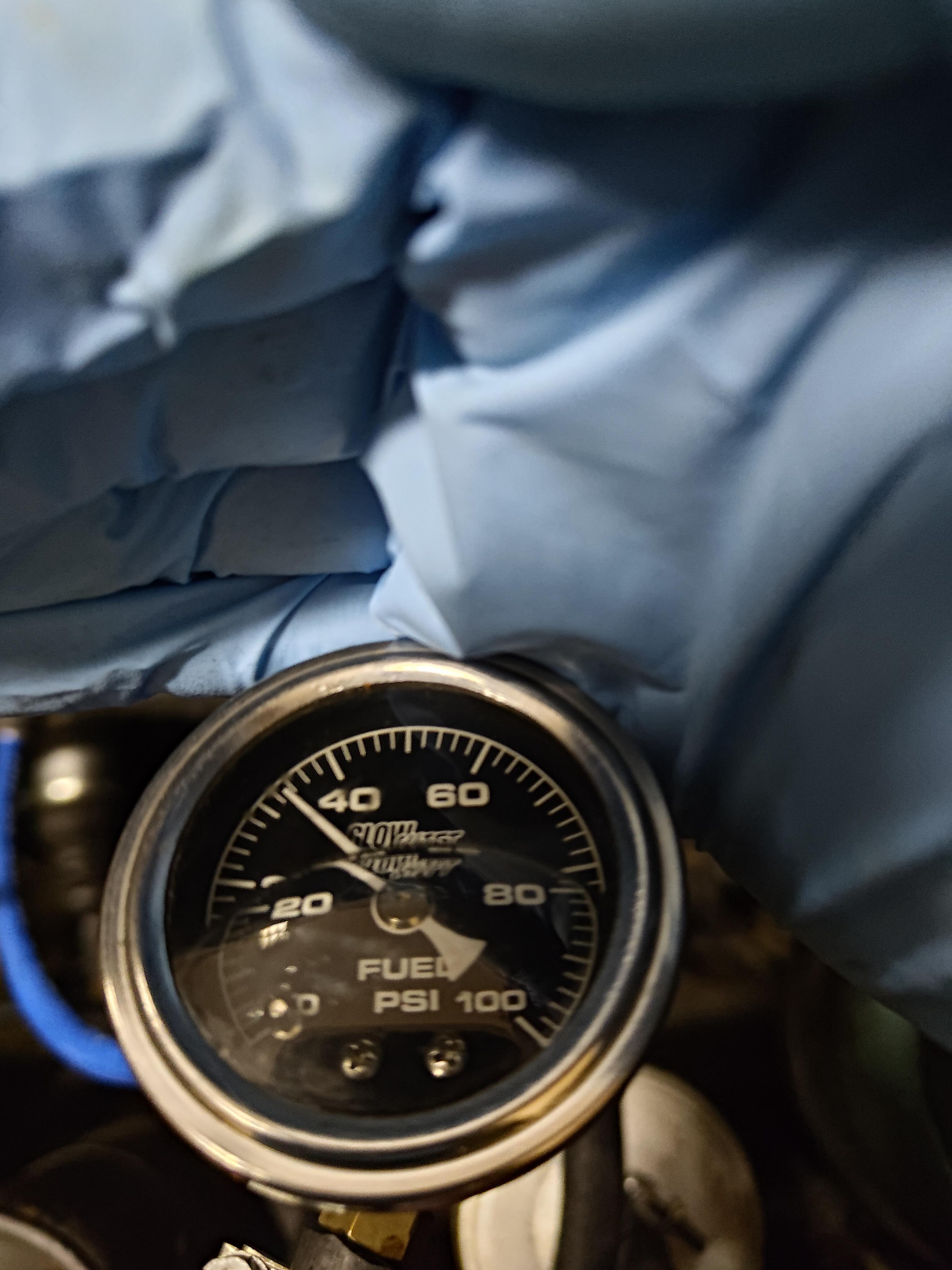

Fuel pressure after the car had been running for a minute or two (enough to suck the can low enough where the feed hose wasn't likely getting as much gas, causing the fuel pressure to drop (my best guess.)
Does this point to the tank being clogged, or the pump itself? I'm kind of at a loss.
