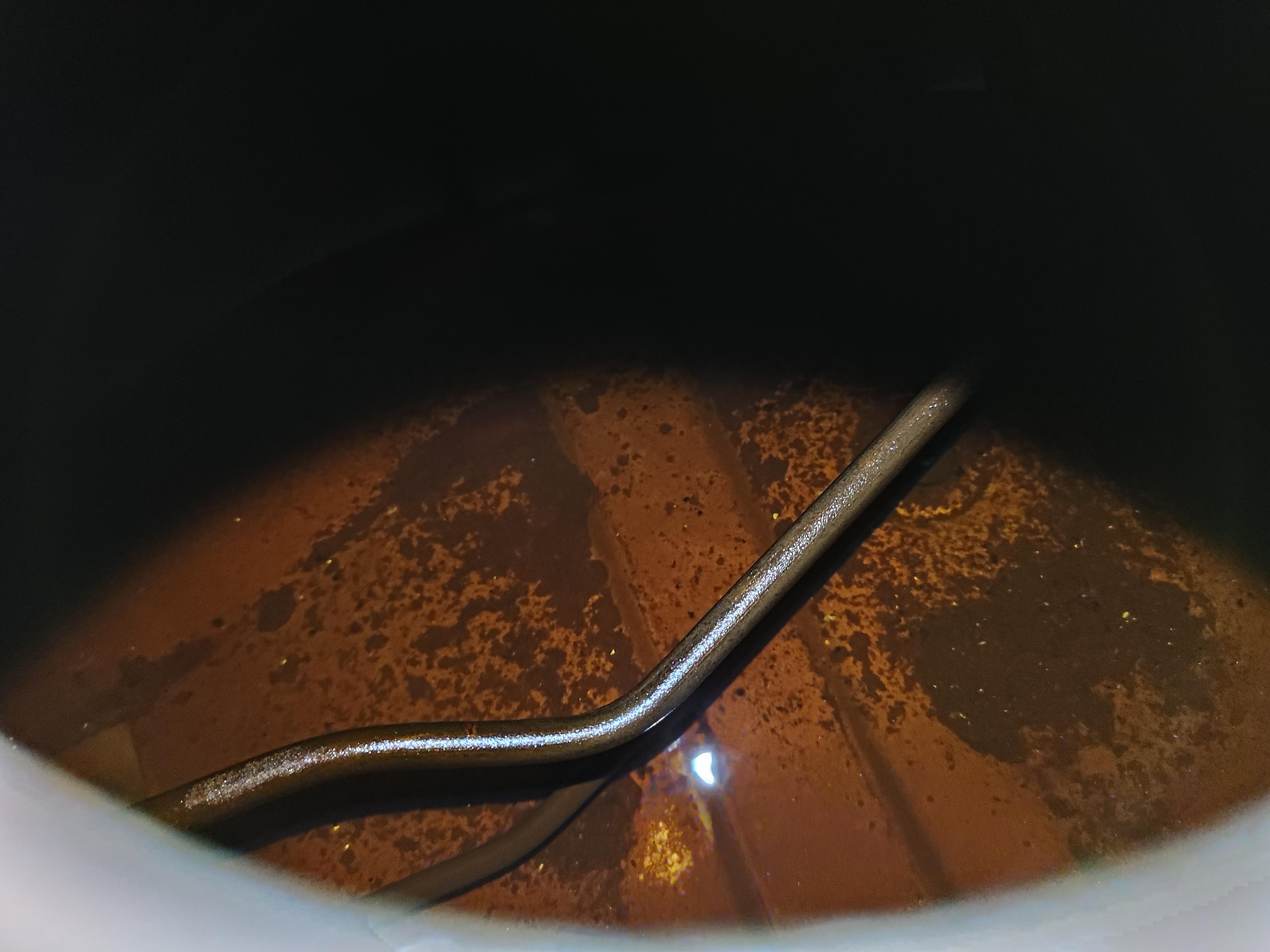

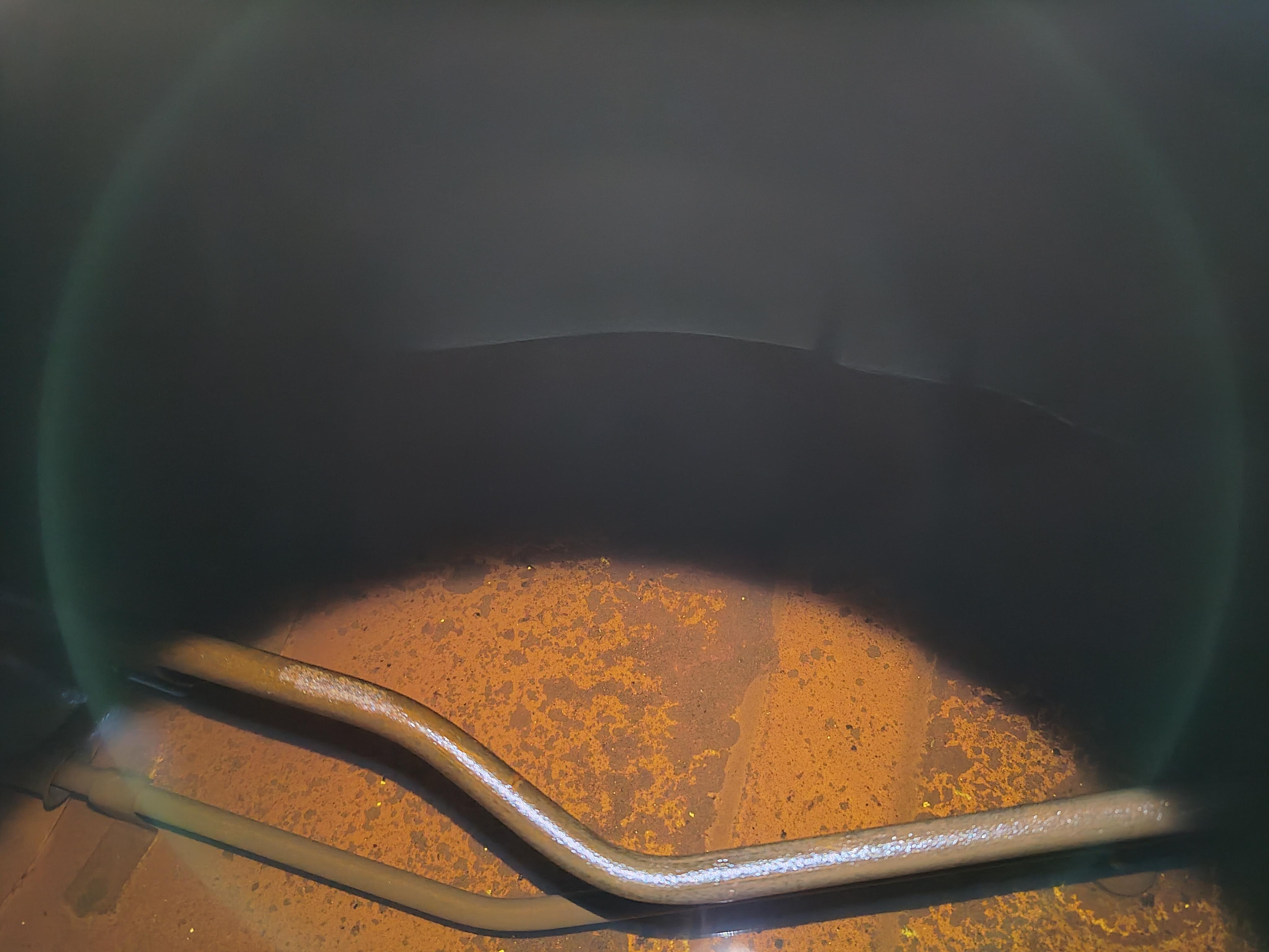

April 5, 20241 yr Author comment_663629 Well, it's been awhile, but the tank finally arrived. Unfortunately, S30World no longer has a warehouse in the states and sent it NLPost/USPS, so there was a bit of a tracking black out until it got to/cleared customs. They also just didn't use packing material on one side of the box, so the seam on the left side of the tank wore through the cardboard and got bent. I'm really hoping this tank doesn't leak because of how close the seam is to where it bent. They seem open to working with me though if there is a problem, so that's ideal. Hopefully that stays the same if I end up needing a replacement.  I managed to get the factory tank dropped and stopped there for the night. Somewhat difficult to see in there, but it looks like there's sediment on the bottom, but it doesn't look too bad. I'm hoping the pickup screen inside that cylinder that I can't see inside is where the problem lies, because when I used the gas can as a makeshift fuel tank, that seemed to solve the problem (and when I crimped off the return line, the fuel pressure stayed the same, so I'm hoping its a clogged tank being that the pump and filter and rubber lines are all new.)  I've got the tank mounting bolts soaking in brake parts cleaner, they were caked with dirt/grease, and I didn't want to damage the threads.  Does anyone happen to know if its safe to use fuel injection clamps on those two vent hoses on top of the tank?  The clamps that were on there weren't rusty at all (or the one on the filler neck either now that I think about it) but I did somewhat disfigure the head getting them out, so if I can replace them with EFI fuel clamps that I happen to have a surplus of, that would be ideal.  Edited April 5, 20241 yr by NocturnalEmber Link to comment https://www.classiczcars.com/forums/topic/68834-78-280z-finally-got-it-driving-high-idle-will-occasionally-die-but-restart-sound-like-it-has-a-misfire/?&page=5#findComment-663629 Share on other sites More sharing options...
