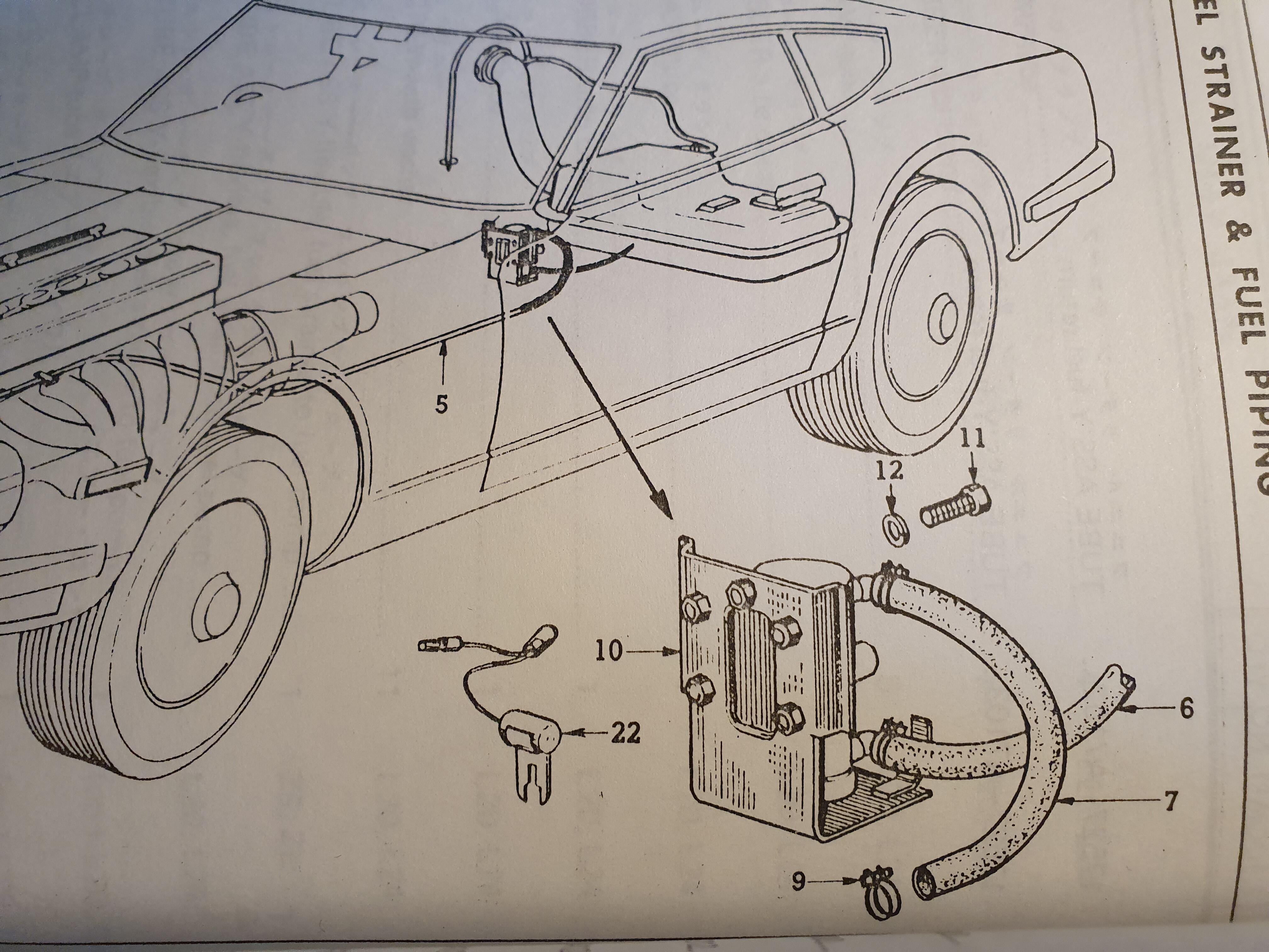

Closest thing I could find to a picture of where it goes. There are a pair of M6 threaded holes on the back side of the "frame" member, right side, just outside of where the rear control arm suspension hanging brackets mount.

Nissan already made a electronic fuel pump bracket for the S30;
https://www.carpartsmanual.com/datsun/Z-1969-1978/engine-240z-260z/fuel-piping#2
Or am I missing something..... is the price of these OEM ones so much, or so rare, repro's need made?

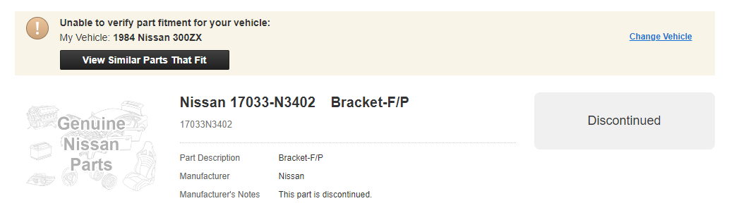

They are NLA in the states.
Are they available on your side of the pond?
That bracket was never fitted to European S30's, as it was added to house an electric fuel pump to try and overcome heat percolation (fuel engine bay) on the North American cars. I have one on mine, but I brought it Stateside secondhand. Even on a mid 1978 built model, the bolt holes are there on the chassis.

In fact the mount and the captive nuts in the crossmember to which it is affixed date back to the original design of the car, as they were used on the S20-powered Fairlady Z432 and Fairlady Z432-R models and on the factory aircon-equipped Fairlady Z-L model.
