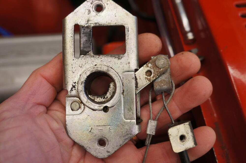

April 1, 20241 yr Popular Post comment_663497 On 4/1/2024 at 2:06 AM, Namerow said: Sound made by hood release cable when it finally snaps I know about that one, no fun at all, now I install a secondary release on every Z that comes through the shop. It hangs next to the exhaust pipe. Link to comment https://www.classiczcars.com/forums/topic/68880-dumb-but-genuine-question/#findComment-663497 Share on other sites More sharing options...
April 5, 20241 yr comment_663647 On 4/1/2024 at 10:09 AM, grannyknot said: I know about that one, no fun at all, now I install a secondary release on every Z that comes through the shop. It hangs next to the exhaust pipe. Would you mind showing exactly what you did for this? Link to comment https://www.classiczcars.com/forums/topic/68880-dumb-but-genuine-question/#findComment-663647 Share on other sites More sharing options...
April 5, 20241 yr comment_663668 Sure, it's just a length of thin aircraft cable looped around the pull lever that pops the hood open. Link to comment https://www.classiczcars.com/forums/topic/68880-dumb-but-genuine-question/#findComment-663668 Share on other sites More sharing options...
April 5, 20241 yr comment_663672 So I could do this and pull the cord from underneath, right? That's a great idea. I've broken one when I was younger and it was an ordeal from what I remember. Thanks Chris. Link to comment https://www.classiczcars.com/forums/topic/68880-dumb-but-genuine-question/#findComment-663672 Share on other sites More sharing options...
