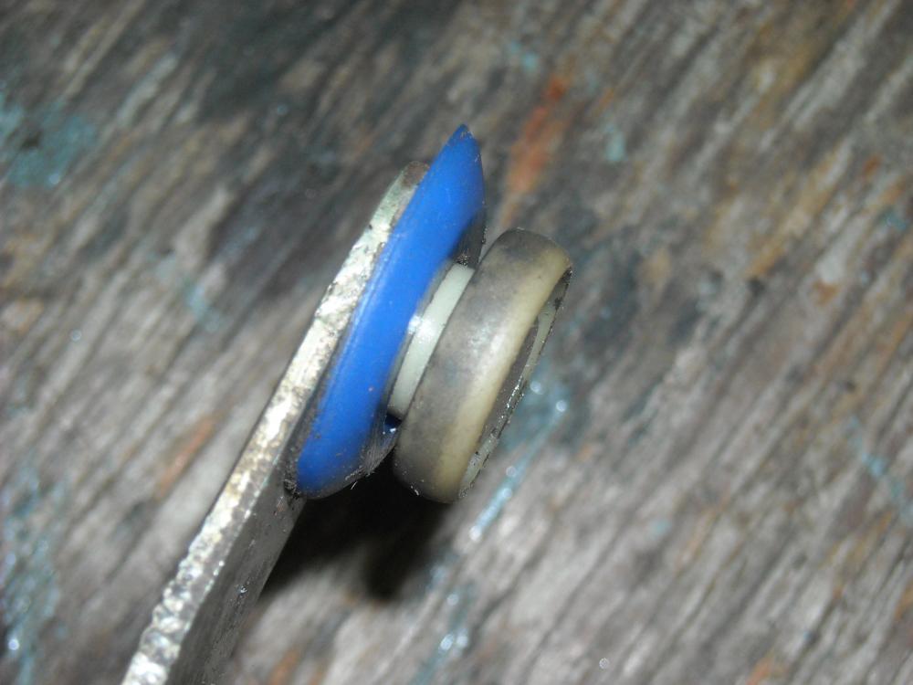

OK, I cleaned out all the old tracks, lubed everything with fresh lube, and I made a couple "space taker-up" washers to replace two original flexible plastic washers. One of the originals was in good shape so I left it alone, but here's what I did for the other two.
Two layers of shelf anti-slip foam and one layer of vinyl. I wasn't sure how the shelf foam would handle the abrasion of sliding against the track metal, so (like @Namerow) I used a layer of vinyl on that sliding surface. Here's some pics:
At this point, I got the door guts back in and it's a whole lot better than it was. the alignment of everything isn't perfect, but I can roll the window up and down without excessive force, and it's pretty good. Good enough for me to move to the next emergency at least.
