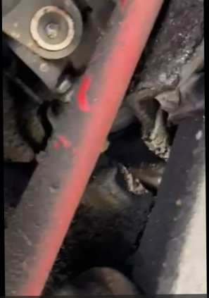

Posted April 7, 20241 yr comment_663765 So my driveshaft on my 260 makes a noise when at high speeds I take my foot off the accelerator. Basically if I am punching it and say OK - fast enough and stop the acceleration and then are coasting with no torque to the drive shaft it makes this same noise it is making in this video, just much more, louder etc. it sounds like the driveshaft is gonna come up through the floor- maybe that's an exaggeration but you get the idea. Is that amount of play in the driveshaft correct? I replaced the universals a while back , doesn't seems like they are part of the play , it seems like either the transmission or the Differental.IMG_4827.MOV Any thoughts? Edited April 7, 20241 yr by zdude1967 spelling Link to comment https://www.classiczcars.com/forums/topic/68892-driveshaft-noise/ Share on other sites More sharing options...
April 7, 20241 yr comment_663772 Your diff mount looks in pretty bad shape. But it usually causes a clunk when shifting, not a constant noise while coasting. The play in the driveshaft (propeller shaft) is normal for the diff, if the tranmsission is in neutral. Can't tell if the diff gears are stopping the movement or the transmission. Don't forget the other two drive shafts. Four more u-joints. Link to comment https://www.classiczcars.com/forums/topic/68892-driveshaft-noise/#findComment-663772 Share on other sites More sharing options...

April 8, 20241 yr comment_663784 The differential front mount where the forward support attaches to the frame. Check the u joints on the half shafts. Link to comment https://www.classiczcars.com/forums/topic/68892-driveshaft-noise/#findComment-663784 Share on other sites More sharing options...
