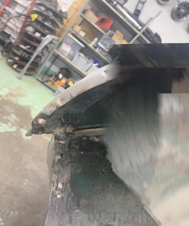

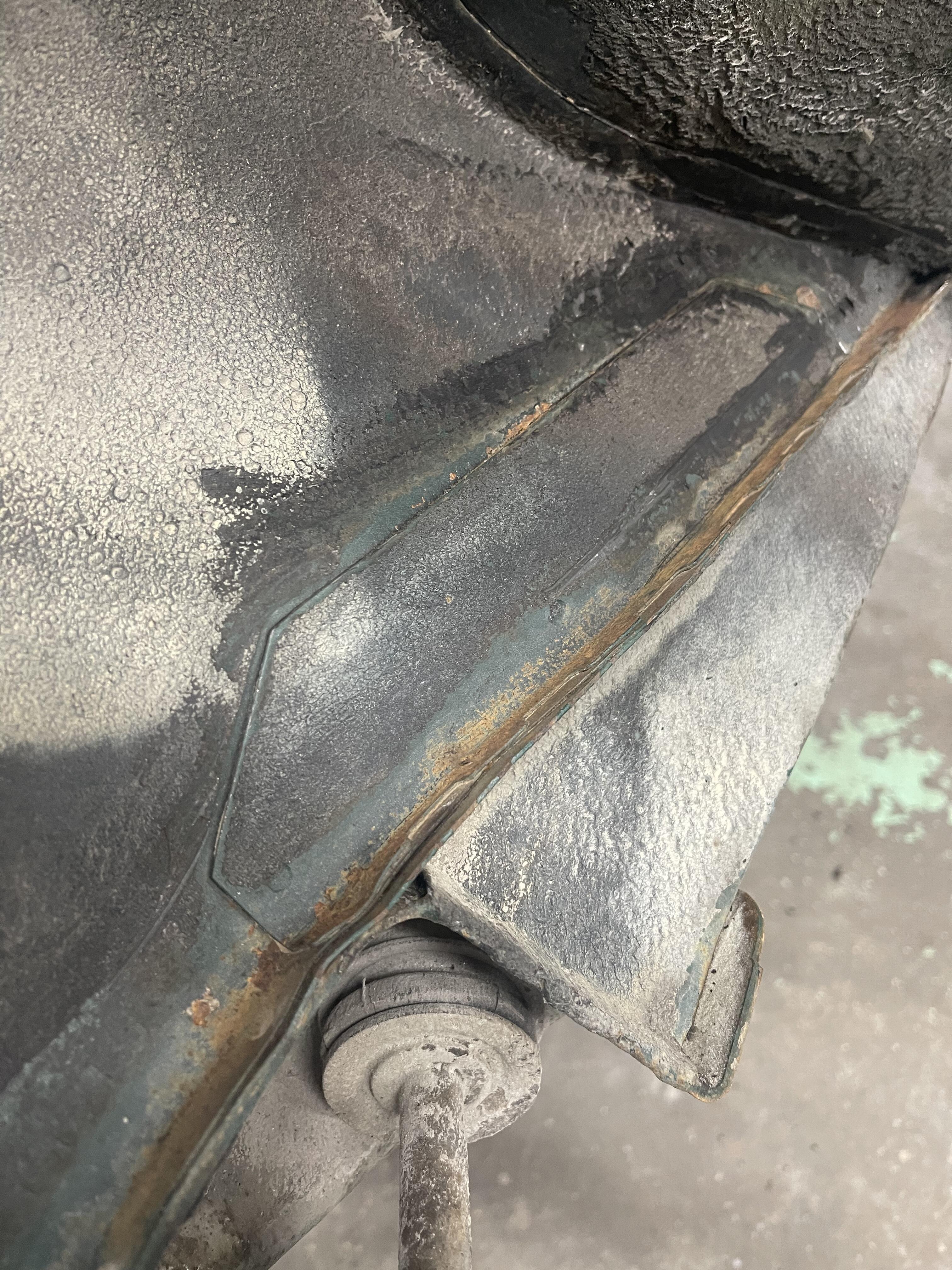

May 10, 2024May 10 Author comment_665295 Important prone to rust areas look very nice on drivers side, left hand side. Hammer and chiseled the thick coat of undercoating off these areas to confirm what lurked beneath the tar…… I know I have brought a few cars home with similar undercoating, that had possibly been applied to conceal the evil rust monster… Have mounted on rotessiere, waiting to have time to prime within a couple of days of blasting. Link to comment https://www.classiczcars.com/forums/topic/68900-finally-found-a-69-240z-51-time-to-finish-a-30-year-multiple-owner-restoration/?&page=14#findComment-665295 Share on other sites More sharing options...
May 10, 2024May 10 comment_665297 The front frame rails look really good! Be careful blasting, the metal is thin and easily oil canned Link to comment https://www.classiczcars.com/forums/topic/68900-finally-found-a-69-240z-51-time-to-finish-a-30-year-multiple-owner-restoration/?&page=14#findComment-665297 Share on other sites More sharing options...
May 10, 2024May 10 Author comment_665298 45 minutes ago, Patcon said: The front frame rails look really good! Be careful blasting, the metal is thin and easily oil canned Not familiar with "Oil canned"? Link to comment https://www.classiczcars.com/forums/topic/68900-finally-found-a-69-240z-51-time-to-finish-a-30-year-multiple-owner-restoration/?&page=14#findComment-665298 Share on other sites More sharing options...
May 10, 2024May 10 comment_665300 If the metal gets too hot or overworked, it expands and becomes wavy. Basically ruined Link to comment https://www.classiczcars.com/forums/topic/68900-finally-found-a-69-240z-51-time-to-finish-a-30-year-multiple-owner-restoration/?&page=14#findComment-665300 Share on other sites More sharing options...
May 10, 2024May 10 Author comment_665301 48 minutes ago, Patcon said: If the metal gets too hot or overworked, it expands and becomes wavy. Basically ruined Although I've only used the dustless blaster on a few cars, really haven't had that problem yet. the water is advertised to cut down on warpage due to heat.....I guess with aggressive media, metal could be moved around somewhat with a somewhat similar result.... Link to comment https://www.classiczcars.com/forums/topic/68900-finally-found-a-69-240z-51-time-to-finish-a-30-year-multiple-owner-restoration/?&page=14#findComment-665301 Share on other sites More sharing options...
May 10, 2024May 10 comment_665303 20 minutes ago, dspillman said: Although I've only used the dustless blaster on a few cars, really haven't had that problem yet. the water is advertised to cut down on warpage due to heat.....I guess with aggressive media, metal could be moved around somewhat with a somewhat similar result.... If you've done other cars with sheet metal this thin you should be fine. If you been doing American vintage cars, they are a lot thicker Link to comment https://www.classiczcars.com/forums/topic/68900-finally-found-a-69-240z-51-time-to-finish-a-30-year-multiple-owner-restoration/?&page=14#findComment-665303 Share on other sites More sharing options...
