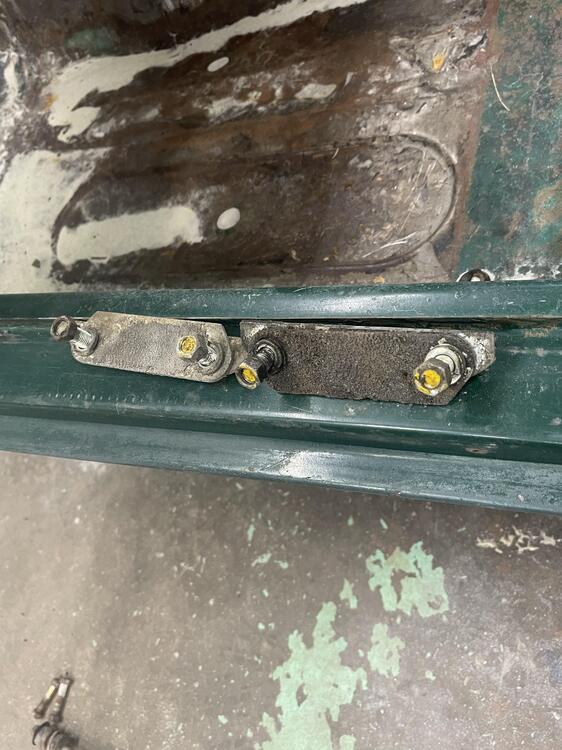

May 11, 2024May 11 comment_665330 23 hours ago, dspillman said: It always makes me smile when taking off suspension peices that show the yellow Q/C brush marks….. I don't recognize these two parts. What are they? Link to comment https://www.classiczcars.com/forums/topic/68900-finally-found-a-69-240z-51-time-to-finish-a-30-year-multiple-owner-restoration/?&page=15#findComment-665330 Share on other sites More sharing options...
May 11, 2024May 11 Author comment_665333 1 hour ago, Namerow said: I don't recognize these two parts. What are they? Reinforcements/washers for the front cross member attachment to frame rail Link to comment https://www.classiczcars.com/forums/topic/68900-finally-found-a-69-240z-51-time-to-finish-a-30-year-multiple-owner-restoration/?&page=15#findComment-665333 Share on other sites More sharing options...
