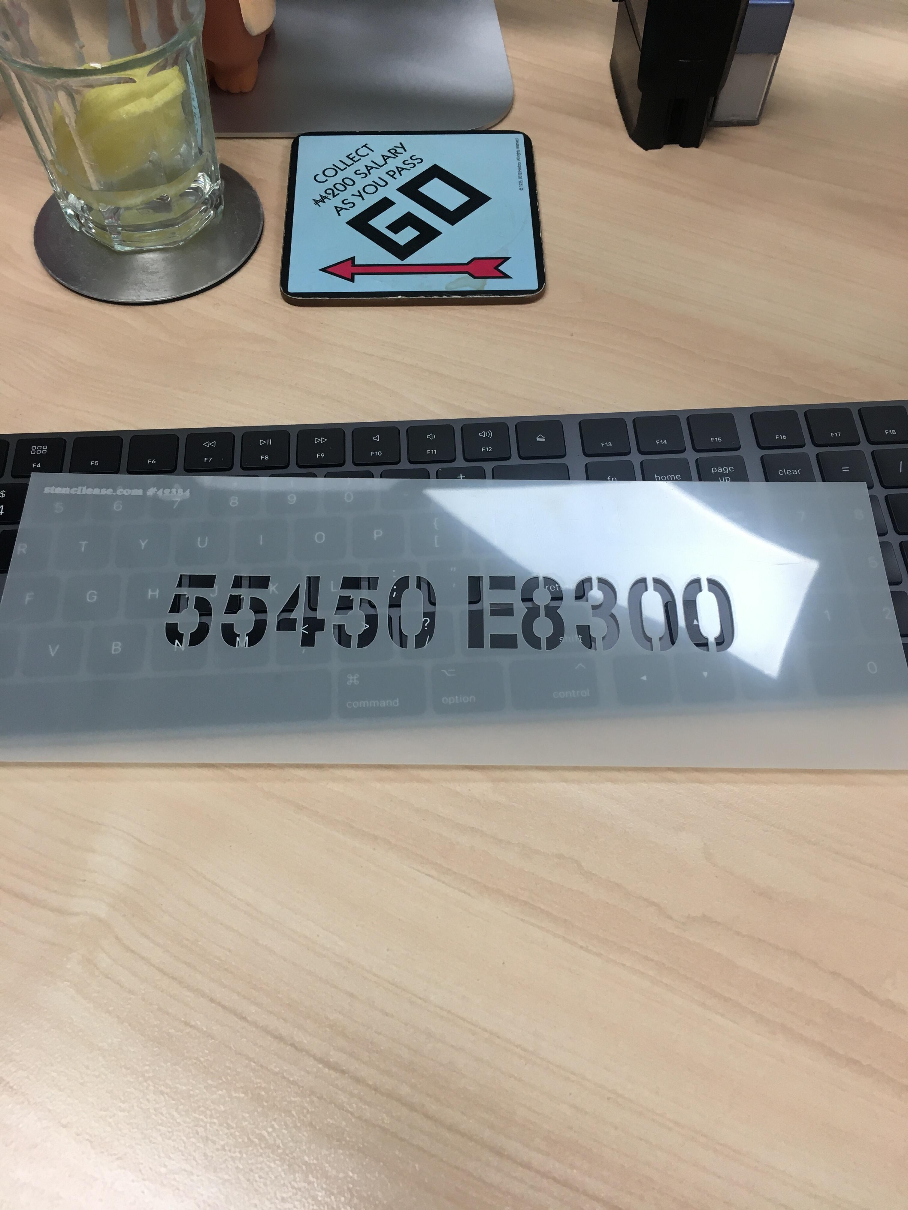

May 22, 2024May 22 comment_665751 On 5/12/2024 at 7:58 AM, dspillman said: Careful removal of undercoating and grease revealed a partial number on most mustache …. I’m thinking they were all the same with 240s… Too aggressive I was while “gently scrubbing” 1 A friend of mine had a stencil made to reproduce that part no. on the rear moustache bar. I don't recall if HLS30 vs HS30's used a different part no. though. Here are some photos from a clean 73 model (HS30) we took apart a couple of years ago. https://photos.app.goo.gl/szJd62o9dARqLpWTA Edited May 22, 2024May 22 by Gav240z Link to comment https://www.classiczcars.com/forums/topic/68900-finally-found-a-69-240z-51-time-to-finish-a-30-year-multiple-owner-restoration/?&page=16#findComment-665751 Share on other sites More sharing options...
May 22, 2024May 22 Author comment_665757 3 hours ago, Gav240z said: A friend of mine had a stencil made to reproduce that part no. on the rear moustache bar. I don't recall if HLS30 vs HS30's used a different part no. though. Here are some photos from a clean 73 model (HS30) we took apart a couple of years ago. https://photos.app.goo.gl/szJd62o9dARqLpWTA That would work perfect! Link to comment https://www.classiczcars.com/forums/topic/68900-finally-found-a-69-240z-51-time-to-finish-a-30-year-multiple-owner-restoration/?&page=16#findComment-665757 Share on other sites More sharing options...
