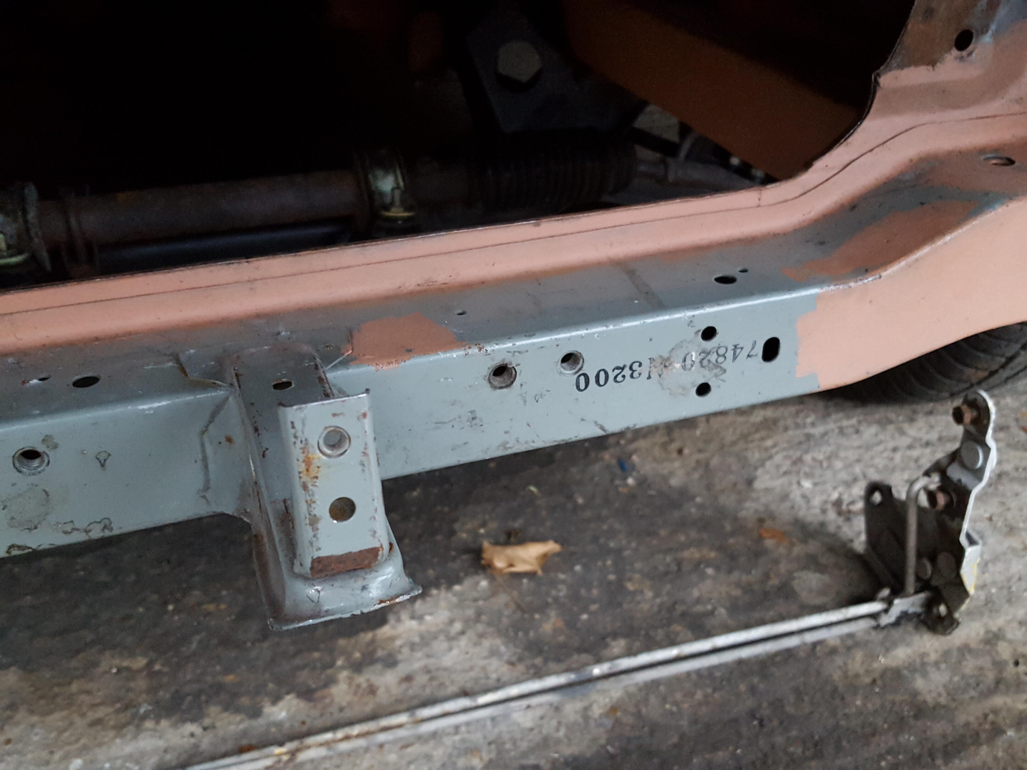

May 29, 2024May 29 comment_665945 58 minutes ago, HS30-H said: The mount for the 432 airbox is on the wrong side (factory mistake?), but the holes for the H-H 'Traction Hook' are correct. N3200 ink stamp part number? I think it was a generic one-size-fits-all interim service part just before the version with the aircon condenser-related horn mounts. I used one for my white H-H and I had to cut the 432 airbox mount off (although it was on the correct side). Worked OK. I think you'd struggle to find an NOS E4200 or E4201 version. Hi Alan, the wrong side Z432 mount is what we have been waiting for! You posted a picture for a several years ago, a ‘Fairlady 260Z-E’. It has a mirror image Z432 air filter box next to the left side of the head light. I am so excited about seeing this front center rail, this proves Nissan was about to sell Fairlady 260Z-E not just making a prototype but preparing for full production for the coming new model for 1974. And also I have seen a Z432 wrong side air box on Yahoo Japan auction some years ago. I just didn’t get it what it is. But yes it existed! Kats Link to comment https://www.classiczcars.com/forums/topic/68900-finally-found-a-69-240z-51-time-to-finish-a-30-year-multiple-owner-restoration/?&page=18#findComment-665945 Share on other sites More sharing options...

May 29, 2024May 29 comment_665956 8 hours ago, kats said: Hi Alan, the wrong side Z432 mount is what we have been waiting for! You posted a picture for a several years ago, a ‘Fairlady 260Z-E’. It has a mirror image Z432 air filter box next to the left side of the head light. I am so excited about seeing this front center rail, this proves Nissan was about to sell Fairlady 260Z-E not just making a prototype but preparing for full production for the coming new model for 1974. And also I have seen a Z432 wrong side air box on Yahoo Japan auction some years ago. I just didn’t get it what it is. But yes it existed! Kats Well your memory is obviously much better than mine Kats, as I had completely forgotten about that. So the N3200 was part of the aborted Fairlady 260Z-E project... ...and the airbox mount is correct. Fascinating to think that some of the specific parts made it into Nissan's spare parts system. As mentioned, my white 240ZG project car needed a radiator support crossmember (due to old damage) and the only panel I could find at the time was the same 74820-N3200 as David has. I just removed the unneeded additions. Think it worked OK. David, can you do something like this for your N3200? Link to comment https://www.classiczcars.com/forums/topic/68900-finally-found-a-69-240z-51-time-to-finish-a-30-year-multiple-owner-restoration/?&page=18#findComment-665956 Share on other sites More sharing options...

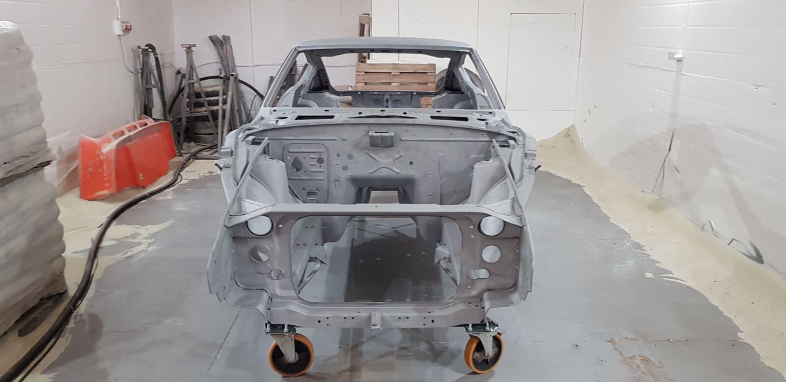

May 29, 2024May 29 Author comment_665958 3 hours ago, HS30-H said: “ Well your memory is obviously much better than mine Kats. So the N3200 was part of the aborted Fairlady 260Z-E project... I could find at the time was the same 74820-N3200 as David has. I just removed the unneeded additions. Think it worked OK. David, can you do something like this for your N3200? ” It would be possible,but the “tow bracket holes” would bother me….Oct 69 car with obvious Oct 71 peices, but in all likelihood will have many other items/details not 100% dated correct….I maybe over thinking this……. Correct seatbelts, tail lights, seat covers can be easily “fixed” with correct over time…. That front crossmember isn’t as easily swapped out in the future. But that all being said…..I’d bet less then 5% of z guys in the “states” would know what purpose those two holes were used for from 10/71-10/72 Link to comment https://www.classiczcars.com/forums/topic/68900-finally-found-a-69-240z-51-time-to-finish-a-30-year-multiple-owner-restoration/?&page=18#findComment-665958 Share on other sites More sharing options...
May 29, 2024May 29 Author comment_665959 It would be possible,but the “tow bracket holes” would bother me….Oct 69 car with obvious Oct 71 peices, but in all likelihood will have many other items/details not 100% dated correct….I maybe over thinking this……. Correct seatbelts, tail lights, seat covers can be easily “fixed” with correct over time…. That front crossmember isn’t as easily swapped out in the future. But that all being said…..I’d bet less then 5% of z guys in the “states” would know what purpose those two holes were used for from 10/71-10/72 Link to comment https://www.classiczcars.com/forums/topic/68900-finally-found-a-69-240z-51-time-to-finish-a-30-year-multiple-owner-restoration/?&page=18#findComment-665959 Share on other sites More sharing options...
May 29, 2024May 29 comment_665960 Holes can be welded up... Link to comment https://www.classiczcars.com/forums/topic/68900-finally-found-a-69-240z-51-time-to-finish-a-30-year-multiple-owner-restoration/?&page=18#findComment-665960 Share on other sites More sharing options...
May 29, 2024May 29 comment_665961 12 minutes ago, Patcon said: Holes can be welded up... Indeed. And after dressing and painting nobody would know they were ever there. Link to comment https://www.classiczcars.com/forums/topic/68900-finally-found-a-69-240z-51-time-to-finish-a-30-year-multiple-owner-restoration/?&page=18#findComment-665961 Share on other sites More sharing options...
May 29, 2024May 29 Author comment_665965 If 3496 didn’t have these blame camber plates, I could put the whole front clip on… Link to comment https://www.classiczcars.com/forums/topic/68900-finally-found-a-69-240z-51-time-to-finish-a-30-year-multiple-owner-restoration/?&page=18#findComment-665965 Share on other sites More sharing options...
May 29, 2024May 29 comment_665967 It would be pretty easy to make those shock towers stock again. Provided you know how to MIG. Just make sure you get the front end on level and square. A frame rack would be best for that Link to comment https://www.classiczcars.com/forums/topic/68900-finally-found-a-69-240z-51-time-to-finish-a-30-year-multiple-owner-restoration/?&page=18#findComment-665967 Share on other sites More sharing options...
