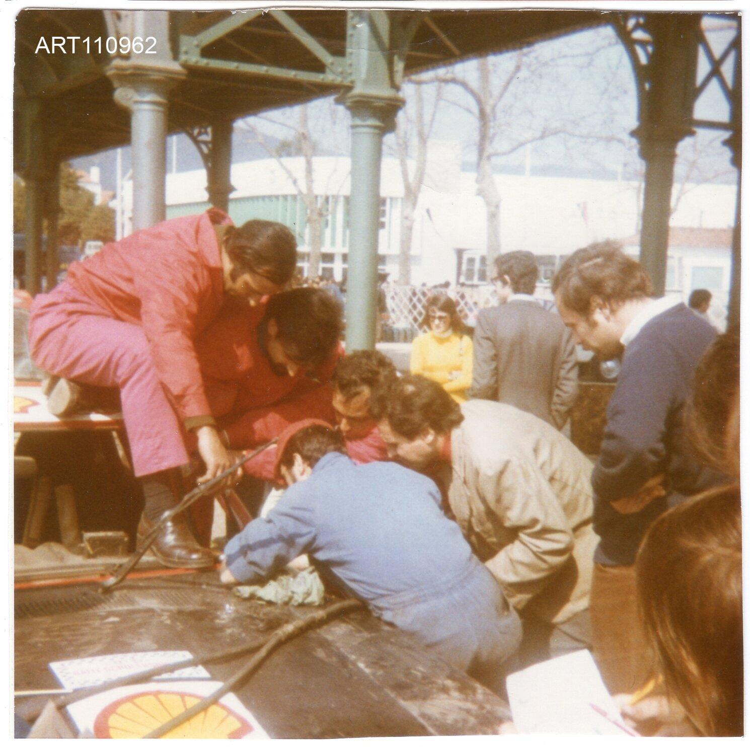

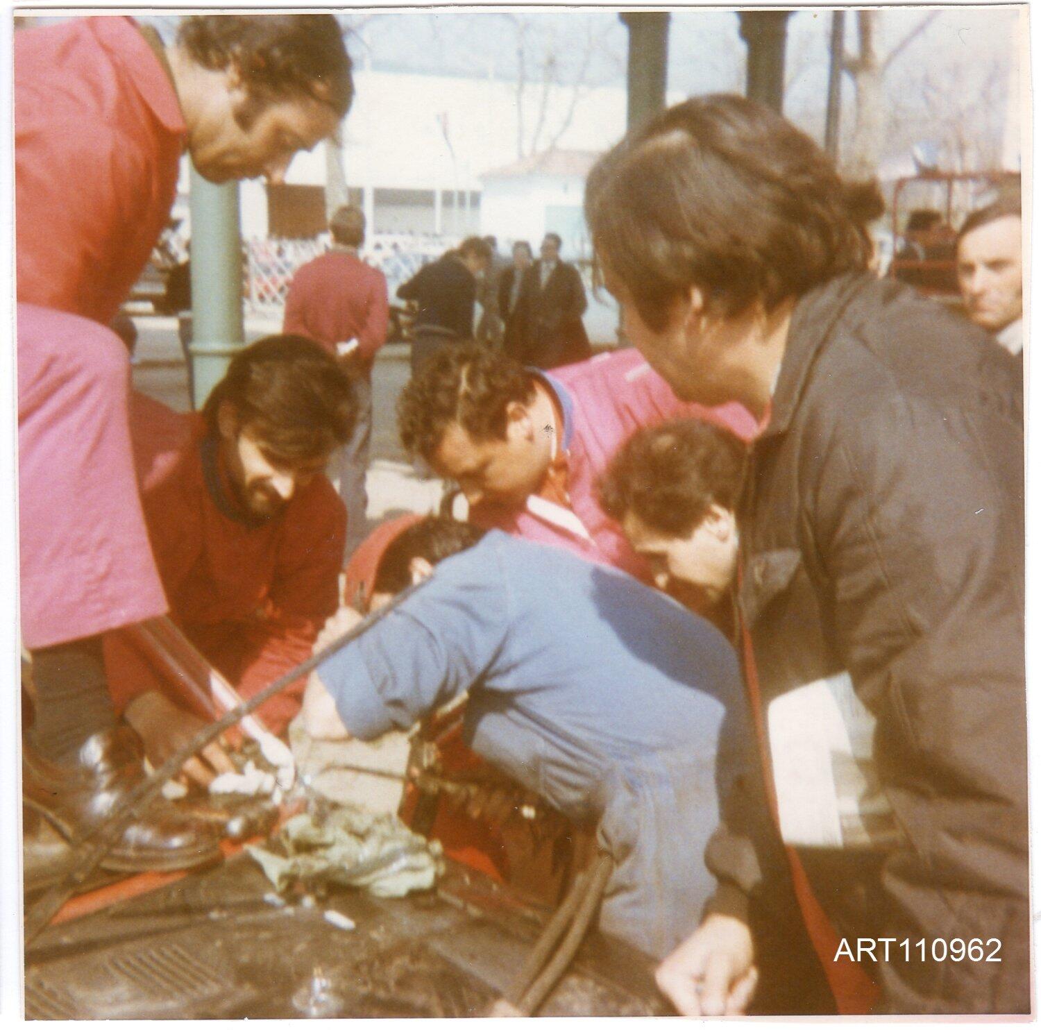

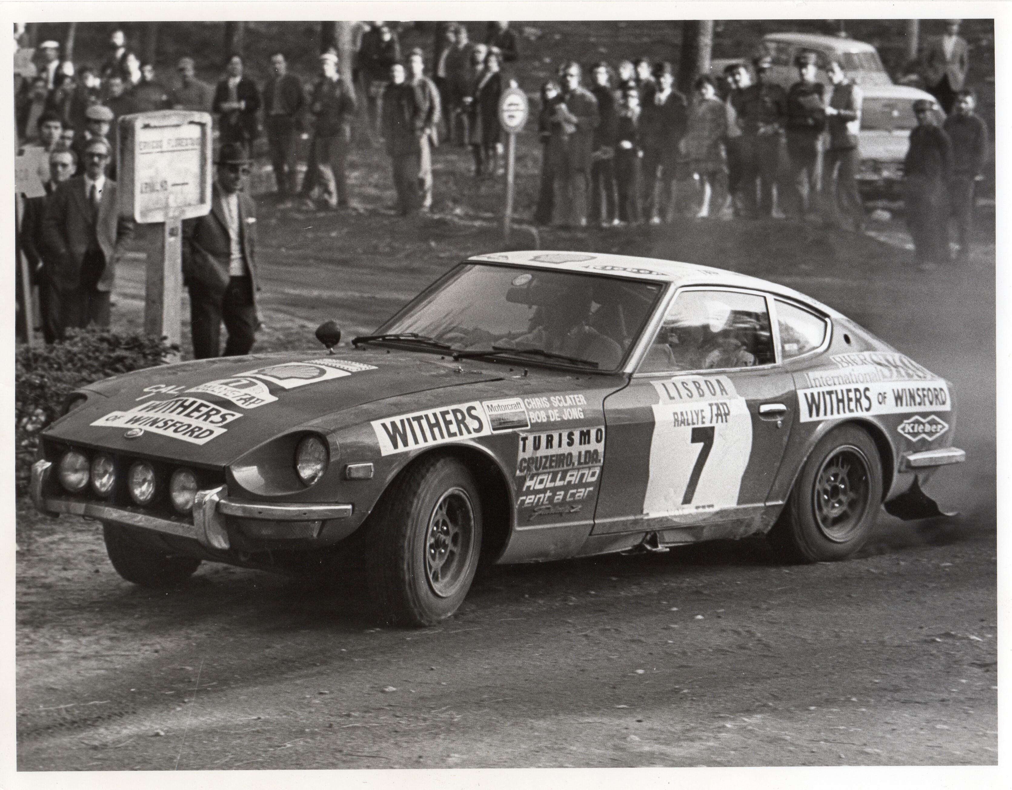

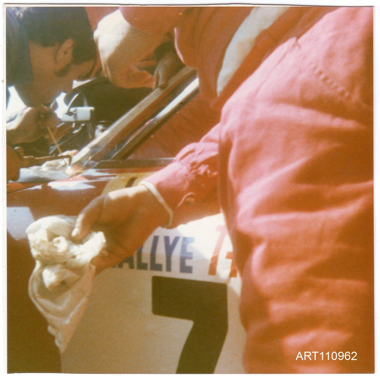

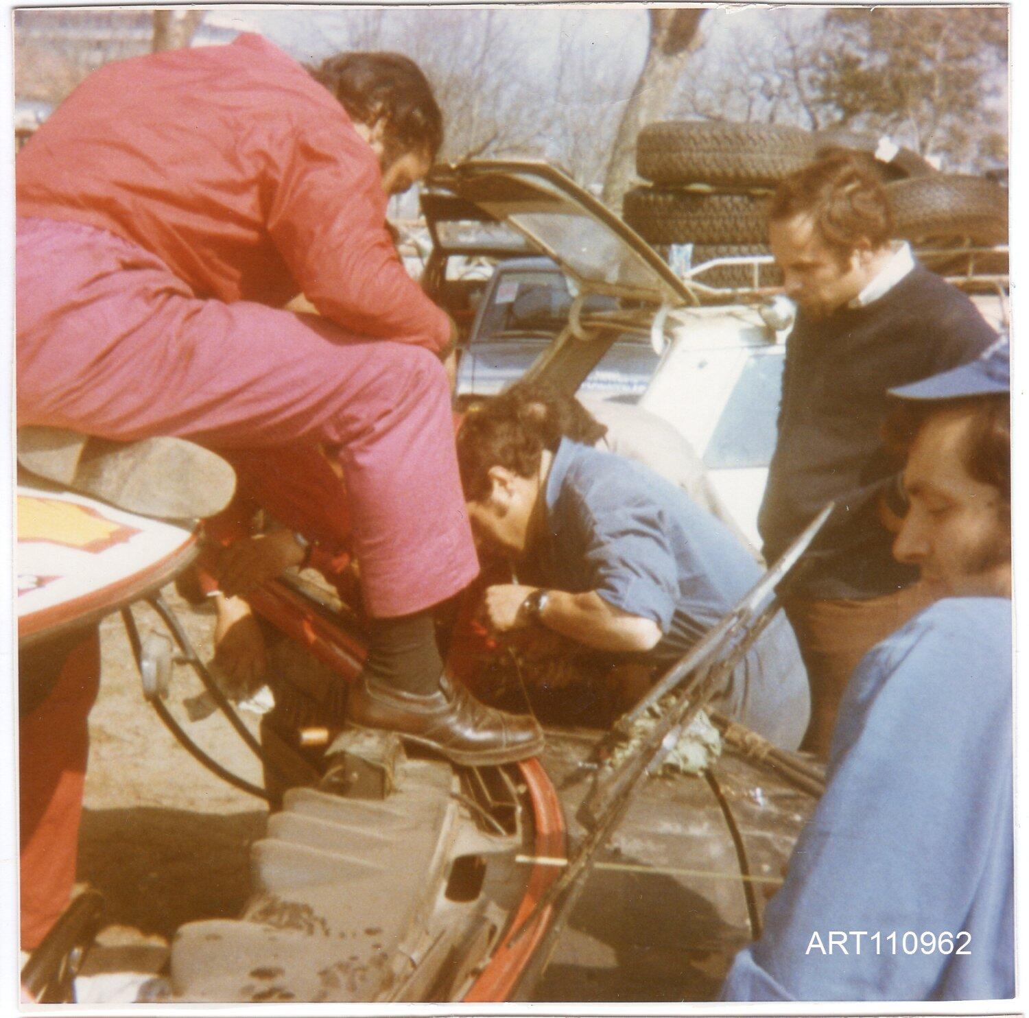

April 24, 2024Apr 24 comment_664431 13 hours ago, Mark Maras said: The words were from Matsuo-San and we were specifically discussing the C-pillar joint. We did discuss body flex and twist. I don't recall him saying that it did pop out during testing but considering what these cars were going to go through during rallies, a large semi-rigid C-pillar joint made more sense than a stiff or semi-rigid A-pillar. To digress sightly from the thread's main subject (sorry OP), here's an example of what the cars were going through on rallies: English team Withers Of Winsford entered an ex-Works Fairlady Z-emblemed Datsun 240Z rally car - wearing the personalised UK license plate 'CAL 1' of company owner Mr Cal Withers - in the 1973 TAP Rally of Portugal, driven by hotshoe Englishman Chris Sclater and navigated by Dutch specialist Bob De Jong. The service crew were forced to repair the screen pillar joints - which were parting company - mid-event, assisted by the staff of Portuguese Datsun distributors Entreposto. They took the screen out and either brazed or gas-welded the pillars back together... At that point the car had already taken part in the 1972 Acropolis Rally in Greece and the 1972 RAC Rally in the UK. Perhaps not surprising that the bodyshell was starting to get a little bit 'baggy'... Link to comment https://www.classiczcars.com/forums/topic/68900-finally-found-a-69-240z-51-time-to-finish-a-30-year-multiple-owner-restoration/?&page=7#findComment-664431 Share on other sites More sharing options...
April 24, 2024Apr 24 comment_664433 6 hours ago, HS30-H said: In my experience, the joints were usually spotwelded. However, I have seen a couple of bodies that had brazed joints (perhaps even spotwelded AND brazed). Got it. So it sounds like choices to fill that large visible joint after welding was either lead or plastic filler? And they chose the lead. Link to comment https://www.classiczcars.com/forums/topic/68900-finally-found-a-69-240z-51-time-to-finish-a-30-year-multiple-owner-restoration/?&page=7#findComment-664433 Share on other sites More sharing options...
April 24, 2024Apr 24 Author comment_664442 7 hours ago, HS30-H said: To digress sightly from the thread's main subject (sorry OP), here's an example of what the cars were going through on rallies:The service crew were forced to repair the screen pillar joints - which were parting company - mid-event, assisted by the staff of Portuguese Datsun distributors Entreposto. They took the screen out and either brazed or gas-welded the pillars back together... No apologies needed. Those are incredible pictures showing the ingenuity needed at the track to continue…… appears that roof had to be pressed back down to the body. Those 2 C pillow and window joints were truly put thru hell, with the twisting forces thrown at the car during roads/ditches and uneven surfaces in general. Link to comment https://www.classiczcars.com/forums/topic/68900-finally-found-a-69-240z-51-time-to-finish-a-30-year-multiple-owner-restoration/?&page=7#findComment-664442 Share on other sites More sharing options...

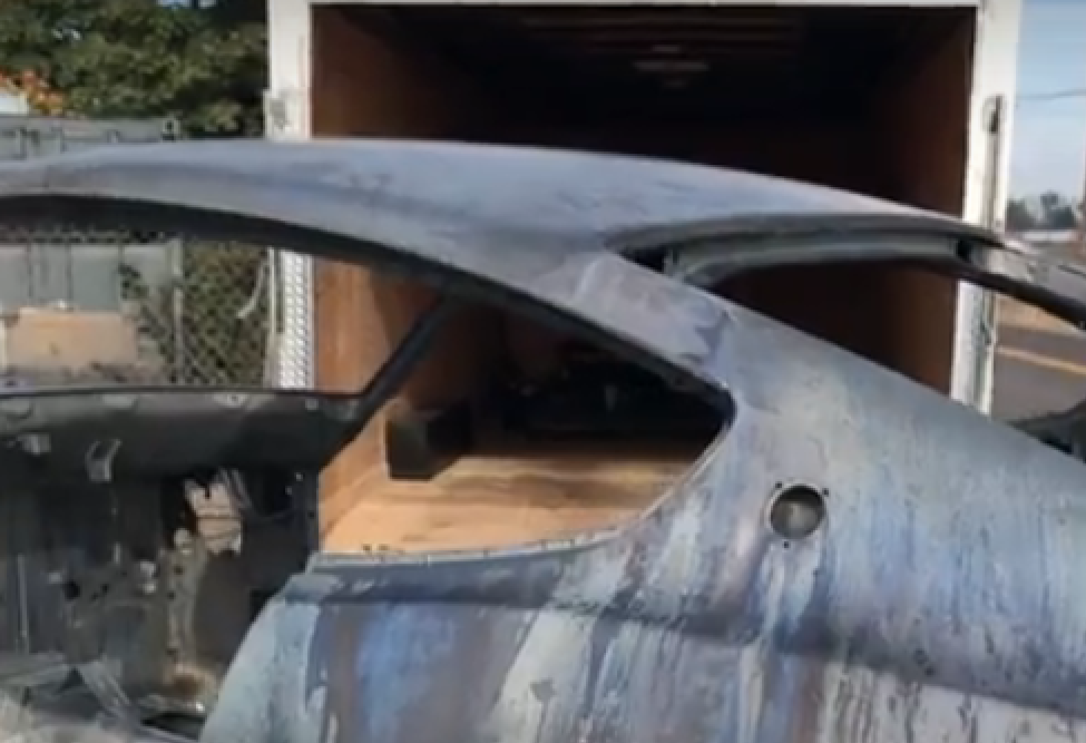

April 25, 2024Apr 25 comment_664445 Does anyone have a picture of how the roof and rear quarter panels come together when the latter is replaced. Failing that, maybe just a detail shot of the relevant area of the rear quarter panel. There has to be a weld somewhere! Link to comment https://www.classiczcars.com/forums/topic/68900-finally-found-a-69-240z-51-time-to-finish-a-30-year-multiple-owner-restoration/?&page=7#findComment-664445 Share on other sites More sharing options...
