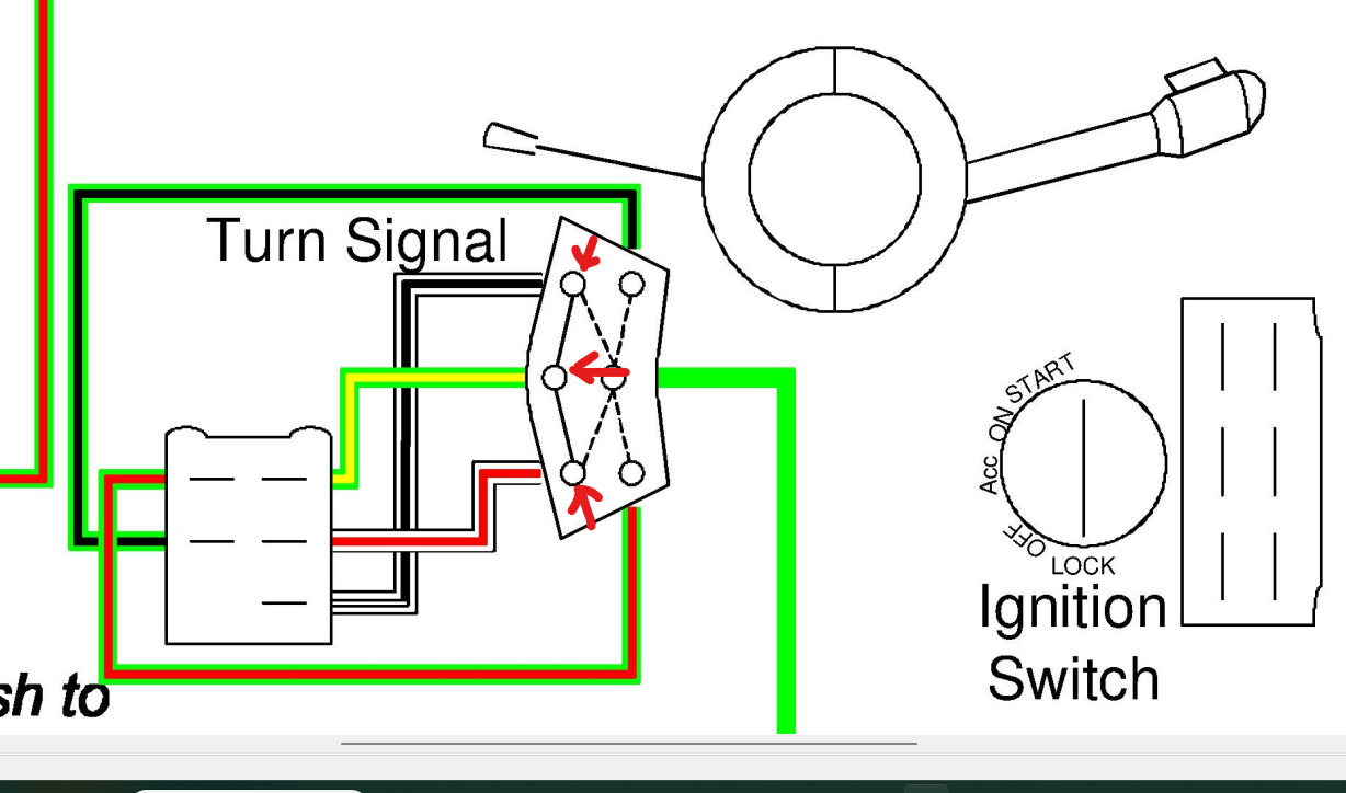

I followed the directions from the first link I posted above and verified that I have 12 volts at the Green/yellow wire that goes from the hazard switch to the connector for the turn signal switch. Picture below. I also verified that the voltage goes to zero when the brake pedal switch is pressed, telling me that the brake switch is working.
Again, according to that first link above by 72SLOZ, that should indicate that my problem is something downstream of the hazard switch.
When I plug in the turn signal switch, I don’t get any voltage from the green/yellow wire to the white/black or white/red wire. This might seem to indicate a problem with the turn signal switch?
BUUUUT, I thought to myself, I’ll bypass the turn signal switch and just insert a jumper wire into the connector shown below and see if I get any lights, still nothing!
I have my multimeter in hand. Any idea where to look next?
If the switch is disconnected from the brake pedal while the turn signal switch is in the neutral position, you should see 12VDC to ground at the points indicated below.
If you don't, that means the switch was not rebuilt properly.
Under those same conditions, you should have 12VDC to ground at the green wire in the picture above.
Please confirm that.

If you had a good ground, you should have seen battery voltage to ground at the green/yellow wire.
Connections are all solid. No wires being pushed out. It’s like when I plug in the connector the GY wire just stops supplying 12V.
So now it's time to look upstream. I suspect you have some corrosion, poor connection, or a loose connection somewhere in the circuit. That improper current path is a choke point, and you see the voltage drop to nothing. You could try some things like jumpering out the brake switch and see if you have brake lights.
Also measure the voltage to ground at the fuse for the brake circuit before and after connecting the turn signal switch.
When I connect a jumper wire connecting only the two green/yellow wires together, I get 12 volts at the proper terminals on the turn signal stalk (but still no brake lights). See explaination video here…

First, look for corrosion. Where? Look at the PDF I attached. I indicated 4 areas to focus on, numbered in red.
Inspection Points.pdf
This is a visual inspection only. You're meter isn't designed to ferret out this kind of problem. For the fuse box, examine the contact points of the fuse holder, and you may need to remove the fuse box to examine the back side of it. Just be sure to pull the negative terminal off the battery before you attempt to do that.
Sometimes disconnecting and reconnecting connectors cleans off enough corrosion that the circuit will work again. You may also want to try to jumper out the brake switch to see if that is the culprit. You can probably do that with a couple of bullet connectors and a short piece of wire.
