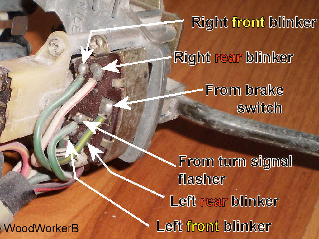

I found a pic on the web. Should i consider prying the tabs to get inside the contact or should i perform any external tests before getting into this?

 Find a ground. Either a wire or the switch body. The black ohm meter probe goes to the ground, The red probe goes to the left rear blinker soldered connection as shown in post #5, and then operate the switch. Repeat the test with the red probe to the left rear blinker spade connector in the plug.
