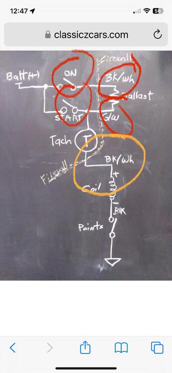

May 7, 2024May 7 comment_665084 Link to comment https://www.classiczcars.com/forums/topic/68934-73-240-no-spark/?&page=11#findComment-665084 Share on other sites More sharing options...
May 7, 2024May 7 Author comment_665085 Hey yarn. I red circled wires that work fine and gave 12v on start/run. The yellow circle gets no power. Not sure what it supposed to do power wise. It goes in tach and comes out. Does it get power at any point? Link to comment https://www.classiczcars.com/forums/topic/68934-73-240-no-spark/?&page=11#findComment-665085 Share on other sites More sharing options...
