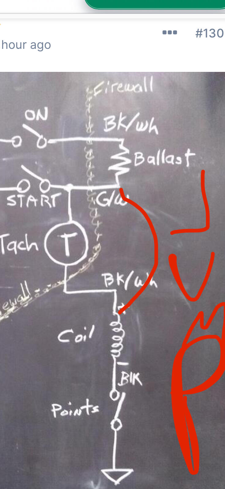

May 7, 2024May 7 Author comment_665093 Just need to know as many possibilities as my car is not at my house. It’s at my pals garage. I only get there a few times a week. If I wanted to jump over and skip the tach would this work ? From ballast to coil. ? Link to comment https://www.classiczcars.com/forums/topic/68934-73-240-no-spark/?&page=12#findComment-665093 Share on other sites More sharing options...
May 7, 2024May 7 comment_665094 @ShawninvancouverThe biggest issue here is you need to be at the car and follow instructions which we have given. Secondly in the time you are not able to be there, Read, educate yourself on how the system works. I think you are looking for an easy fix and there aren’t any without gaining knowledge. Videos,Diagrams and a multitude of folks are trying to help, There are not any answers without real time measurements step by step. You’re going to end up going down a rabbit hole as we call it here on the forum. Study the FSM it’s the Bible for this car. I apologize if my response is somewhat strong but we are going round and round in circles. Edited May 7, 2024May 7 by Yarb Link to comment https://www.classiczcars.com/forums/topic/68934-73-240-no-spark/?&page=12#findComment-665094 Share on other sites More sharing options...
May 7, 2024May 7 comment_665096 46 minutes ago, Shawninvancouver said: Just need to know as many possibilities as my car is not at my house. It’s at my pals garage. I only get there a few times a week. If I wanted to jump over and skip the tach would this work ? From ballast to coil. ? Again why are you asking this question? We already determined that the b/w from the coil is not working and installed a jumper exactly where you red line is??? Link to comment https://www.classiczcars.com/forums/topic/68934-73-240-no-spark/?&page=12#findComment-665096 Share on other sites More sharing options...

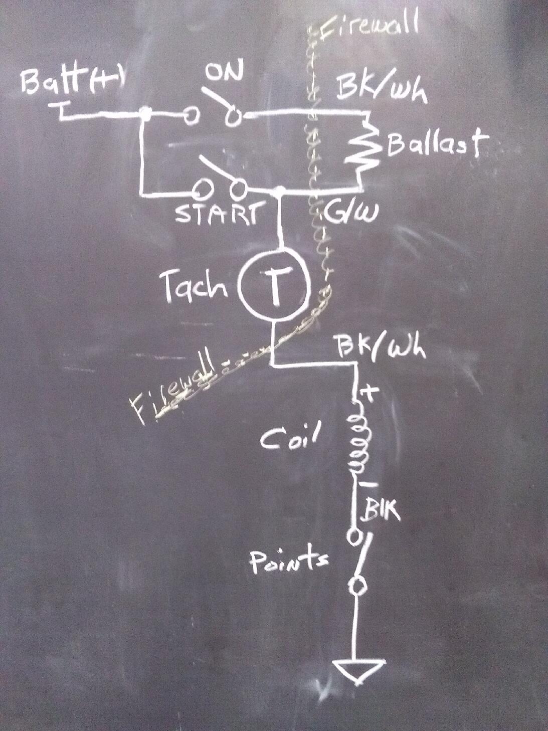

May 8, 2024May 8 comment_665114 6 hours ago, Yarb said: That's a great drawing showing the ignition system. With the line showing the firewall in there, it does an excellent job of illustrating why you only need one wire on each end of the ballast resistor and why you don't connect directly from ballast and coil. Shows how the other connections are made inside the harness. Thanks for posting that! Link to comment https://www.classiczcars.com/forums/topic/68934-73-240-no-spark/?&page=12#findComment-665114 Share on other sites More sharing options...
May 8, 2024May 8 comment_665115 22 minutes ago, Shawninvancouver said: As per this post 240 keep in mind it’s a brand new 1.5ohm coil. Brand new condenser on dizzy. I may even put brand new points in. When you say I should also have power on the terminal of the dizzy what do you mean? The screw that tightens it to mount ? And which is positive side of points ? Where the wire from the - on the coil is connected on the dizzy and the side of the points that should have 12v the one connected to the spring and the one the red wire in your photo is connected to. Link to comment https://www.classiczcars.com/forums/topic/68934-73-240-no-spark/?&page=12#findComment-665115 Share on other sites More sharing options...
