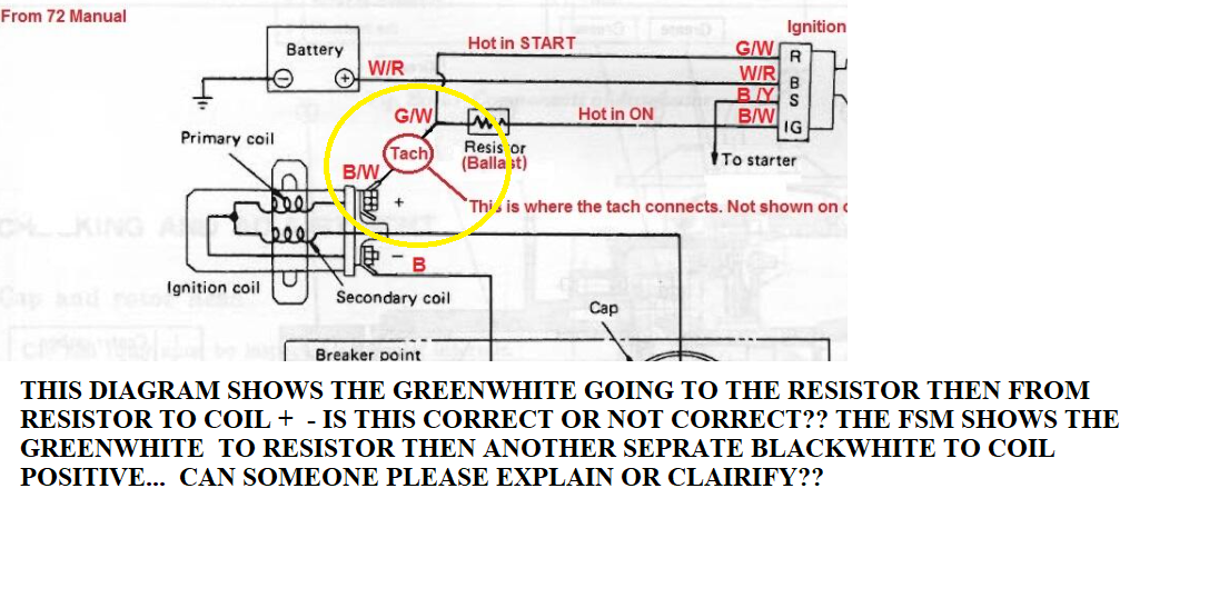

something is wrong in the yellow circle area.. as only green.wt goes to resistor..  i have now followed those instructions and possibly wrong..please clairify the correct wiring..
There is nothing wrong in the diagram. It shows the correct wiring.
So can you please put the wiring back like it was shown in this pic and hotwire the thing? One wire on one side of the resistor goes to the coil (+). One wire on the other side of the resistor goes to the battery (+).
Crank the car. See what happens.
  • Agree 1
Hi captain.  I will try that jumper test. My main question is do you not think the green white needs to be connected?? And why in the fsm it shows the two wires going go the resistor are a green wt and a black wt from harness and the only black wt going to positive on coil also comes from harness.  ??
The G/W does not need to be connected at all if you hotwire it as I described.
And about your other question... Some of the connections shown in the FSM diagram are made inside the harness. That diagram is a good functional description of how the system works, but it can be a little confusing if you are looking at the wires coming out of the harnesses.
For example, the connection between the G/W and the tach is made in the harness and you don't have to tie that together manually. It's already done. When I get a chance, I'll try to whip up a sketch showing the connections in a different form. Still the same electrically, but drawn differently.
In the meantime, just simplify stuff! Take all the wires off everything and hotwire the durn thing. Let's try to figure out if your distributor works!!!  LOL

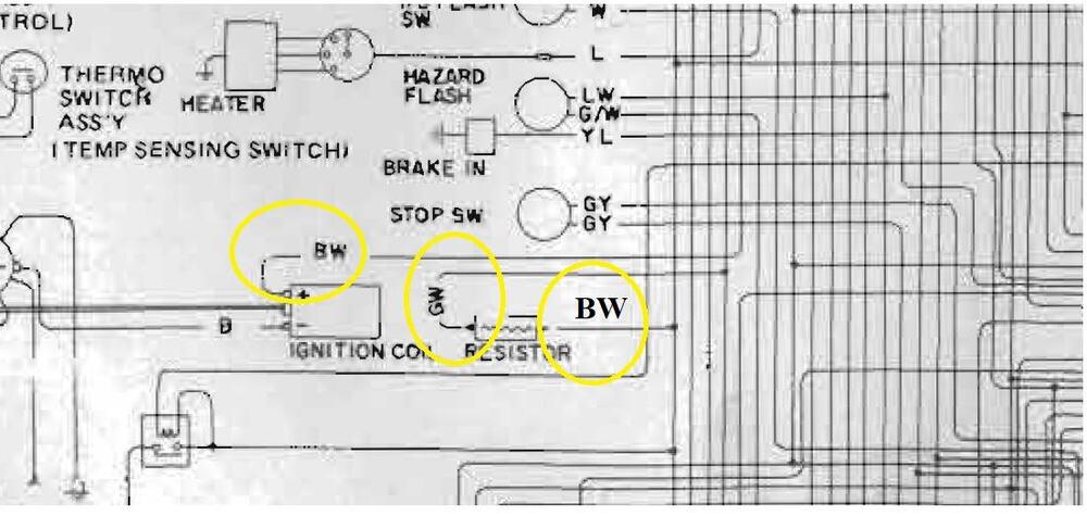

YES 240DWK, points open and close.. i tried 3 dizzys all points gapped correct..   i have once again attached a few diagrams trying to figure out proper wire connections..  i am hoping im just mixing up the connections... the red one was posted in this thread,, and shows greenwht to resistor then to coil +  yes Capeeetain - i know the greenwt will not need to be connected if hot wired... i was first attempting to do it the right way with out wires running across engine...  i will try the hot wire method to see what happens... it if that works what does that mean? one of the wires is dead along the way somewhere/in the harness?? the main reason i think wires were always wrong is that  i always had a wire going from resistor to coil +   is that correct or wrong???  **USING A PETRONIX FLAME THROWER COIL **
the fsm is totally different.. can someone explain these two diagrams...  i just need the proper connections...

I don’t think there should be a wire directly from the resistor to the coil, power should be on the b/w to the resistor when the key is in the “run” position and on the g/w when the key is in the “start “. And of course power at the + wire on the coil with the key in either position. And these measurements are at the end of the wires disconnected. Will not read 12 volts if connected to the coil or resistor, it will be lower due to voltage loss through the system.
