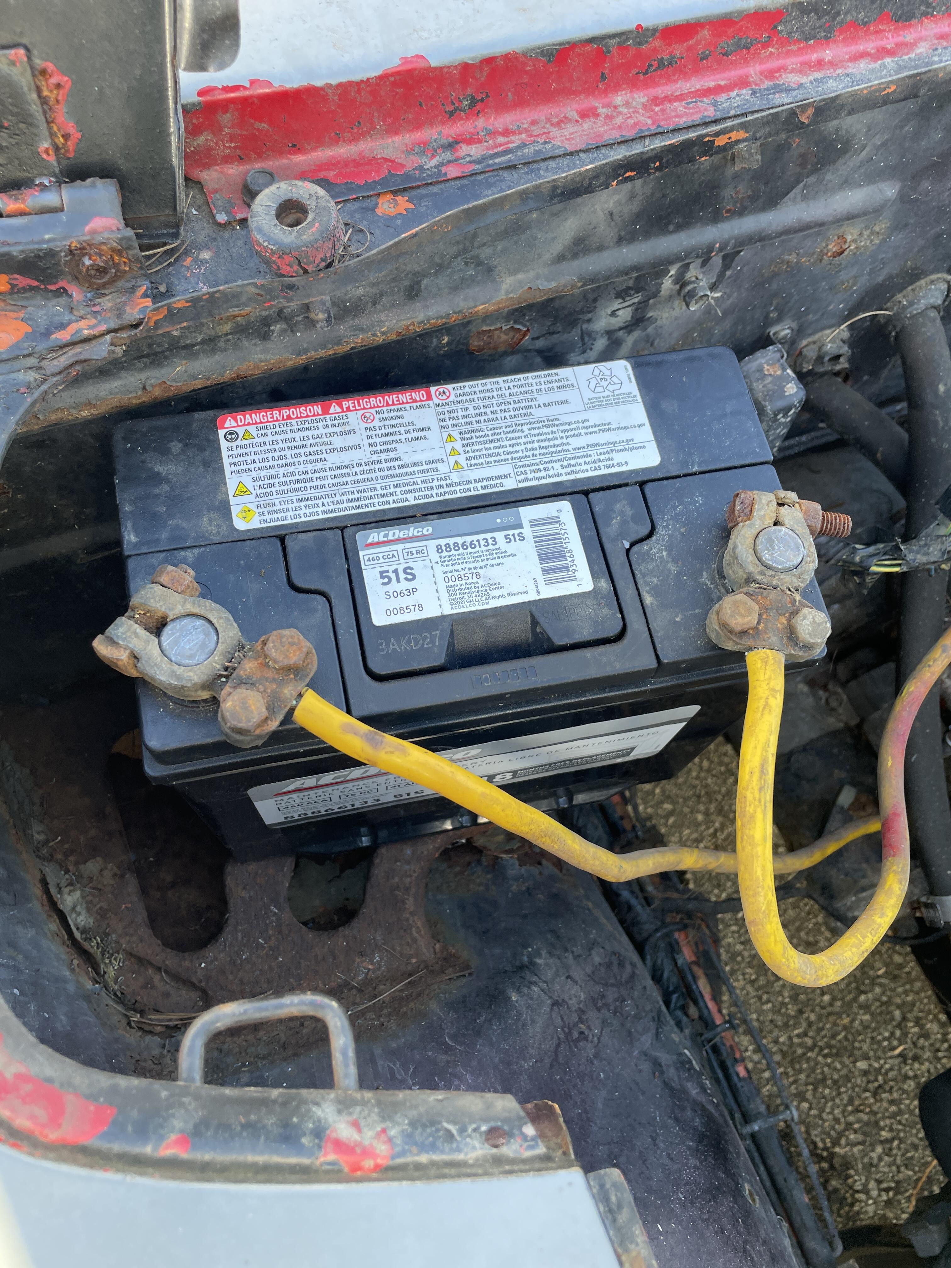

any chance on this battery not big enough? But it cranks engine.
