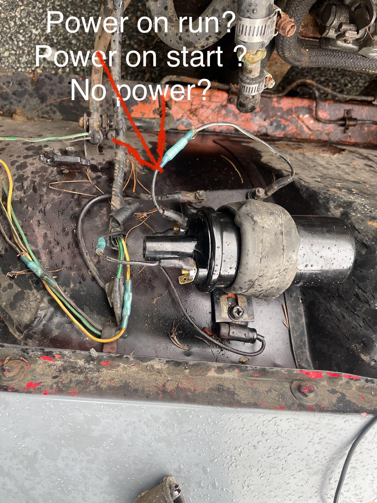

May 5, 2024May 5 Author comment_664966 Ok. So with this way wired what should I get?? It’s a black white to resister then to coil. should it be power on start? Power on run? Or no power?? Link to comment https://www.classiczcars.com/forums/topic/68934-73-240-no-spark/?&page=9#findComment-664966 Share on other sites More sharing options...

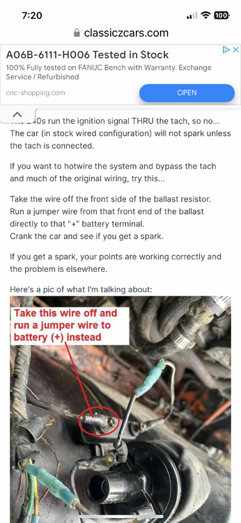

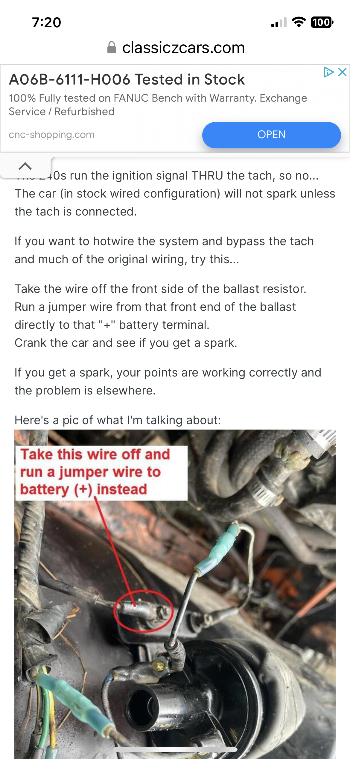

May 5, 2024May 5 comment_664968 On 5/2/2024 at 7:06 PM, Captain Obvious said: Did you do that hotwire test yet? Once we know the results of the hotwire test and we are confident that everything from the ballast resistor, through the point, to the high tension coil wire is working correctly, we can focus our efforts upstream from there. Break the problem into small manageable pieces. CO had a good suggestion here. Stop messing around with that spaghetti-nest of wires. Confirm that you will be able to create spark with just the coil and distributor and coil and plug wires that you have. Disconnect ALL of the harness power wires to the coil. Let them hang, with the ends protected so that you don't have a short circuit. Start with a bare coil, no power or ground wires attached. Run a long wire from the battery positive to the coil positive post. Connect the wire from the distributor (the points inside the cap) to the coil negative post. Crank the engine over using the key or using a remote starter. You'll be doing what old-time car thieves do. Mess around with this setup until you get spark. The pictures of those nasty crusty wires and connections aren't helping at all. Simpify things down to the bare essentials. If you can't get spark with a single hot wire from the battery you'll never get it from any of those in that pile of wires. Link to comment https://www.classiczcars.com/forums/topic/68934-73-240-no-spark/?&page=9#findComment-664968 Share on other sites More sharing options...
May 5, 2024May 5 Author comment_664971 Yo zed. Yes. I did do the hot wire test from battery straight to coil. Nothing happened. When I did that the coil neg went to dizzy but I did it the way suggested. From pos on battery to resistor. Other side of resistor to pos coil. Still no spark. Link to comment https://www.classiczcars.com/forums/topic/68934-73-240-no-spark/?&page=9#findComment-664971 Share on other sites More sharing options...
May 5, 2024May 5 comment_664972 Read carefully what @Zed Headjust wrote. The resistor is not involved Link to comment https://www.classiczcars.com/forums/topic/68934-73-240-no-spark/?&page=9#findComment-664972 Share on other sites More sharing options...
May 5, 2024May 5 Author comment_664974 This was how I was told to jump it. Link to comment https://www.classiczcars.com/forums/topic/68934-73-240-no-spark/?&page=9#findComment-664974 Share on other sites More sharing options...

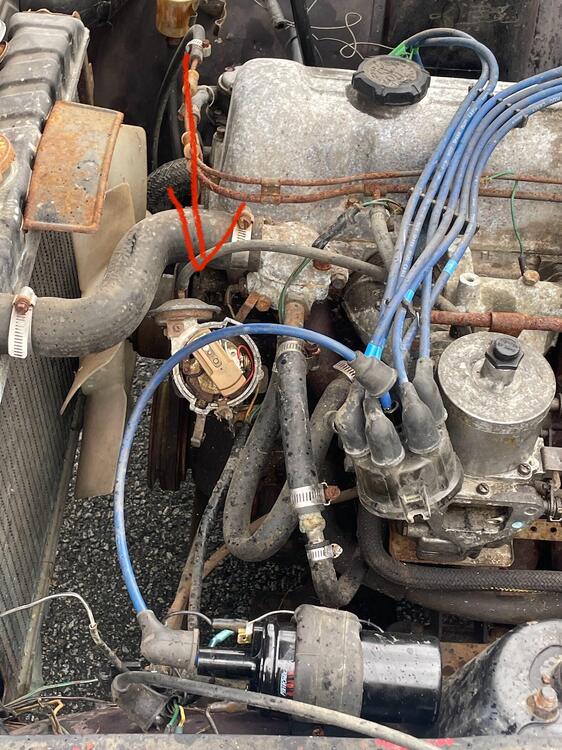

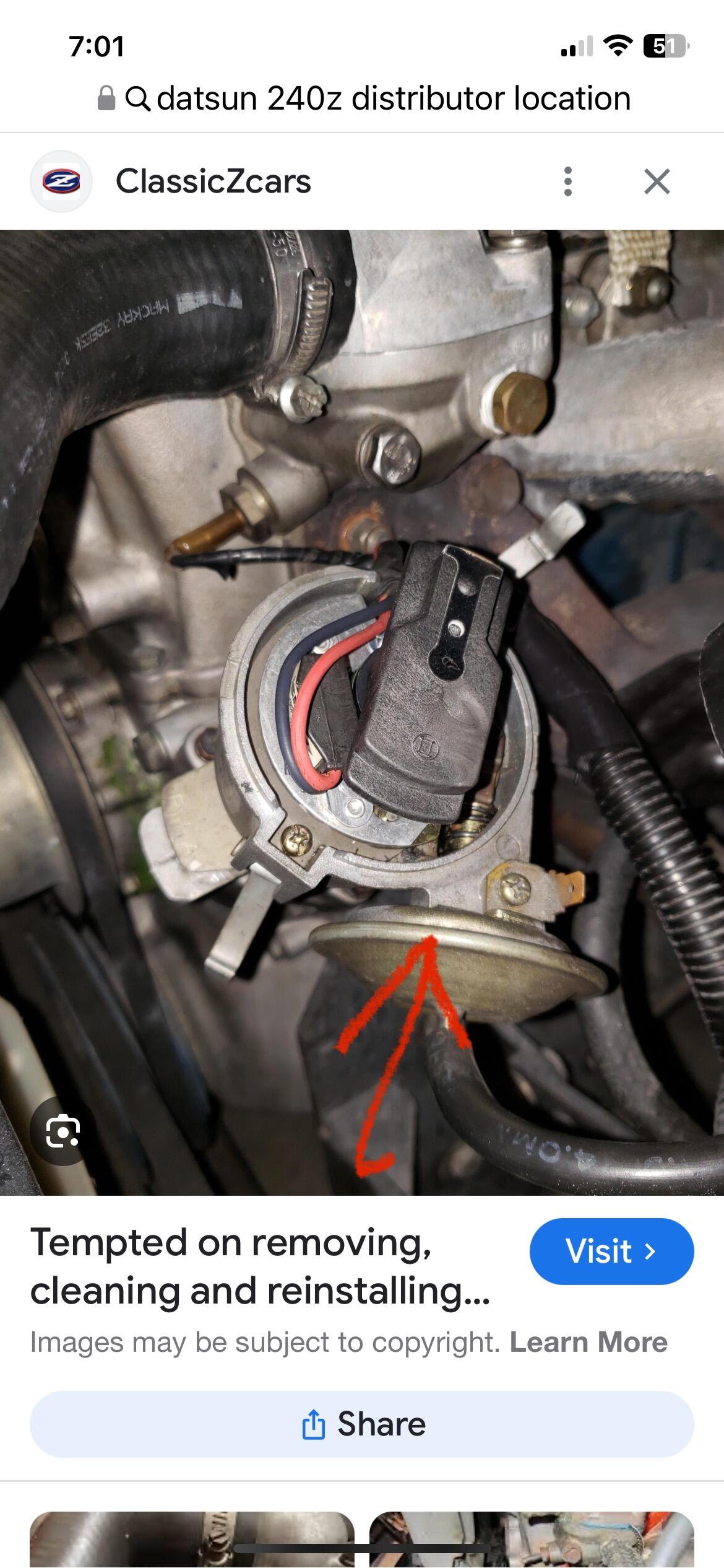

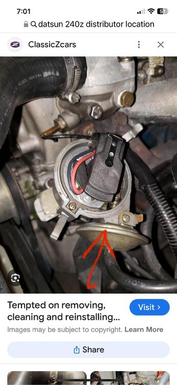

May 6, 2024May 6 Author comment_664987 Also curious why I have 3 distributors that cane with the car. And all of them go in with huge vacuum advance disc up on the top and the mark on the dizzy cap for #1 is in top right when it is actually bottom left. Here is mine with vaccum advance on top and a photo of how most cars are with it in bottom. Any idea why?? Link to comment https://www.classiczcars.com/forums/topic/68934-73-240-no-spark/?&page=9#findComment-664987 Share on other sites More sharing options...
May 6, 2024May 6 comment_664989 7 hours ago, Shawninvancouver said: Ok. So with this way wired what should I get?? It’s a black white to resister then to coil. should it be power on start? Power on run? Or no power?? If that b/w is the one that you tested and has power than the answer is Power on run, but no power on start. Link to comment https://www.classiczcars.com/forums/topic/68934-73-240-no-spark/?&page=9#findComment-664989 Share on other sites More sharing options...
May 6, 2024May 6 Author comment_664996 Ok. Thats what it does. It’s power on run. So that being the case. Should this wire set up work ? It has no green white and no second black white used. Was the car wired this way to run and bypassing the tach ?? Link to comment https://www.classiczcars.com/forums/topic/68934-73-240-no-spark/?&page=9#findComment-664996 Share on other sites More sharing options...
May 6, 2024May 6 comment_664997 I don’t think a car that wired to have no power while trying to start it will ever run. You already said in a previous post that you had power on the green white wire when the key is in the start position. Could you please connect the b/w with “run” power to one side of the resistor and the g/w with the “start” power to the other side of the resistor. Then connect a new wire jumper from the g/w side of the resistor to the positive terminal on the coil. This way you will have power to the coil in both run and start. Link to comment https://www.classiczcars.com/forums/topic/68934-73-240-no-spark/?&page=9#findComment-664997 Share on other sites More sharing options...
