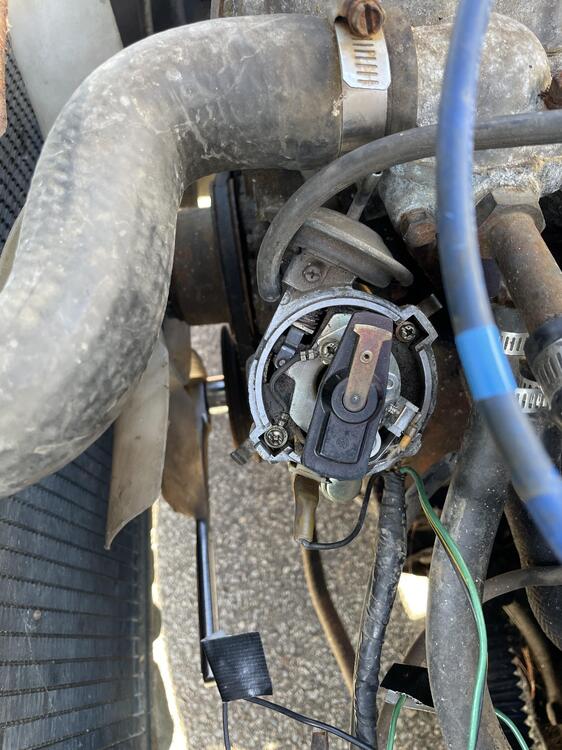

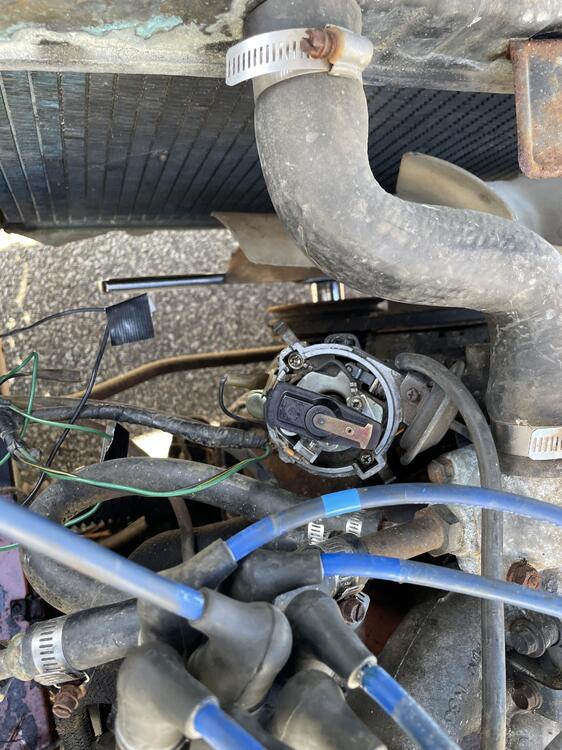

Posted May 9, 2024May 9 comment_665173 After long battle, I finally found spark but now I need to figure out how to organize plug order on top of the distributor. I tried to find dead centre by putting a screwdriver inside Spark click hole number one to piston comes to top, but all that does is end up having the rotor point to a funny direction around around 3 o’clock looking from the driver seat. I know it should be pointing around 830 but when the rotor is at 8:30 the piston is not at TDc. The distributors on the only way I can go on. It is lined up and seated properly the distributor rotates properly, but I cannot figure out where sparkling number one is any help this would be great. I do see the mark on the distributor cap or number one is supposed to go but once again that Mark is at about 3 o’clock while looking at it from the driver seat, is it supposed to be there or not? Edited May 9, 2024May 9 by Shawninvancouver Link to comment https://www.classiczcars.com/forums/topic/68960-73-240z-how-to-find-plug-order-on-dizzy/ Share on other sites More sharing options...
May 9, 2024May 9 comment_665174 Now that you have spark, things can move on. I remember in the other thread the topic of TDC came up and there was a response about where the cam lobes are and you might have been a rotation of on TDC. Open the Oil cap and see if the 2 front lobes on the cam are up in like rabbit ears. This should also be with the #1 cylinder all the way up like you described in the other thread with the screw driver in the spark plug hole. Your firing order is 1 5 3 6 2 4. With the engine at TDC as described the rotor in the distributor would be pointing at cylinder #1. Link to comment https://www.classiczcars.com/forums/topic/68960-73-240z-how-to-find-plug-order-on-dizzy/#findComment-665174 Share on other sites More sharing options...
May 9, 2024May 9 comment_665175 As well, yes your distributor is in the wrong orientation, but just leave it like that. Find TDC on cylinder #1 on the compression stroke. Where ever the rotor is pointing install plug wire #1 there and do the rest in the right firing order counterclockwise. Fixing you distributor orientation is best left for another time. Link to comment https://www.classiczcars.com/forums/topic/68960-73-240z-how-to-find-plug-order-on-dizzy/#findComment-665175 Share on other sites More sharing options...
May 9, 2024May 9 Author comment_665180 Ok. So it’s a combination of the piston being up. Screwdriver in spark plug hole. And also looking in oil cap to see if two lobes are up??with my distributor orientation should the rotor still point at like 8:30 looking at it from the side of the car? Link to comment https://www.classiczcars.com/forums/topic/68960-73-240z-how-to-find-plug-order-on-dizzy/#findComment-665180 Share on other sites More sharing options...
May 9, 2024May 9 comment_665188 As @240dkw says. Ignore where you think it should be. Once TDC is achieved per the cam lobes and cyl #1 all the way up the rotor in the distributor will be pointing at #1, then the firing order goes counter clockwise from there in the order stated in post #2. Link to comment https://www.classiczcars.com/forums/topic/68960-73-240z-how-to-find-plug-order-on-dizzy/#findComment-665188 Share on other sites More sharing options...
