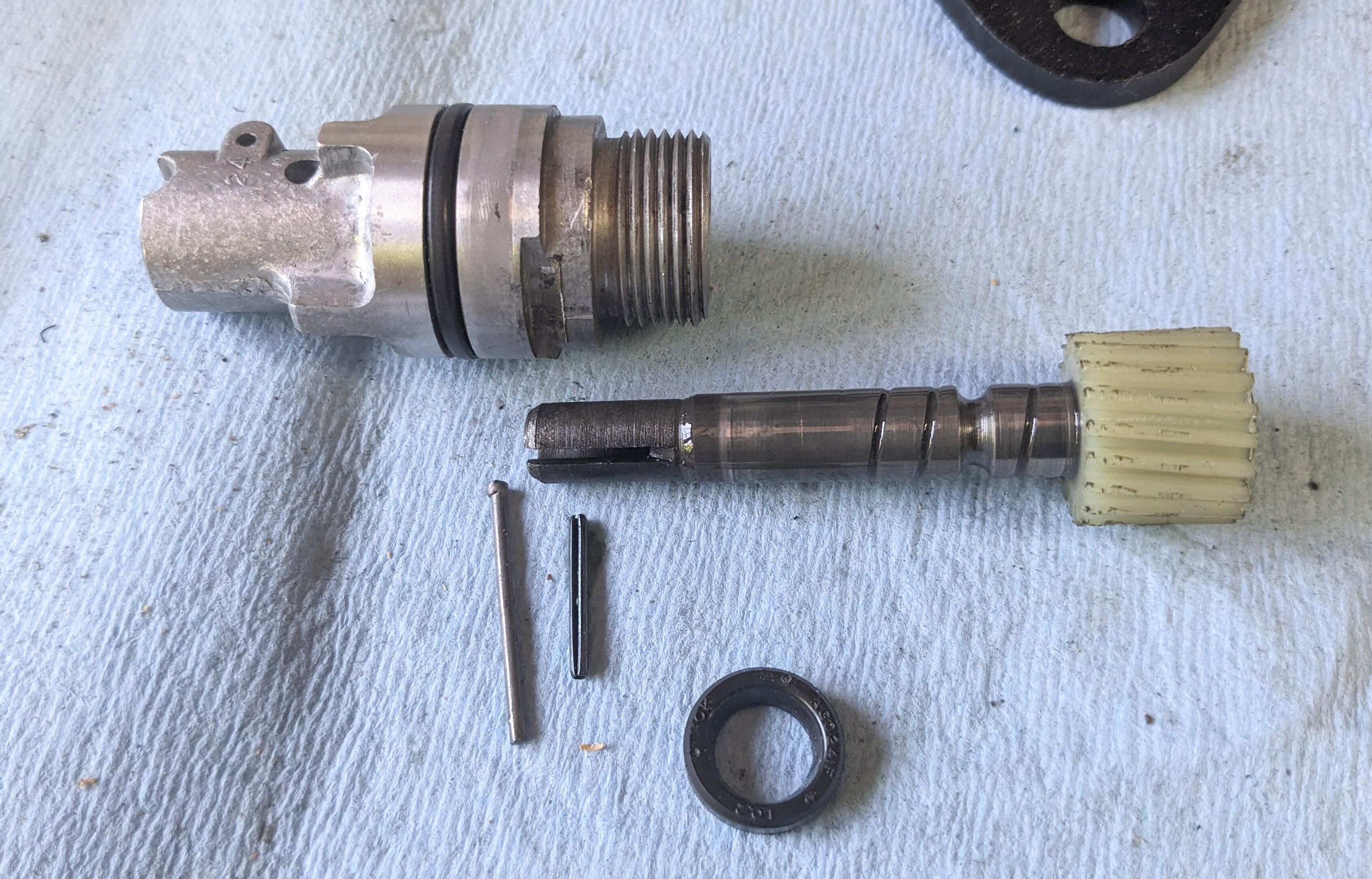

I'm going to order the 280ZX clutch kit, just wondering if there is anything else I should be aware of besides swapping over the speedo drive gear.

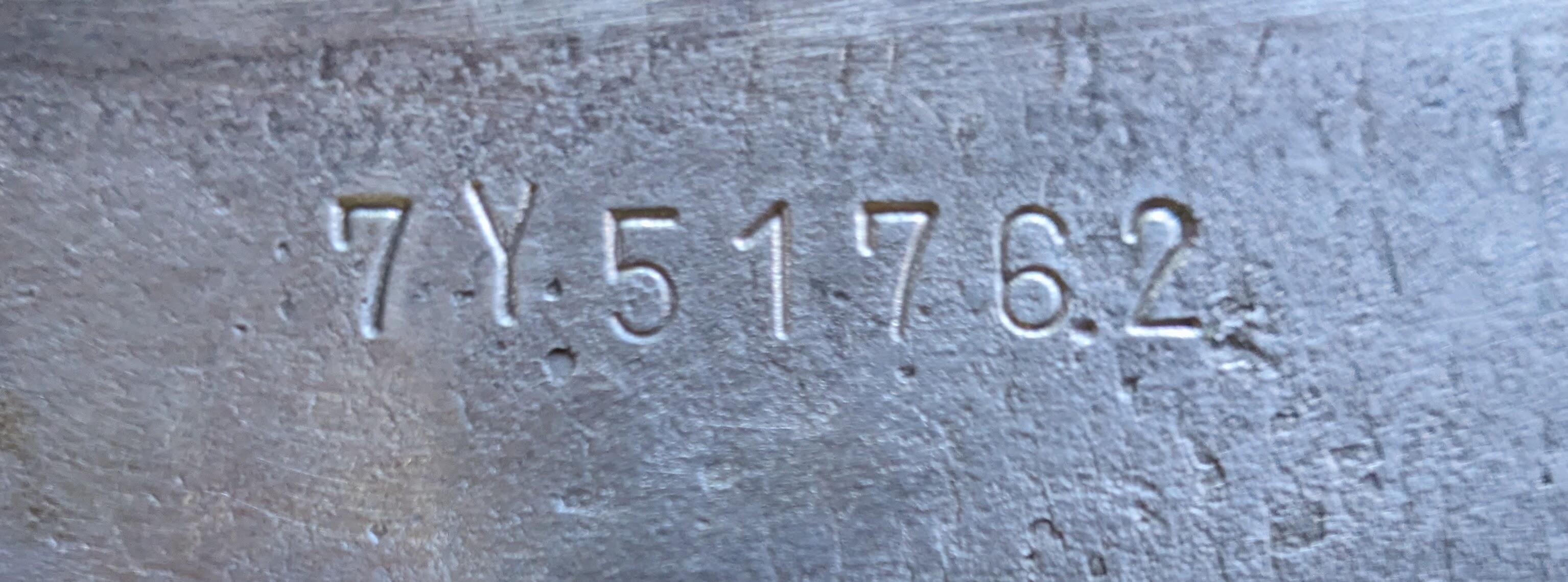

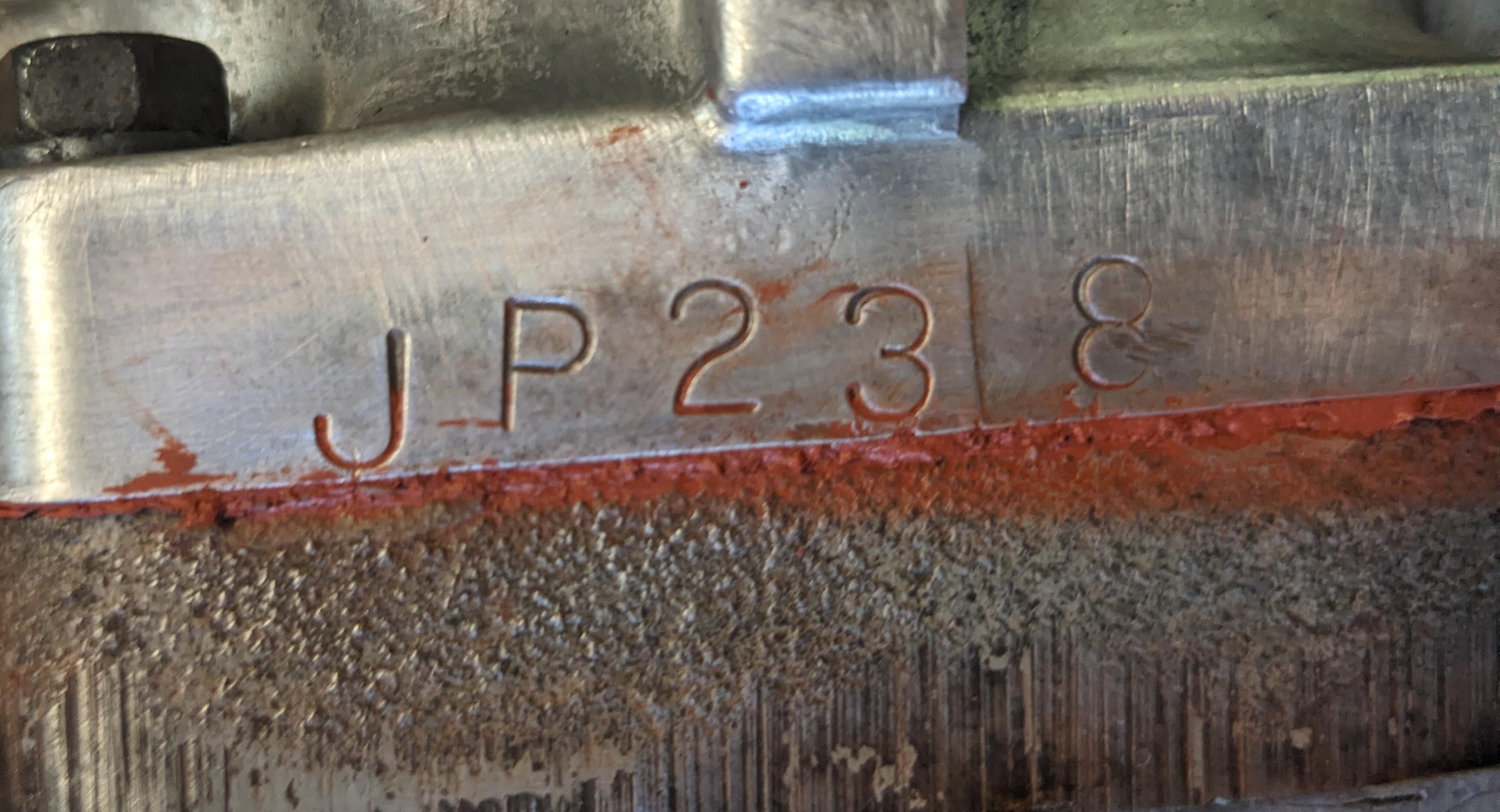

ID numbers for trans
19tooth white gear

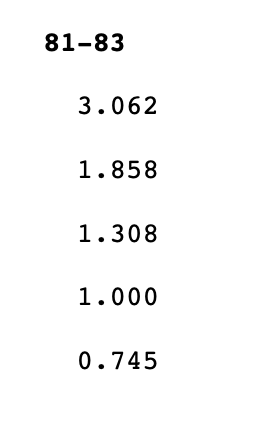

Gear ratios. 1981 280ZX had 3.90:1 FD, vs. 3.54:1 for my 75.

Thank you for the input.  I ordered a new collar to match the 280ZX clutch kit.
It does not include the shifter. I will look at the linkage - at a glance the yoke looks the same as my '75. I did read that you need to use the 280Z shifter to get proper operation. EDIT - not finding anything re grinding shifter for 5th engagement - I'll look further.

All of the seals were still available through Nissan. There is a complete parts list posted by @EuroDat on the forum. With @dave wm help he guided me through resealing two close ratio transmissions. Be sure to change all of the seals including the ones in the shifter housing. I have a small amount of parts not many including the main shaft nut I didn’t need. Also the detent springs and ball bearings are still available as well as the speedo seal. Check out @EuroDat. A plethora of information there.
