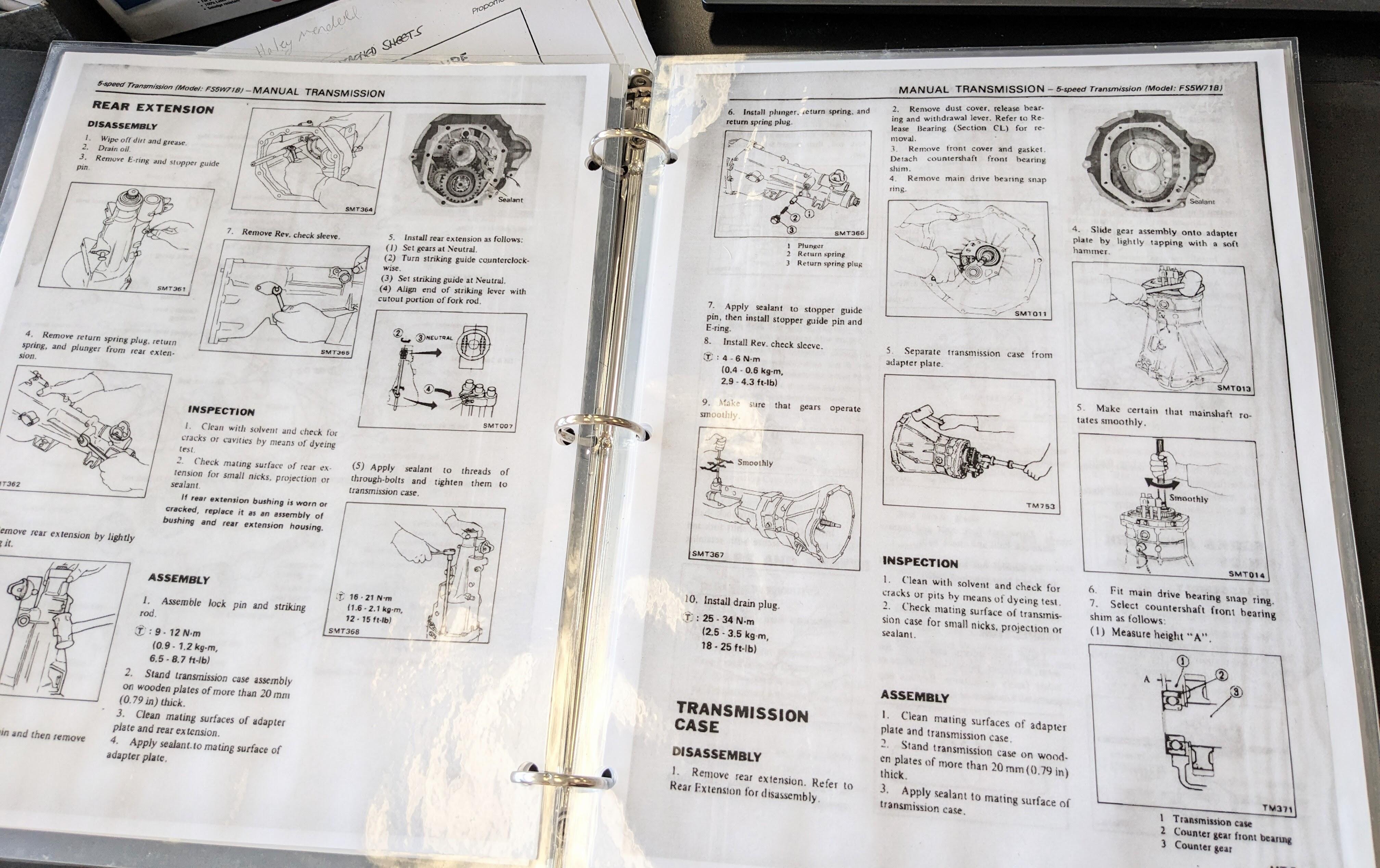

May 14, 2024May 14 Author comment_665439 6 hours ago, Zed Head said: Probably not a "requirement". Dave WM rebuilt one with completely destroyed adapter plate bearings (the center plate) and it worked fine when finished. It was still working even with the bad bearings. The parts seem to be very durable and able to take lots of abuse. Dave's thread might also be pretty descriptive as far as rebuilding. @Dave WM Otherwise, hate to do it to you but ... the FSM has a very thorough rebuild procedure laid out. I was assuming the 280Z manual would not be accurate for the 5 speed - your opinion is that the 4 speed directions are essential;y the same? Or did you mean the FSM for the 280ZX? Link to comment https://www.classiczcars.com/forums/topic/68969-75-280z-5-speed-swap-from-81-280zx-any-catches-i-should-be-aware-of/?&page=2#findComment-665439 Share on other sites More sharing options...

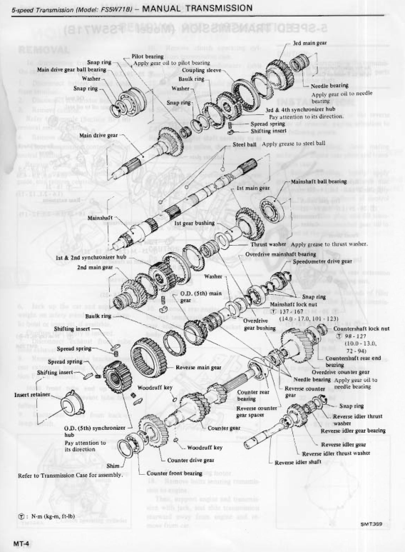

May 14, 2024May 14 comment_665440 21 hours ago, HusseinHolland said: 81 280ZX 5 speed I'd use this one. Should be a Manual Transmission chapter inside. A sample. There's even a specific bearings section. Link to comment https://www.classiczcars.com/forums/topic/68969-75-280z-5-speed-swap-from-81-280zx-any-catches-i-should-be-aware-of/?&page=2#findComment-665440 Share on other sites More sharing options...
May 14, 2024May 14 Author comment_665441 21 minutes ago, Zed Head said: I'd use this one. Should be a Manual Transmission chapter inside. A sample. There's even a specific bearings section. Thank you so much for posting the link. I'll download & print the relevant sections. Link to comment https://www.classiczcars.com/forums/topic/68969-75-280z-5-speed-swap-from-81-280zx-any-catches-i-should-be-aware-of/?&page=2#findComment-665441 Share on other sites More sharing options...

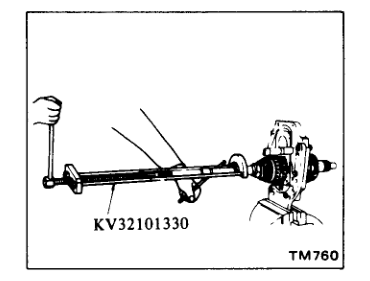

May 14, 2024May 14 comment_665442 I've had a few apart for small things but have not replaced the adapter plate bearings. From what I've read the hardest part is getting the gears or bearings off of the long tail shaft. But people have made their own tools from pipes and other odd things. I think it's this illustration. You can always tear in to it until you get stuck then put it back together. Link to comment https://www.classiczcars.com/forums/topic/68969-75-280z-5-speed-swap-from-81-280zx-any-catches-i-should-be-aware-of/?&page=2#findComment-665442 Share on other sites More sharing options...

May 14, 2024May 14 Author comment_665458 12 hours ago, Zed Head said: I've had a few apart for small things but have not replaced the adapter plate bearings. From what I've read the hardest part is getting the gears or bearings off of the long tail shaft. But people have made their own tools from pipes and other odd things. I think it's this illustration. You can always tear in to it until you get stuck then put it back together. I have this type bearing splitter tool I bought some years ago - I think it will work for that extension Edited May 14, 2024May 14 by HusseinHolland Link to comment https://www.classiczcars.com/forums/topic/68969-75-280z-5-speed-swap-from-81-280zx-any-catches-i-should-be-aware-of/?&page=2#findComment-665458 Share on other sites More sharing options...
