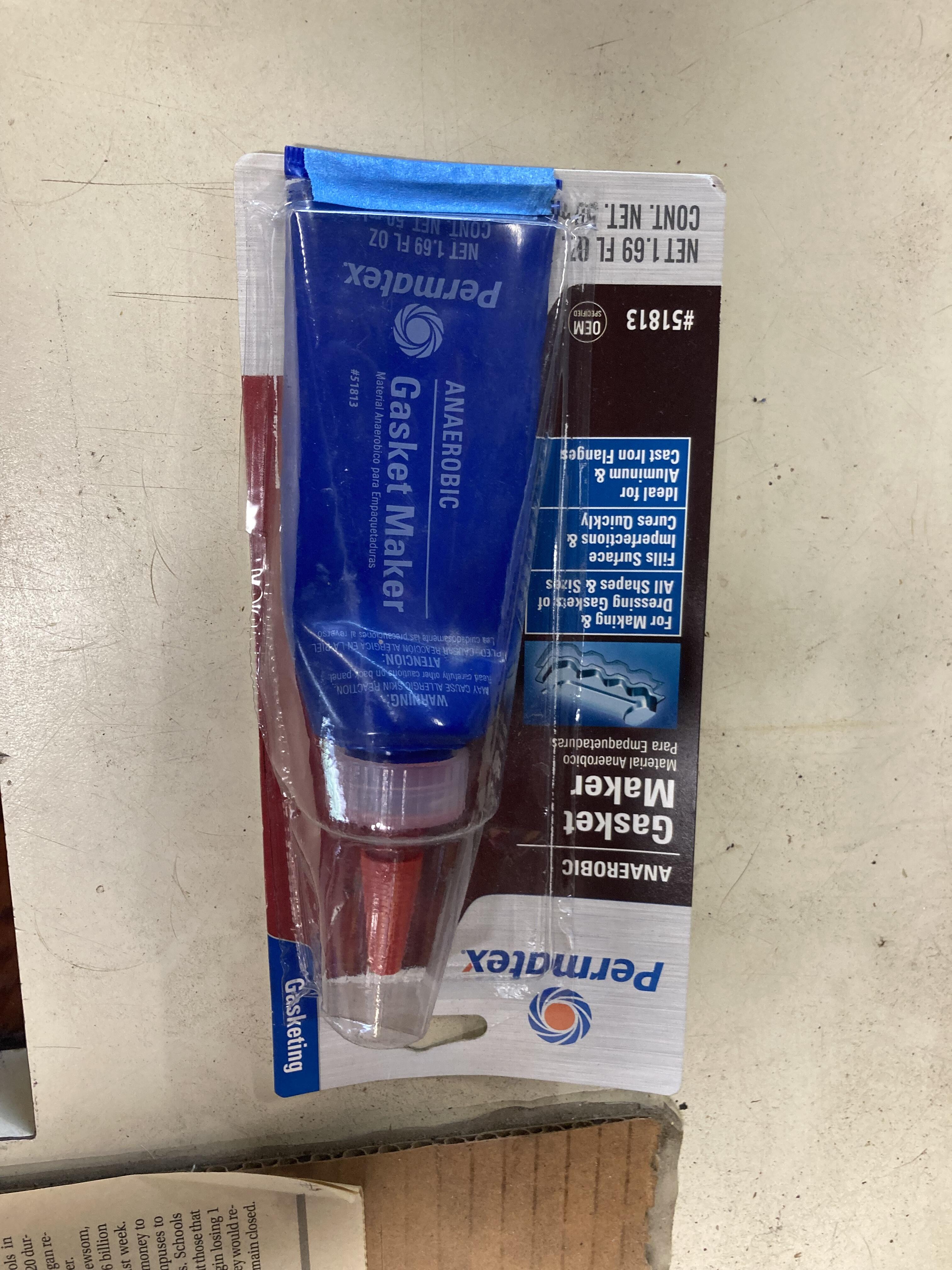

I am pretty sure I just got new lock nuts for the ones that had you pin them over. prob could reuse at least once IMHO, but I had them so used them. Hardest part for me was getting the counter shaft/main gear cluster in all at the same time, I cant recall the exact sequence other than it was a bit fiddly. that and all the fiddly setup on the press to set things up. I think I used the grey rtv or maybe the anaerobic type. think either would be fine.
