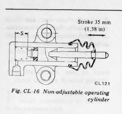

The potential problem is the fork bottoming out on the hole before release.  Your picture shows quite a bit of distance.  Eurodat has posted the slave cylinder throw before, I think it's shown in the Clutch chapter of the FSM.  If you don't have that amount of free space behind your fork that could be a problem.
  • Agree 1
It would be pointless for them to show possible stroke so I assume that what they show is the travel achieved when the pedal is pressed to the floor.  I'd remove that boot and take a measurement.
Thank you for finding that - I have more than 1.5" off the backside of the fork to the back of the casting opening. I need about 1/2" extra rod length to take up the slack. I don't see any difference in PN listings for the slave cylinder between the 280Z & the 280ZX. I know ZcarDepot sells one with an adjustable rod, so I assume this has come up for others. The new disc is substantially thicker than the worn one, I want to say at least 1/6th inch, which would draw the fingers in, since they move rearwards as the disc wears. Not seen this symptom on any other car I've installed a clutch (that was listed/intended for the vehicle in question) on though. I'll play with a longer rod & see if it disengages as expected -have to put the exhaust, etc., back on to test it running of course. Hopefully it's not all coming back apart.

Good luck with the longer slave cylinder rod.  Hope it works well.  If you consider the contact points on the fork ends you might be getting close to the edges there.  Plus there wil be some "unengineered" loads on the fork itself, especailly the spring clips that hold it to the pivot ball, due to the more extreme angle at full disengagement.
Just some thoughts to have in mind if thngs feel odd later on.  You're outside of the design envelope but might be just fine.
