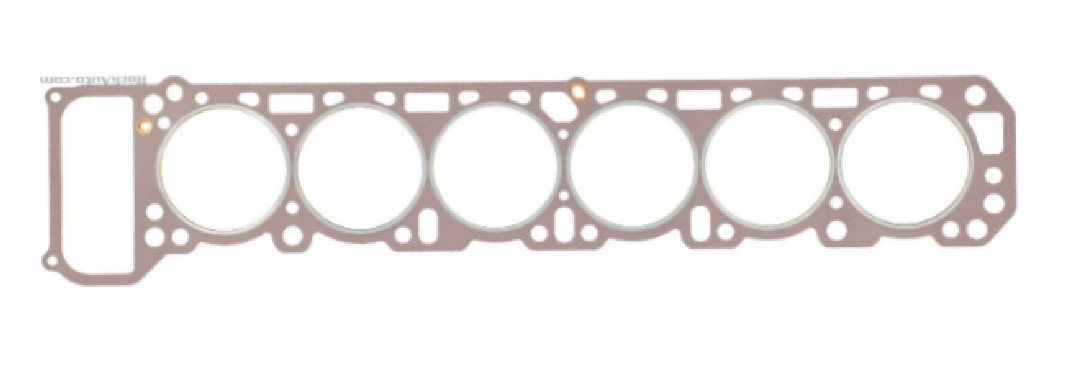

This started with loss of radiator fluid. Not running a closed system or overflow tank so not sure if it's just evaporating or steaming out the cap tube. Not a lot but I'm topping off more than usual. Nothing visible on the block, water pump, hoses or floor. So I'm checking for a blown head gasket. Engine runs fine.
Next question is it steaming or white smoke out the exhaust, yes, cold starts only for a few minutes. once up to temp gone and restarts at temp no white smoke. California climate, it's not very cold, 50's.
I've run every test on the radiator, pressure test, holds 15lbs for 24 hours. Chemical carbon dioxide test at the radiator cap, negative, stayed blue.  Put the pressure tester back on and put 10lbs in the system, rev'd the engine to 6K rpm, no change in fluid pressure. Even checked the oil with the sizzle test. Heated a piece of tin and dropped engine oil from the dip stick on the tin, just smoked like oil should, if it's sizzles and crackles there is coolant present. All negative. No milky substance in the radiator fluid or oil, all is clean.
So moved to compression testing, could be chasing my tail.
The valve cover will come off to inspect and change the valve stem seals. I know, not a fun job. Will inspect all other components while preforming the service and retorque the head bolts.
Back in the 70's a water hose and air hose were built into the gas pump island, adding water to your rad was done when you checked the oil level and was considered routine maintenance.  There may be no leaks in your system, a lot of Z owners just add a catch bottle for regular driving and remove it for car shows.
The original high miles engine in my car used to leak coolant from the right rear area of the head/block interface.  It only leaked when cold and sealed up after the engine warmed up.  Took me a while to figure out since there was no steam or odor from hot coolant boiling away.  I noticed some staining from where it flowed after escaping.
It was a bad headgasket but the bad part was only a coolant sealing area.  The port to the heater core is back there also.
Thanks all,
These engines can send you down a trail. Will report back on the head bolt retorque and the new valve stem seal maintenance.
Will check the seal on the radiator cap but I've put to bed any external coolant leaks with the cooling system with all previous testing preformed.
Another internal coolant leak test preform. Parked the car on my driveway incline (engine elevated) with a large coolant bleeder sealed in the cap neck and the bleeder tank full let the engine idle for 20 mins, opening the heater core valve. After the thermostat opened (140) rev'd the engine and idled for another 10 mins (160) closed the heater valve and rev'd again, zero bubbles or air escaping into the bleeder tank.
