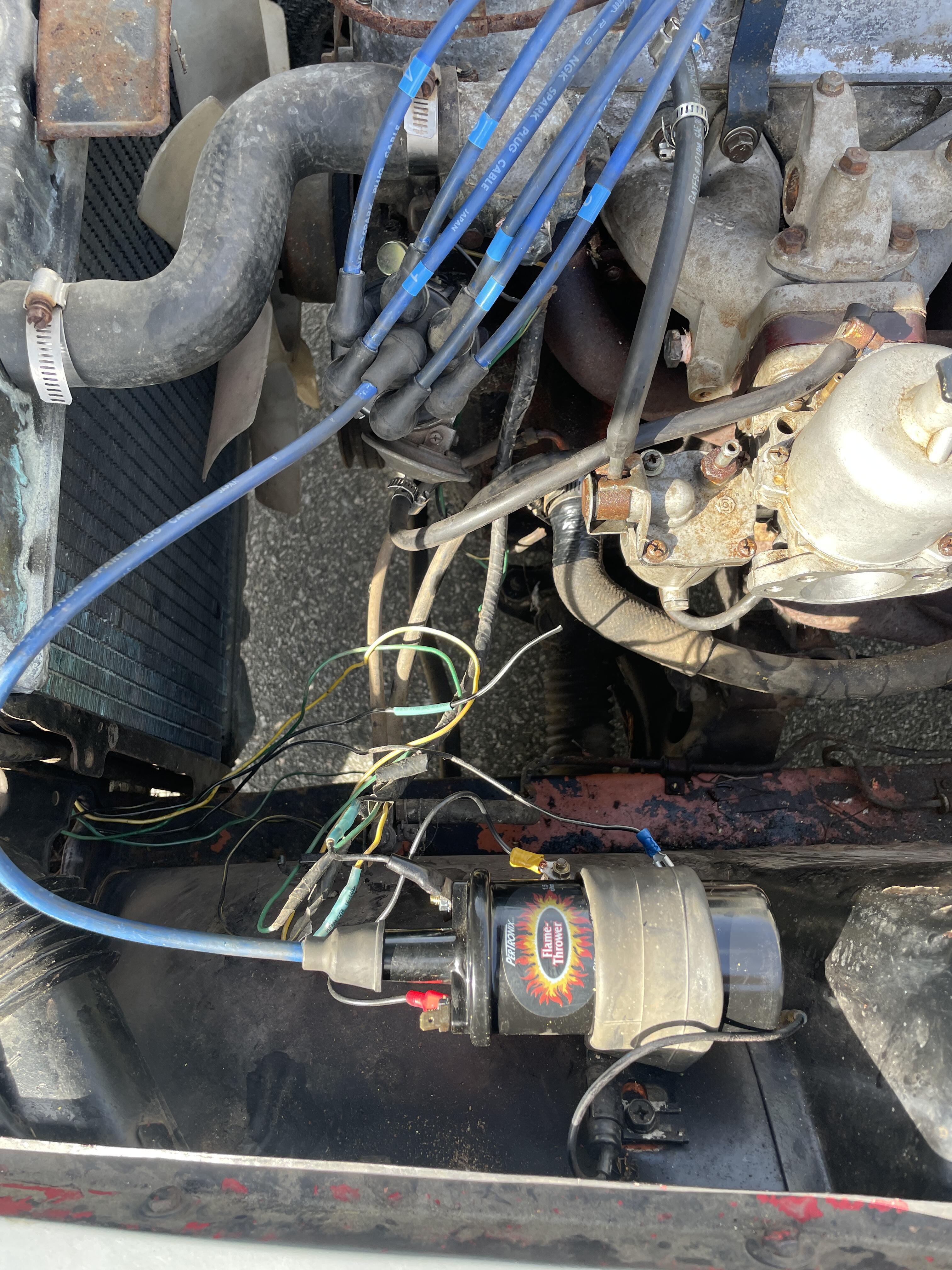

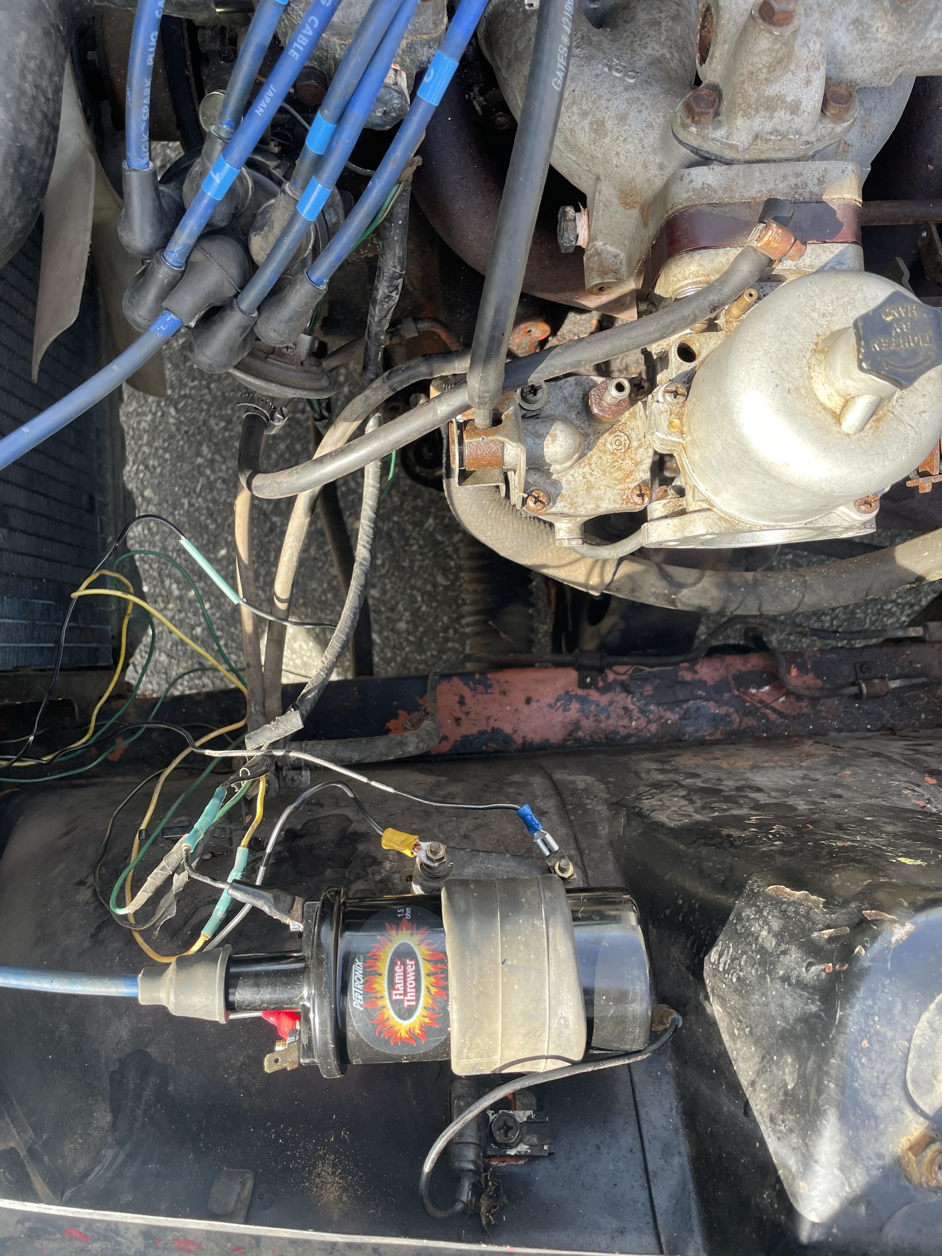

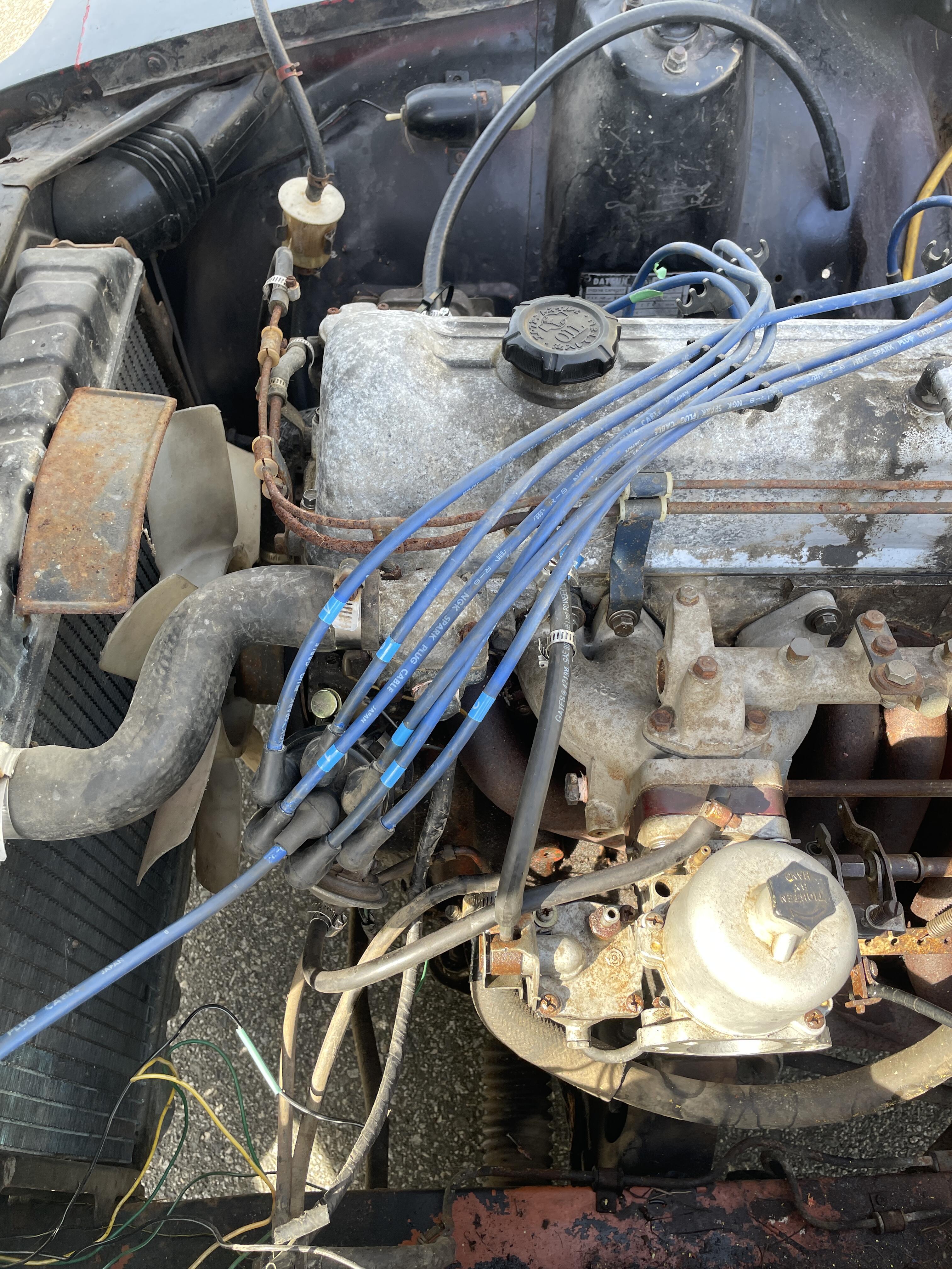

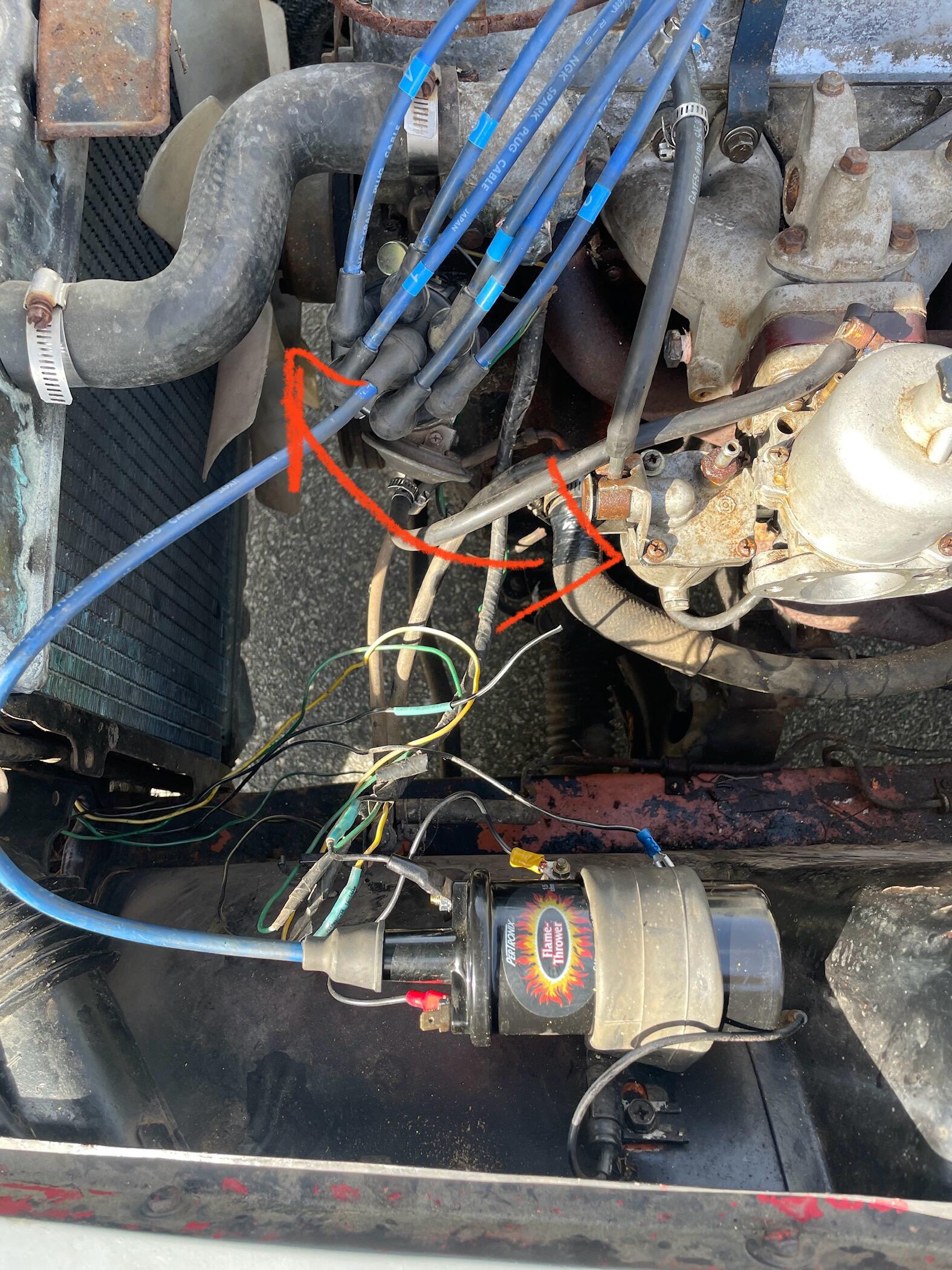

I am going to go with, timing/compression. What have you done to get the dizzy in the different position? Your new photos show the vacuum advance pot in a different but still not correct orientation.
Ok 240 I flipped the mounting bracket over on the dizzy. We put it back on the car then we took the valve cover off got the camshaft position up with the piston at the top so we were in top dead centre then finally the distributor rotor was pointing at 8:30, which is exactly where the mark was on the top of the distributor cap so it was properly done and then put the spark plugs in the proper order and had spark and all cylinders. My only question now is if the timing was too advanced to retarded with the car, not start because we did nothing to do with timing. The distributor could still rotate with the one lockdown screw on the distributor which we did not rotate at all.
Do you think by loosening the lockdown screw on the distributor and rotating it slightly and trying to start the car again it may start it would heavenly distributor slightly off from number one not allowed to the car to start even though it has spark????

It's common to rotate the distributor while trying to start an engine with new parts, to get the ignition timing close enough to start.  Unfortunately it's usually done by people with experience who understand ignition timing.
Another thing that's often done is to watch the points as you slowly rotate the engine by hand to see where the timing mark on the damper pulley is when the points open.  Spark happens when the points open.  Rotate the distributor so that the points open at about 10 degress advance, and make sure that the rotor is pointing at the #1 cylinder electrode.  This will get the igntion timing close enough to where the engine should start and run.  Then you can set the timing correctly using a timing light after the engine is running.
Spark plug wire order is 1-5-3-6-2-4, in counterclockwise rotation.
To put the second part above in to useful terms -
Rotate the engine until the timing mark is at 10 degrees on the damper pulley, on the compression stroke.  Then loosen the distributor clamp and rotate the distributor until the points are just about to open.  Make sure that the rotor is pointing at the #1 position of the distributor cap.  Clamp it down and try to start.
OK, so I guess I was wrong then to think that once I saw spark on every cylinder in the spark plug tester that my spark was proper, and that should have started the engine so technically, even though I saw spark in the spark plug tester that does not mean that the engine would start is that correct? I still need to align the distributor so that the points were about to open and that the rotor arrow was pointing at spark plug number one. In my case, not being an expert, would it be the best way just to slightly rotate the distributor and keep trying to start the car and see if I get it close enough to start And if someone has a second, maybe they can explain to me why if I am seeing spark and have fuel in the engine, it would not start or even backfire or misfire or do something, but I was not getting any sign of even close to starting Is that based on the fact that the distributor was out of alignment thanks again

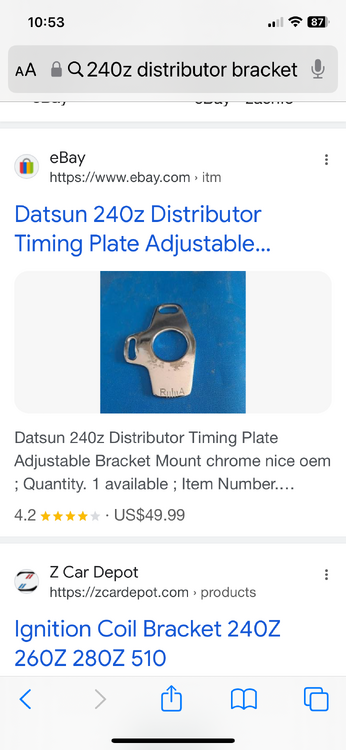

should I loosen the distributor mounting bracket and rotate it like the arrows in the photo?
