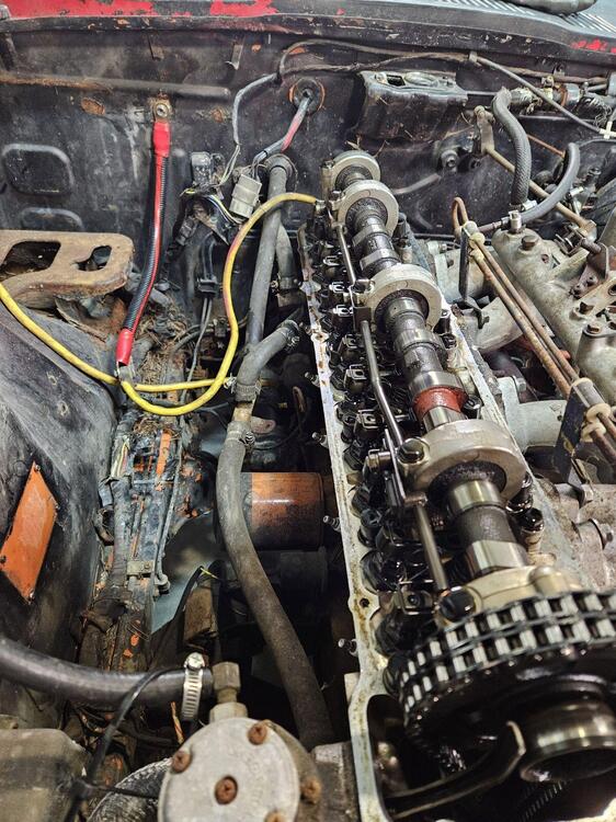

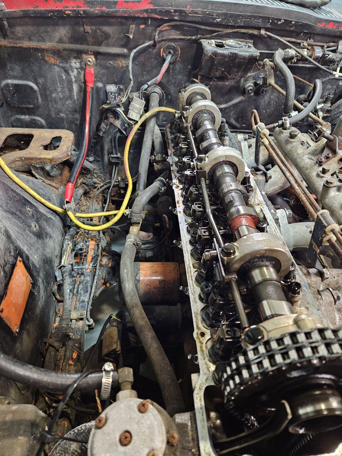

Starter spray was sprayed in carb. Air filter was off. Carb piston was up and sprayed right through in to engine.  I’ve got to be 99% sure we had tdc correct. Valve cover was off and cam 1 2 was up like rabbit ears like everyone said.  Can the cams be up like rabbit ears and be on the wrong stroke? Can ears be up and it be on exhaust stroke? I swear my pal said he saw piston at top.
are these ears up??
They look up, so you're on compression stroke. but which spark plug electrode is the distributor rotor pointing at when you are at TDC on #1, and are the points close to opening, either about to open, open, or just closed.
You need to get those three things happening at the same time so that spark will be correct for all of the cylinders as the engine turns.  Compression stroke on #1, distributor rotor pointing at #1 electrode in the cap, points opening.
If you can take a picture like the one above but with the distributor included, one with the cap on, one with the cap off, and with your plug wires identified in the cap that will tell a lot.
We need to know where the rotor is pointing when #1 is at TDC on compression.  And we need to know that the #1 plug wire is attached wherever it is pointing.  And that the points are open.
p.s get everything set up with the valve cover and the distributor cap removed.  Rotate the engine by hand and watch the parts move.  You'll be able to figure out for sure when the points open on the #1 compression stroke and place your  dist. cap wires correctly.  Then replace the valve cover and try to start.

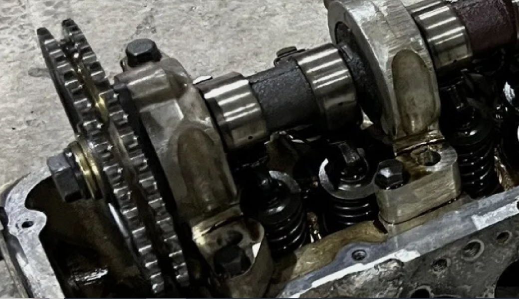

You're right.  I thought the other lobe might not be visible behind the timing sprocket but lost track of the actual configuration, even though I had pasted the rusty cam picture earlier.  I dug up an eBay picture for reference just now, pasted below.
He wore me down, I should have checked.  Not sure how two cam lobes sticking up can be misinterpreted.
Still, all of the advice given by everybody in all of the numerous posts is good.  He just needs to get some of it done.
The picture below shows the #1 cam lobes.  The piston is not at TDC on compression stroke.
