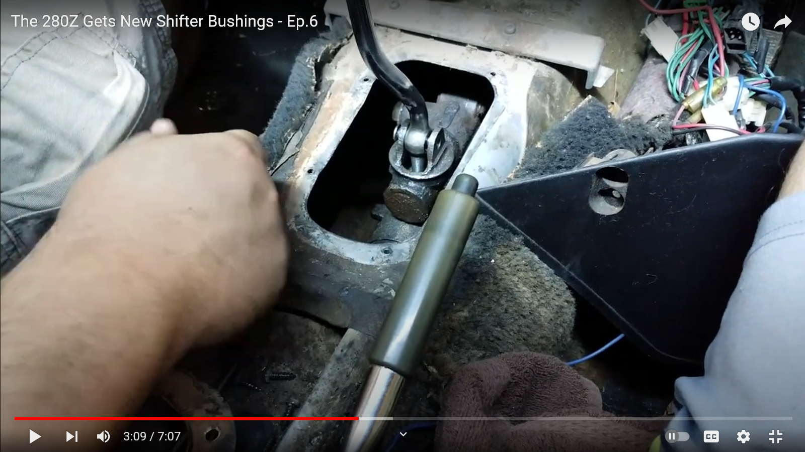

I found this video with a good image of the 280Z shifter hole, below.  I don't think that the 280Z's need shifter bending or notching of the body hole.  I had a 78, 81, and 83 5 speed in my factory 4 speed 76 280Z and had no conflicts.  (I've mentioned that before in other threads.)  I think that Grannyknot has worked on many 240Z's where that might be a problem.

I don't know why Nissan made the hole so big but it looks like you need that front portion of it.  It looks like they left the pattern for you in your second picture, just follow the edges.

They are. We did a auto-to-5 speed swap in the '75 280Z and the console didn't change. The auto trans bits came off and manual shift boots went on. We just trimmed the trans tunnel hole forward using the upper piece of sheet metal as a guide. Then just check the shift lever clearance. I have a close ratio ZX 5 speed in my 260 and I definitely bent the rod - BUT I used the straightish ZX shifter, not the early Z shift lever...
