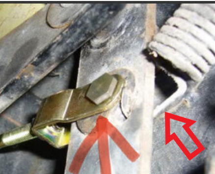

Posted June 2, 2024Jun 2 comment_666098 I am trying to remove the clutch pedal so I can remove the clutch master cylinder. I have removed the small cotter pin in the clevis pen, but the clavus pin will not come out. It is welded shut inside the hole through the clutch pedal. Has anyone ever encountered this? It is impossible. I put a screwdriver inside and wedged it up against a pin and pushed as hard as I couldn’t pin would not come out what now I did not take any photos but looks like this my clevis pin has a round head unlike one in photo I had my head jammed under the dash for an hour how does anyone get these pins in and out??? Link to comment https://www.classiczcars.com/forums/topic/68998-how-to-remove-clutch-pedal-pin/ Share on other sites More sharing options...

June 3, 2024Jun 3 Author comment_666112 How do you turn the Clevis pin 180° if you cannot even get a vice grip or needle those players or any type of players in there to grab a hold of the stupid clevis pin how are you supposed to turn it? This was something I spent so much time on and never spent so much time on any stupid thing before is trying to get one little pin out, I was almost at the point. I was going to take a prybar and stick it in there with some leverage to push the bloody pin out, but if it was grooved and I wasn’t gonna come out, it would’ve just freaking bent the whole rod of the clutch pedal. Edited June 3, 2024Jun 3 by Shawninvancouver Link to comment https://www.classiczcars.com/forums/topic/68998-how-to-remove-clutch-pedal-pin/#findComment-666112 Share on other sites More sharing options...
June 3, 2024Jun 3 comment_666117 Remove the return spring from the pedal and it might be easier to get things in a position to come apart. It will also take any pulling force off of the rod. Also, you can loosen the locknut on the clevis and turn the rod with a pair of pliers to unscrew it completely from the clevis. Ths will leave the clevis hanging free on the pedal. Turning the rod while everything is together is the way to adjust it after installing too. Adjust it without the return spring until it is correct, lock it down, then put the return spring on last. Edited June 3, 2024Jun 3 by Zed Head Link to comment https://www.classiczcars.com/forums/topic/68998-how-to-remove-clutch-pedal-pin/#findComment-666117 Share on other sites More sharing options...
June 3, 2024Jun 3 Author comment_666118 Yeah, that I think I just grabbed that photo off the Internet and I don’t even know if it’s on a 240 I think it would be super impossible to pull that return spring off also and also my clevis pin is not like a bolt on the end it is round so I cannot get any pliers on the end of the clevis pin so the only way is to push it out or to pry it out, but I could not pry it on the end I cannot get a screwdriver in there on the head end and I cannot push it out on the pin, but I did not try wiggling the pedal and pushing it. I should have my friend push the Clutch cylinder from the other side and wiggle it while I’m trying to push the pin out and maybe it will come out, but this is a very difficult pin to get out Link to comment https://www.classiczcars.com/forums/topic/68998-how-to-remove-clutch-pedal-pin/#findComment-666118 Share on other sites More sharing options...
June 3, 2024Jun 3 comment_666119 Doing is knowing. Use Vise-Grips on the spring. My clevis pin had a round head also. Push it out with a screwdriver. Link to comment https://www.classiczcars.com/forums/topic/68998-how-to-remove-clutch-pedal-pin/#findComment-666119 Share on other sites More sharing options...
June 3, 2024Jun 3 comment_666120 Like Zed said, you can remove that spring. Get a good grip on it with your hand, stretch it, and it’ll come out. Then jostle the pedal while trying to remove the pin and eventually you’ll get it. And your correct, your pin prolly has a round head. You could prolly get some vice grips around it to twist it. Link to comment https://www.classiczcars.com/forums/topic/68998-how-to-remove-clutch-pedal-pin/#findComment-666120 Share on other sites More sharing options...
