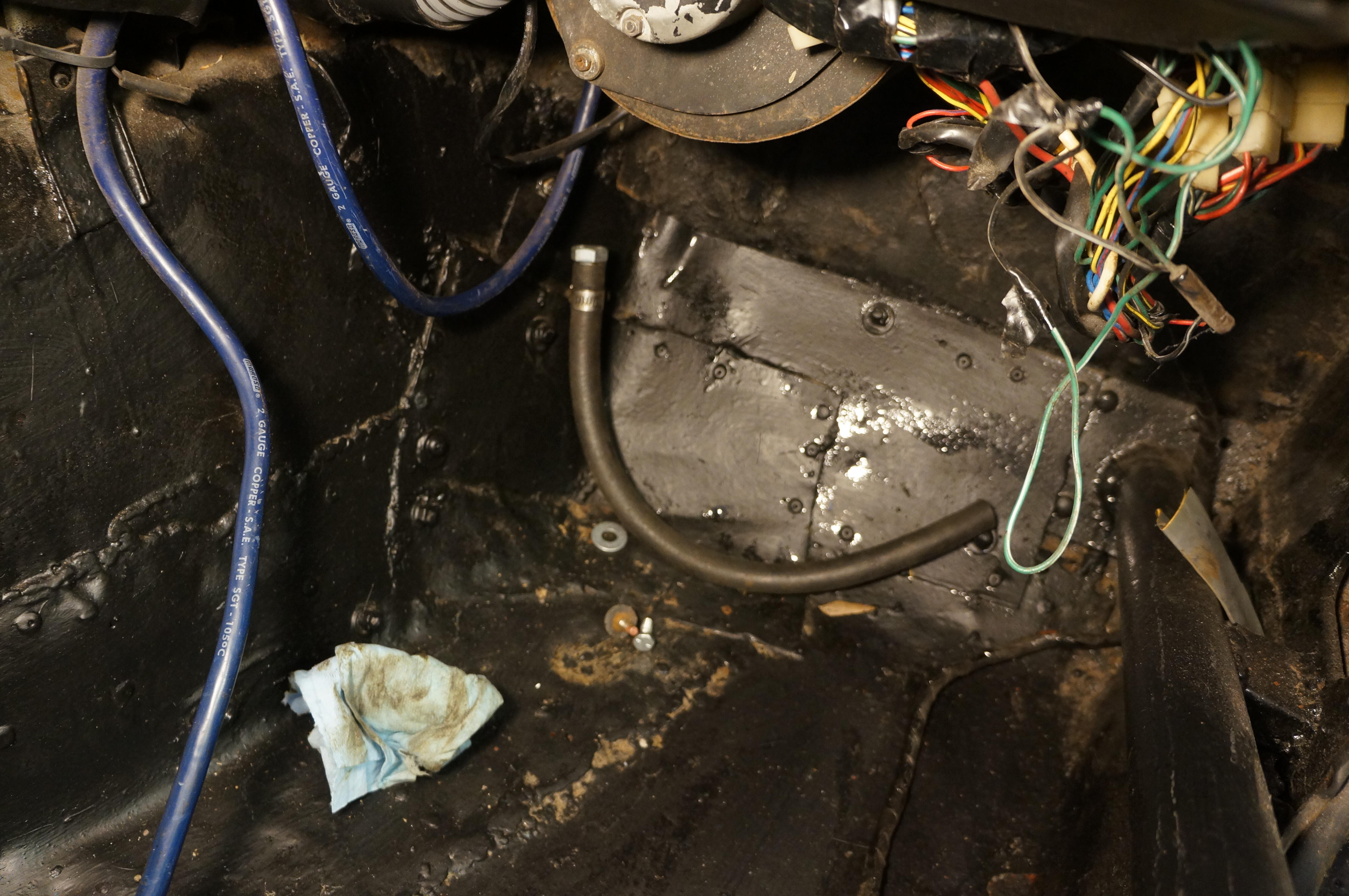

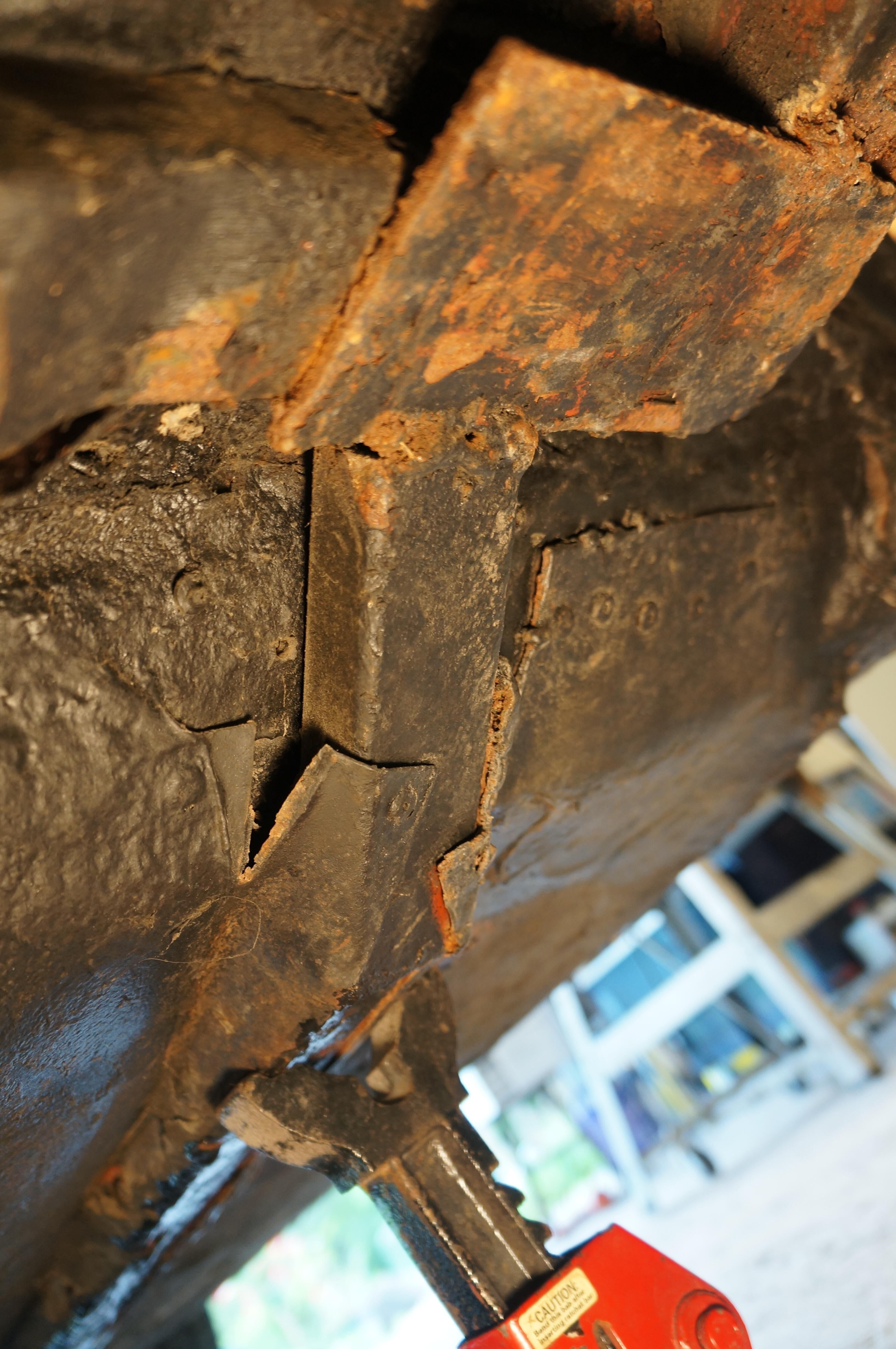

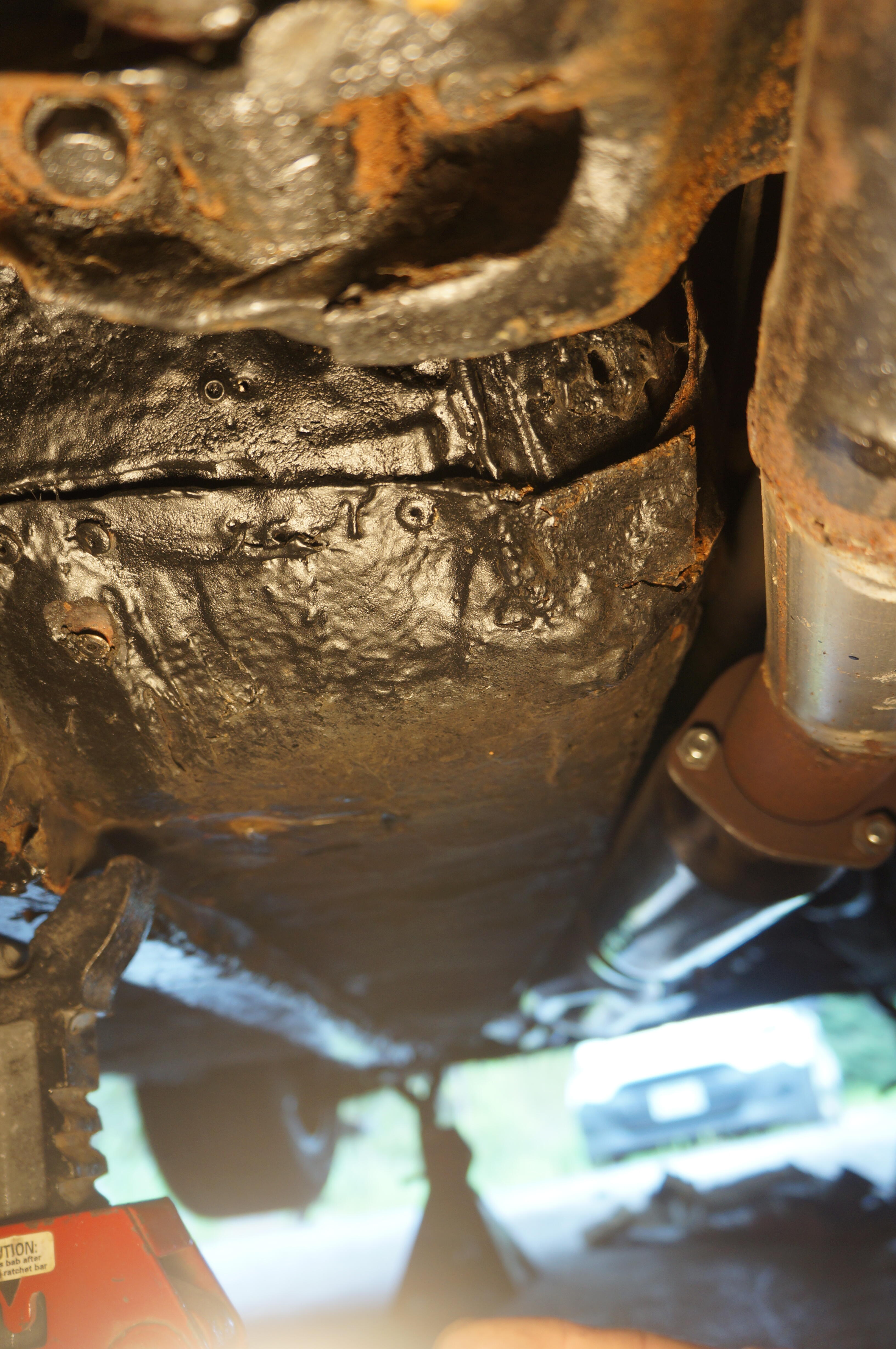

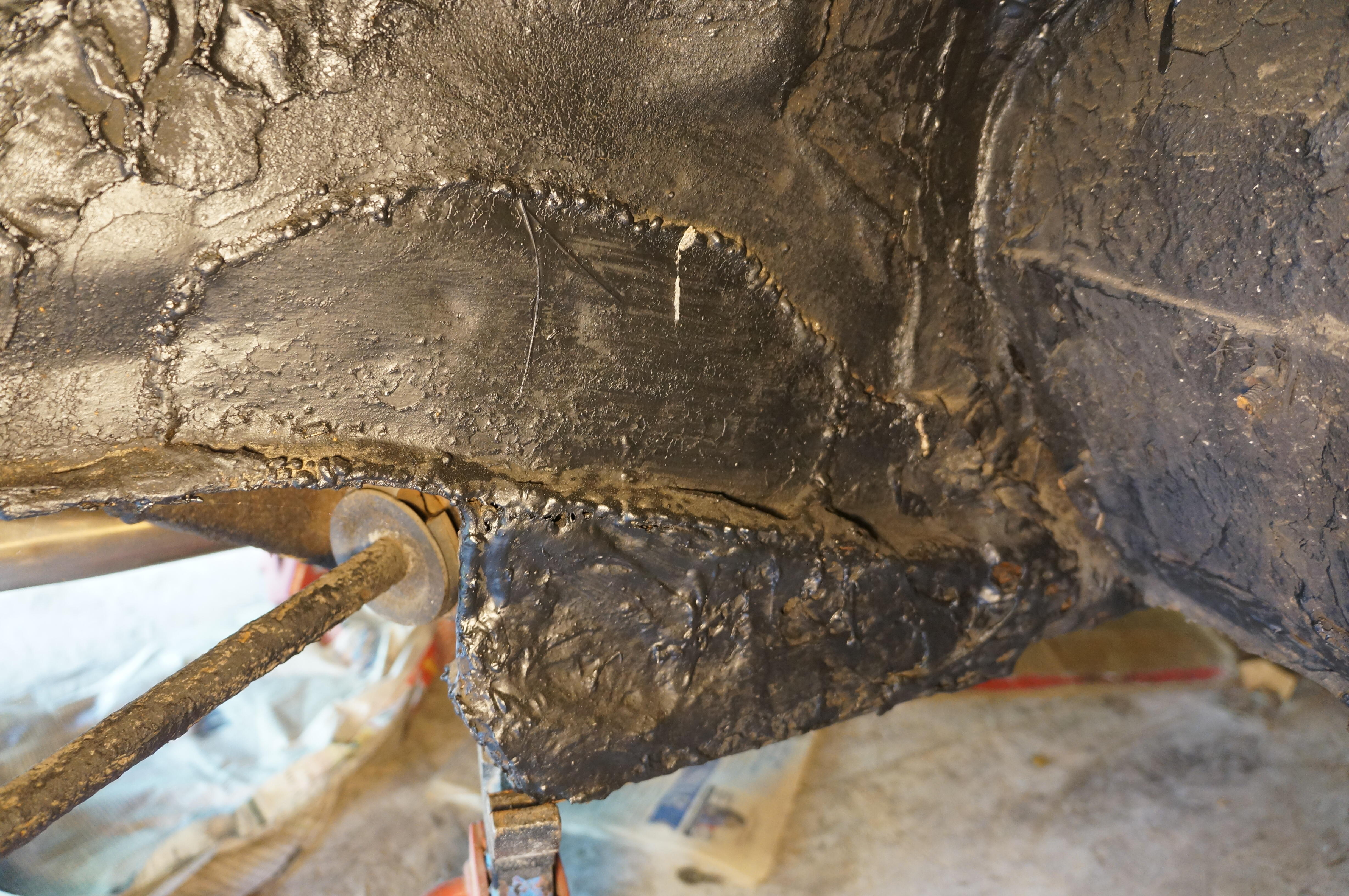

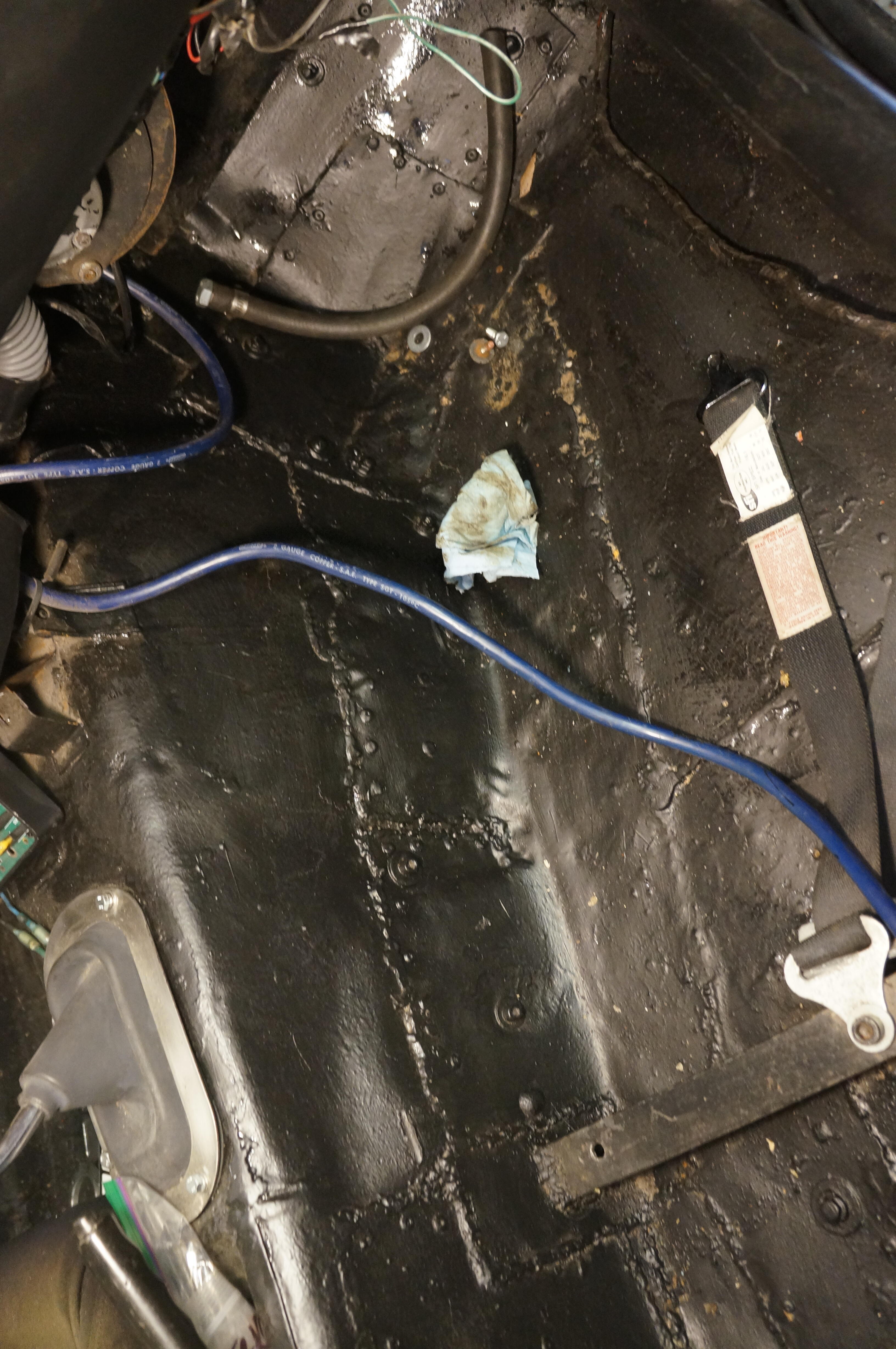

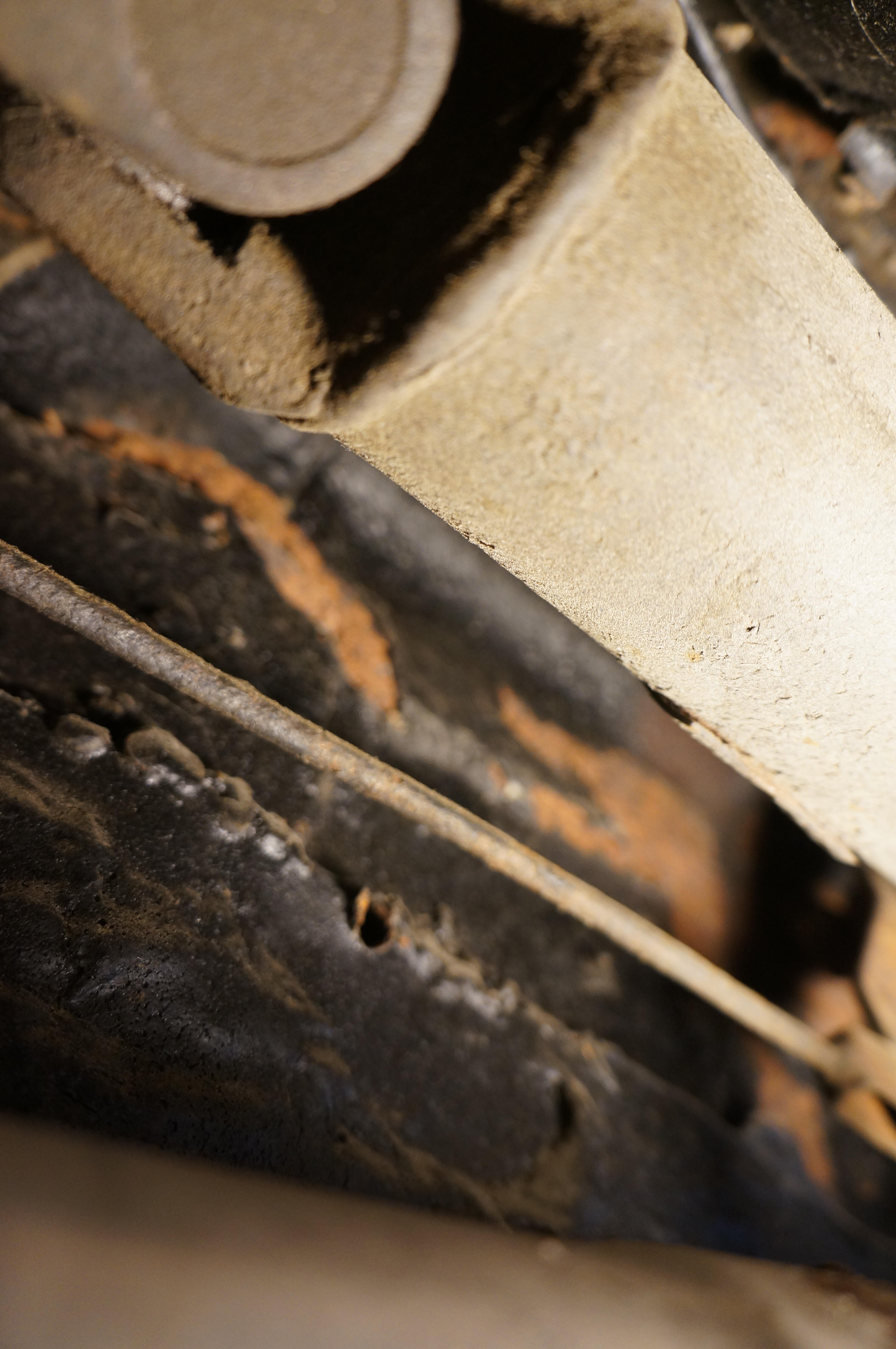

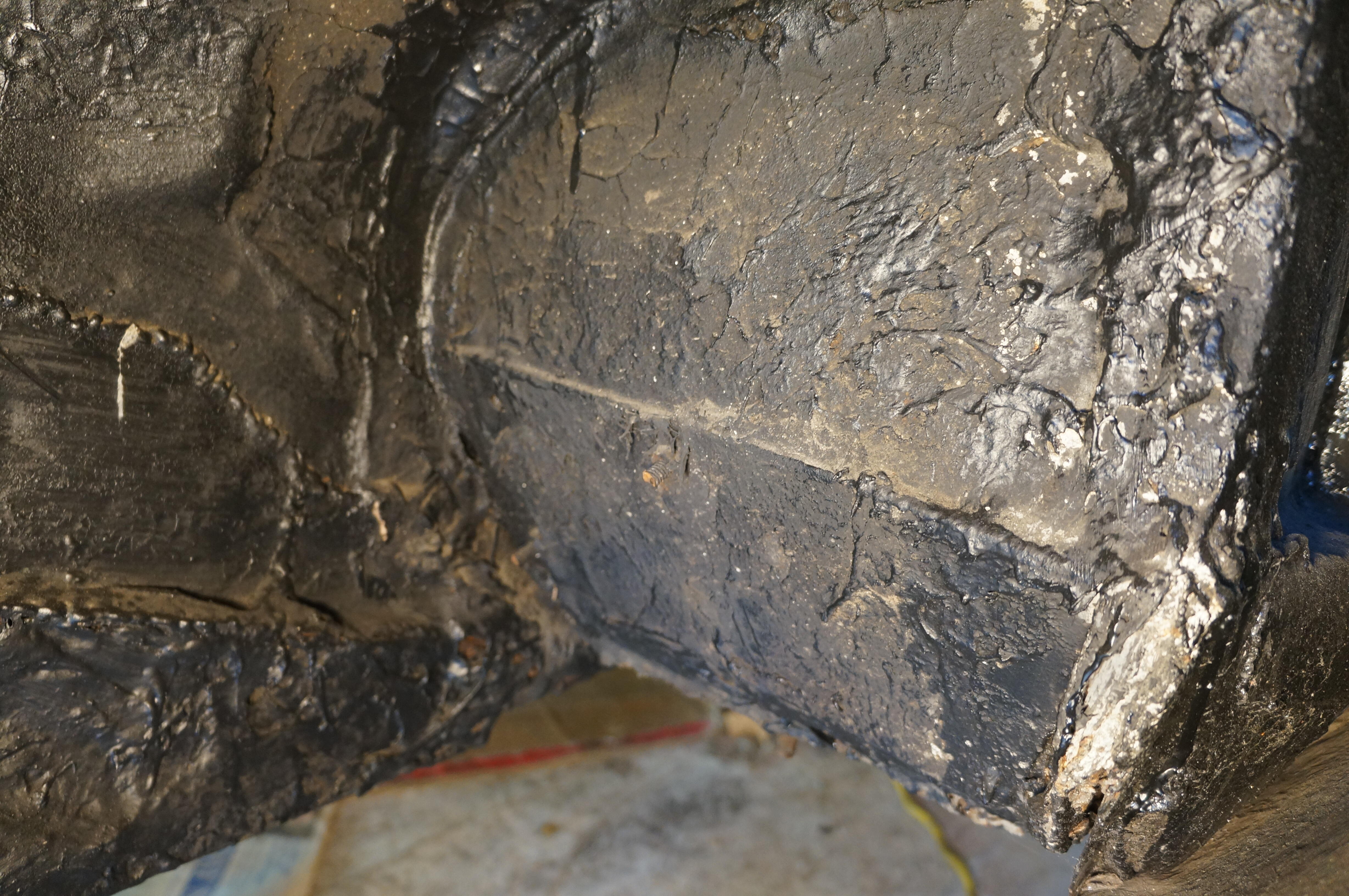

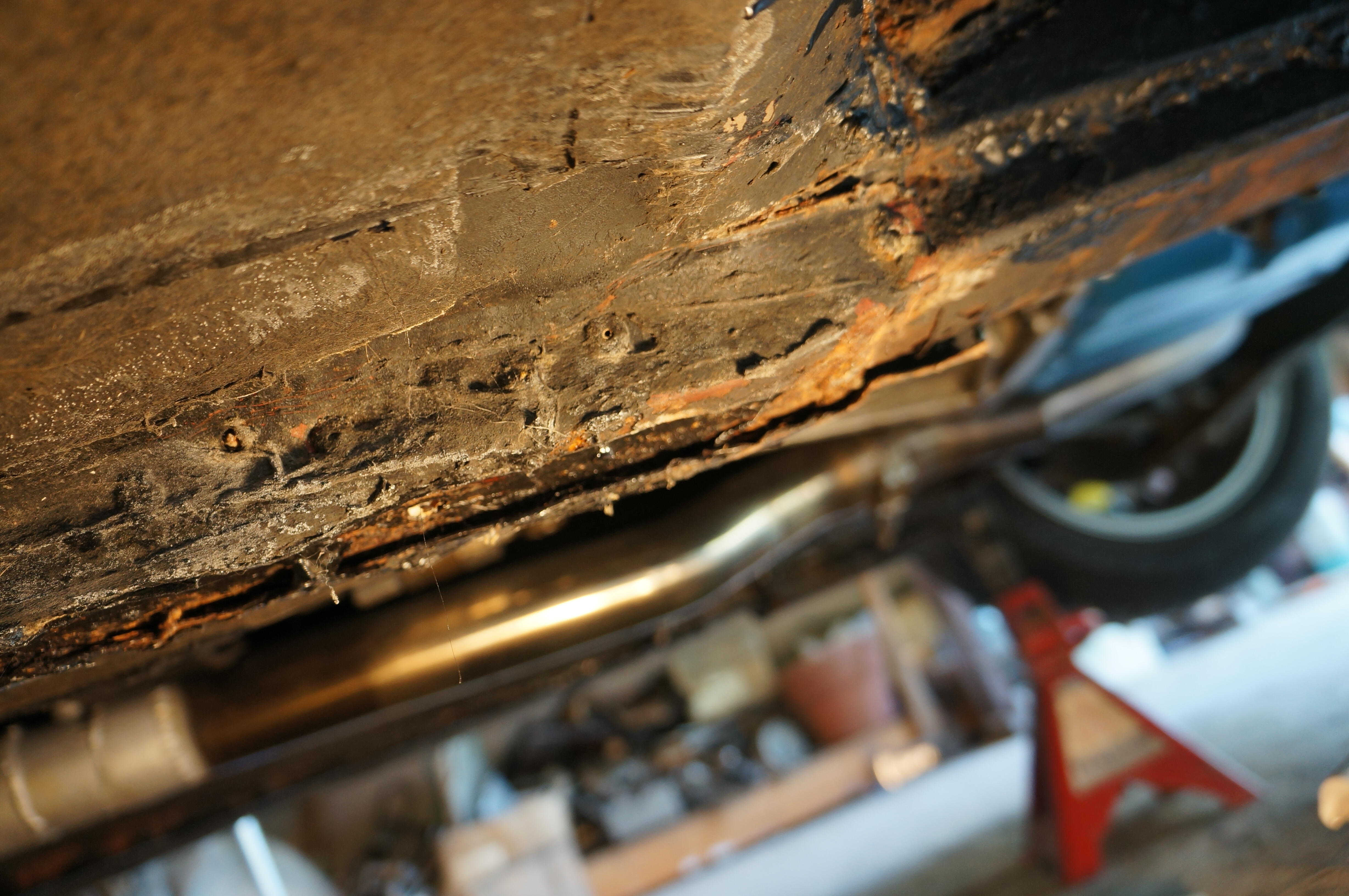

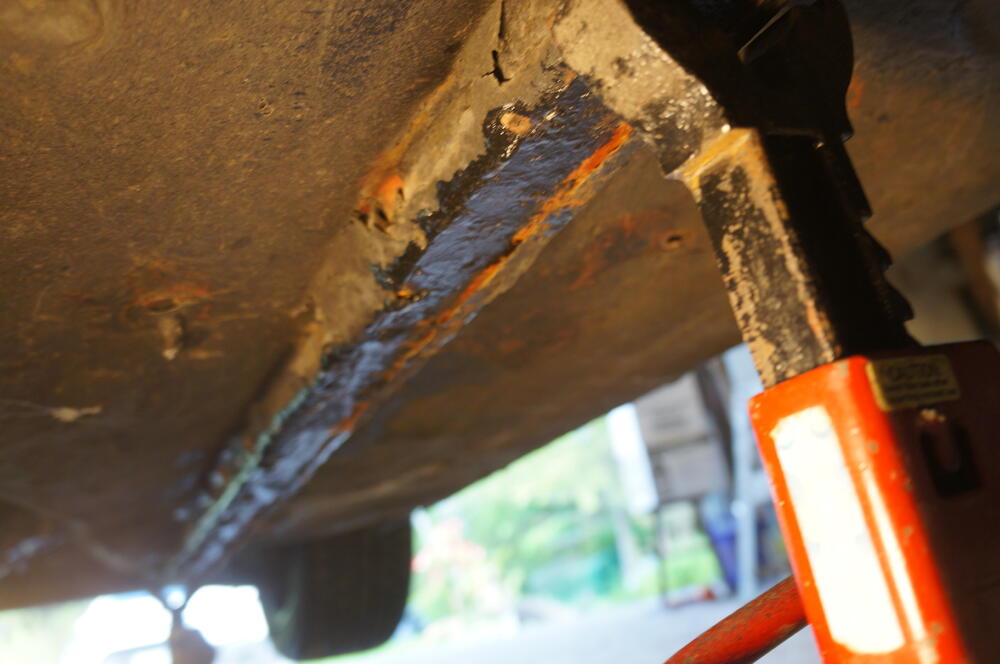

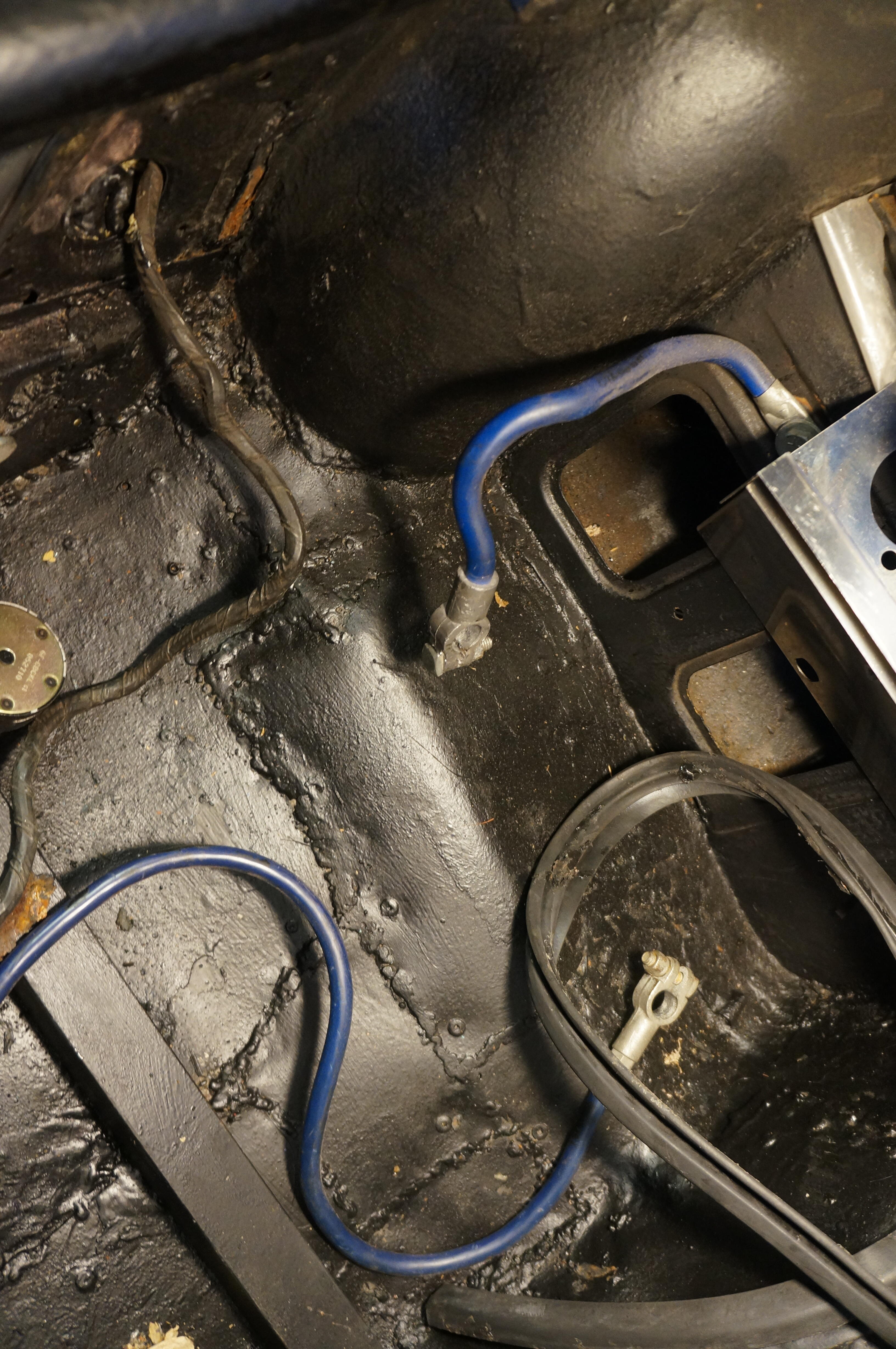

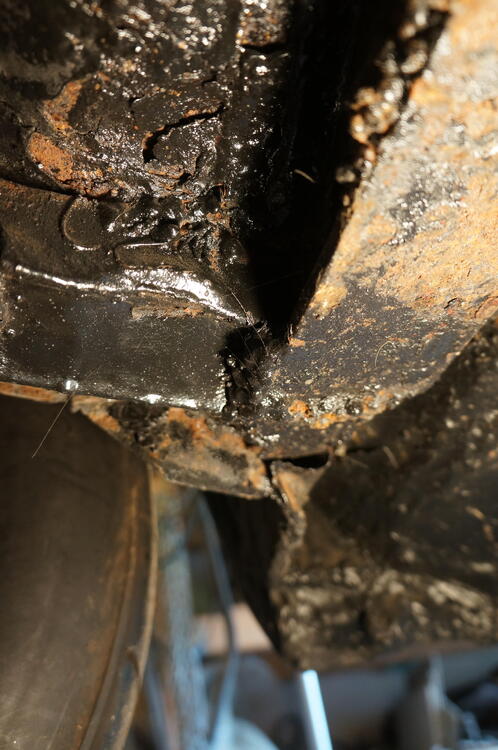

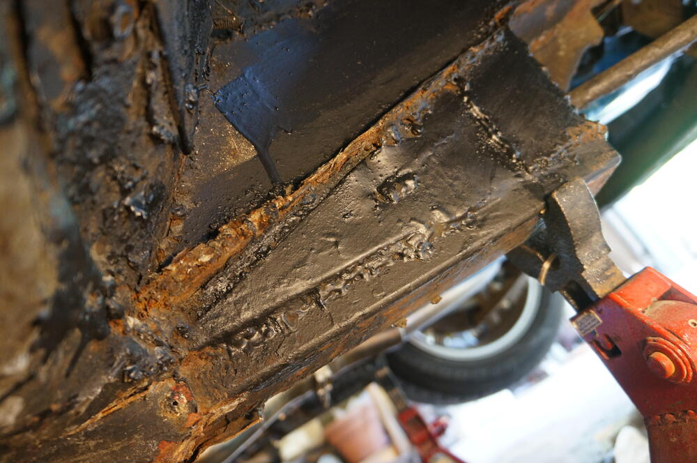

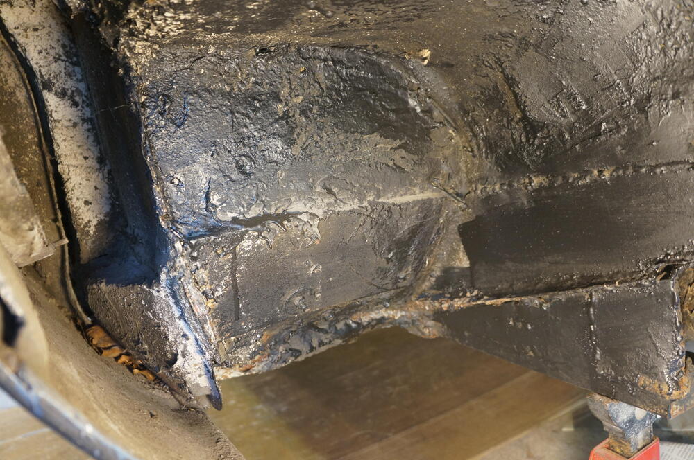

This car rolled into my shop last week, the owner wants to get ready to pass a safety inspection to get it licensed for the road. It has gone through 13 owners. The pics speak for themselves.
https://www.classiczcars.com/forums/topic/69009-hls30-00684/

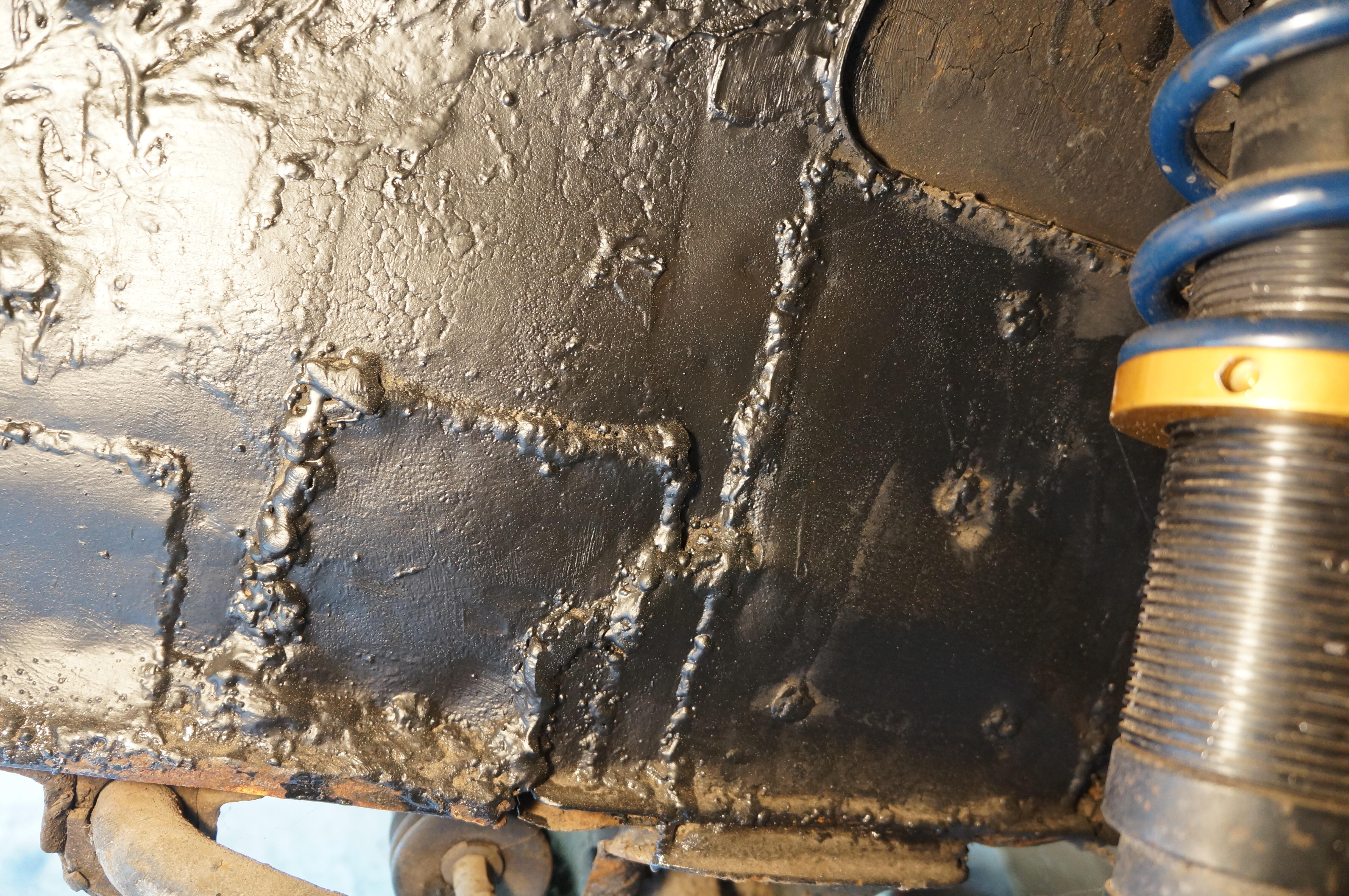

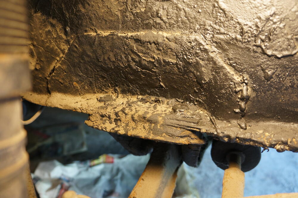

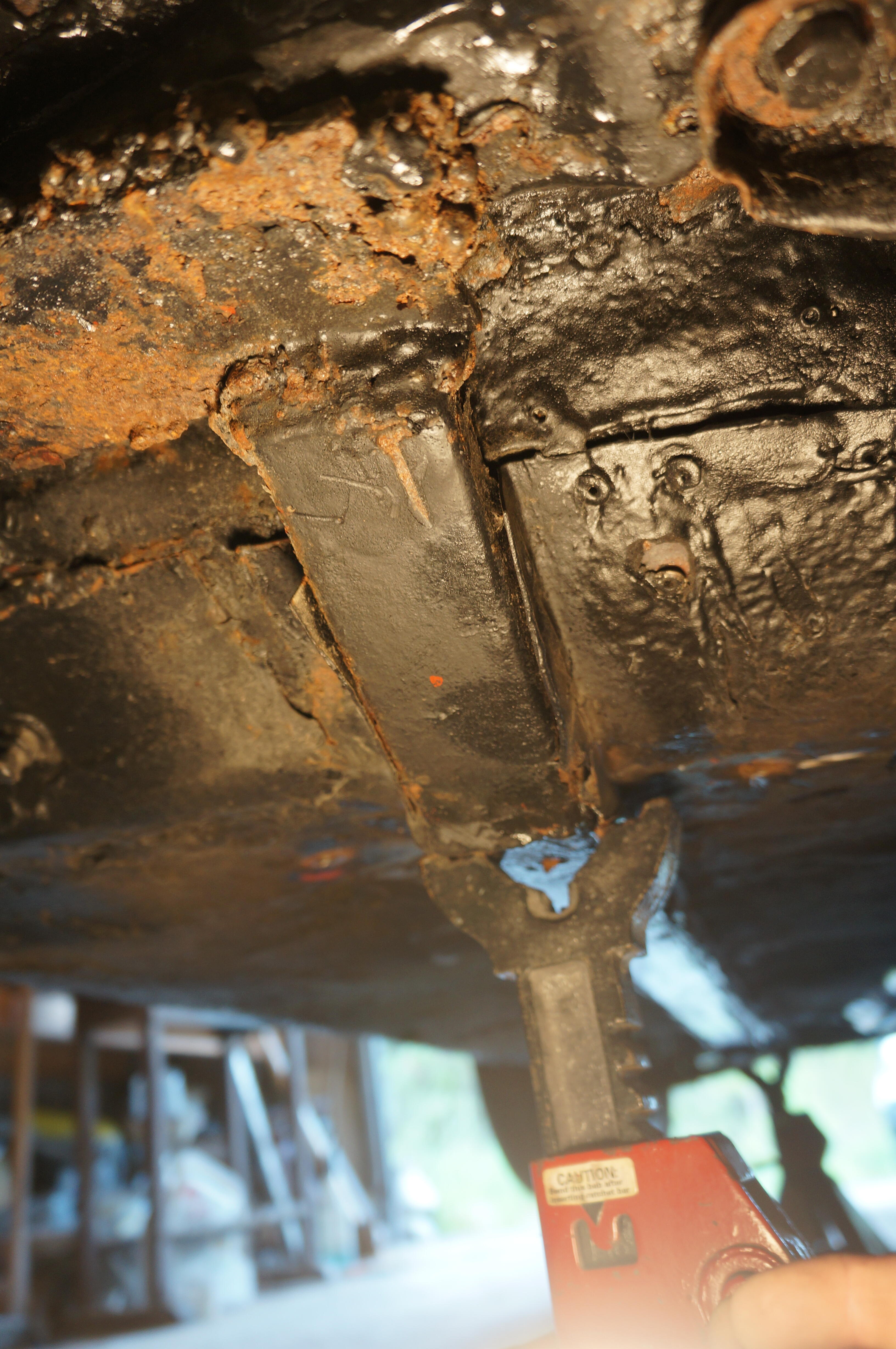

A few welds are strong, most are not and look like they were done with fluxcore, rivets, fiberglass, undercoat, Great Stuff expanding foam in a few cavity's. The thing that stopped me from taking it on as a project is much of the metal north of pans is also rotten and hidden under layers of undercoat.
I don't think anyone is making those panels.
IMHO it could be fixed but it would cost 2-3x what you would pay for a rust free project car. I'm suggesting he pass it along to owner #14 and hunt for a better car.
The owner would like to hear other opinions, what do you guys think?

Was that a muffler hanger holding the "roll bars"?  And a piece of strap steel for the seat belt?  What does "inspection" entail in your area?  How much needs to be done to pass?  Just curious.  It might be possible to get it past inspection but avoiding involvement with a future disaster is reason enough to say no.

I jacked it from the centre of the front crossmember and from the diff so didn't notice any sag or twisting, I wasn't about to use the regular jacking points. It's a safety inspection so first and foremost the structure has to be sound,  you would have to replace the bottom third of the car to pass that test.

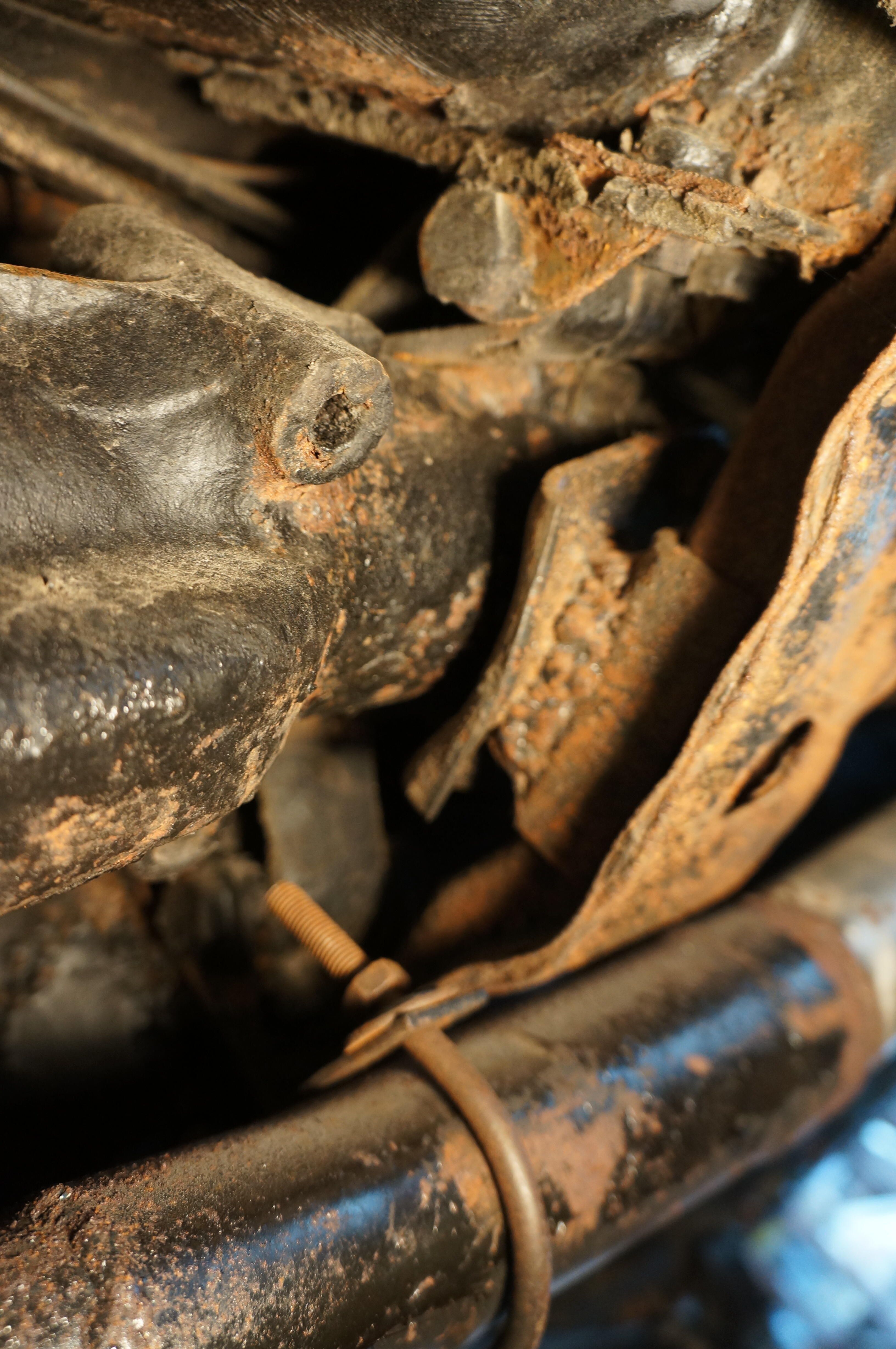

The exhaust pipe is welded to the diff mount, the diff is mounted to the bare steel of the crossmember, no bushing.
