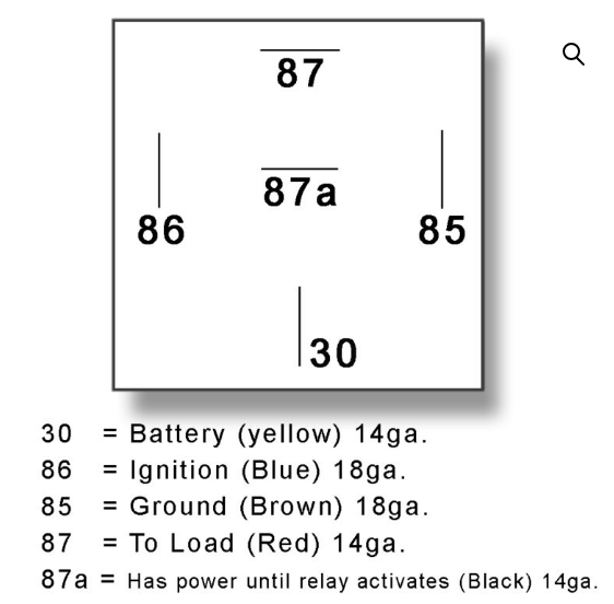

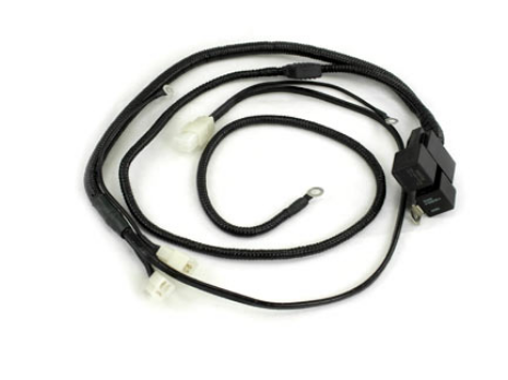

June 12, 2024Jun 12 comment_666435 8 hours ago, kenward1000 said: Zero battery voltage at pin 87 and zero voltage at pin 85 on the relays What about the pin for pin 30 on the relay? Might just be a bad connection at the battery supply. https://www.thezstore.com/product/3861/headlight-relay-upgrade-harness-70-73-240z Link to comment https://www.classiczcars.com/forums/topic/69010-no-headlights/?&page=2#findComment-666435 Share on other sites More sharing options...
June 12, 2024Jun 12 Author comment_666436 2 hours ago, Zed Head said: What about the pin for pin 30 on the relay? Might just be a bad connection at the battery supply. https://www.thezstore.com/product/3861/headlight-relay-upgrade-harness-70-73-240z Bingo! Last time my Z was in the shop for a checkup on my Rebello engine, the new wrench decided to replace the battery (which really didn't need replacing). The power cable for the dual headlight relays is black, so the new wrench assumed it went to the negative post on the battery. Moved it back to the positive post and headlights work again. Thanks so much for your help! It might have helped if the MSA kit had a red power cable or at least a "+" tag on it. Edited June 12, 2024Jun 12 by kenward1000 Link to comment https://www.classiczcars.com/forums/topic/69010-no-headlights/?&page=2#findComment-666436 Share on other sites More sharing options...
