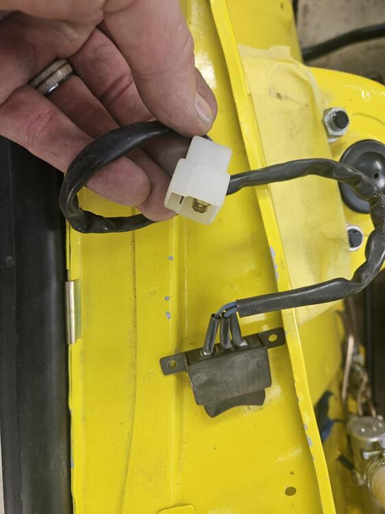

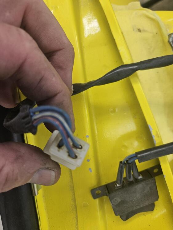

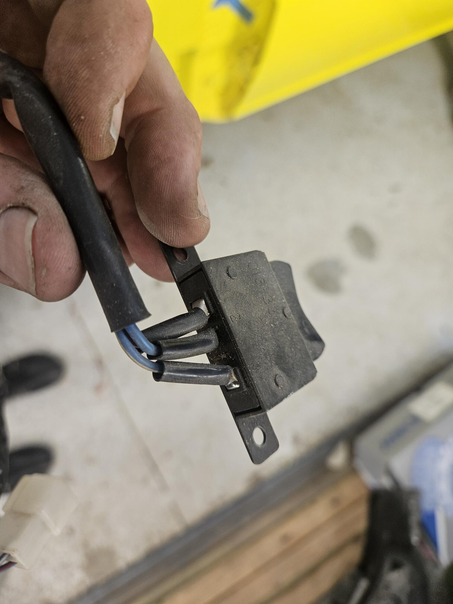

10 hours ago, SteveJ said:
How about a photo? Yes, it's from my 73, but I think the 70 would be similar. Yes, it branches off the main wiring harness.
Thanks Steve. I'll make that clear on my wiring diagram when I'm making the next batch of changes.

 I remember working on the antenna switch, but could not find a photo of its terminal block.
Thanks Chas. I looked through my pics and don't have anything good, but I believe the three connections to the antenna switch are three independent spade connectors on three loose wires. I'll confirm when I get a chance unless someone beats me to it.

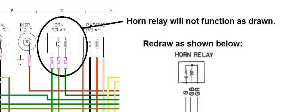

So how would you like me to communicate mistakes on your diagram? Screen shots? For example, like this:
Hi Captain, Communicate mistakes on my diagram or screen shots would be great. Your example is very clear. Thanx
I like the early wiring diagrams too. That is why I'm trying to keep it close to the original layout and adding terminals.

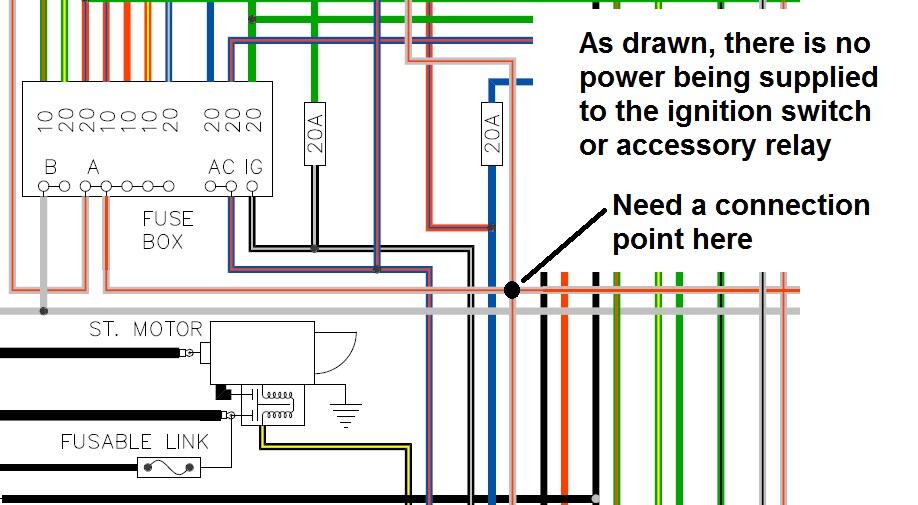

Chas, I took a couple pics of the radio area and will post them when I get a chance. In the meantime, here are a few things to look at:
First, As drawn. there is no power being supplied to the accessory relay or ignition switch. You need a connection dot on the W/R wire:

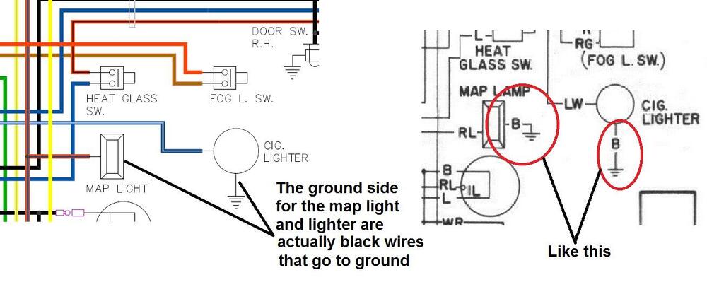

Second, the map light and lighter have black wires coming off them to make connection to ground. I have pics of these wires, but they were never shown well on the original documentation:

Hi Captain,
You have an good eye for detail.😀 I'm not sue if the Map light uses a bullet connector of spade for the power supply?
The blower is in the cabin and I think the Cooler is the engine fan maybe? , but I must admit I have never seen an original 240Z with original air-con fitted --> Thr blue branch off wire. The was from a source file I used from XenonZcar 9 years back.
