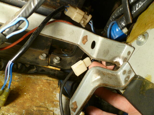

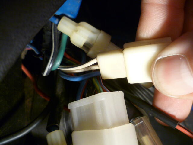

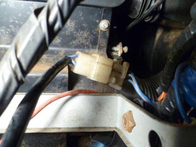

Here's some pics of what I have here. These are from a mid 70's car.
Map light connections on the car side:
P1230111.JPG:

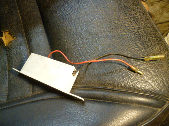

And on the light side:
Here's the lighter:

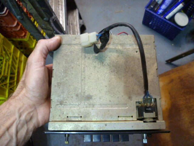

And here's what I believe is my antenna switch connections? Seems I have a pigtail leading into the three position connector everyone seems to have?
This might be an early car thing?
12 hours ago, Patcon said:
Does the 70 car have a different antenna switch than this?
The radio I have is from a later year. It has the later (horizontal) antenna switch design. I assume a PO changed it out at sometime in the past.
Evreything I find on the internet (ignoring the BS E-bay ads quoting antenna switches to suit datsun 240z to 280zx) seems to point to that type.

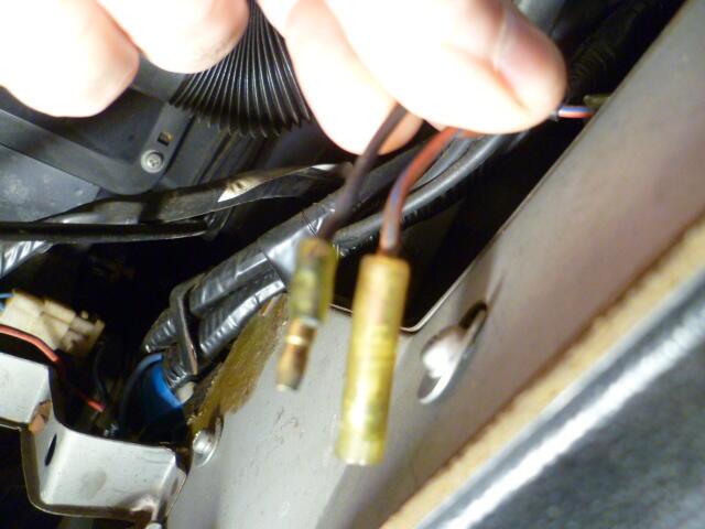

Here's the dash end of a U.S. Series One body harness (8/70). The two wires for power antenna and speaker wires are in the same 4-pin connector. Unfortunately I don't have the dash harness so I can't positively identify the harness to radio connection. The other end has a female bullet on the W and a male bullet on the W/B for the speaker connection.
Edited by cgsheen1

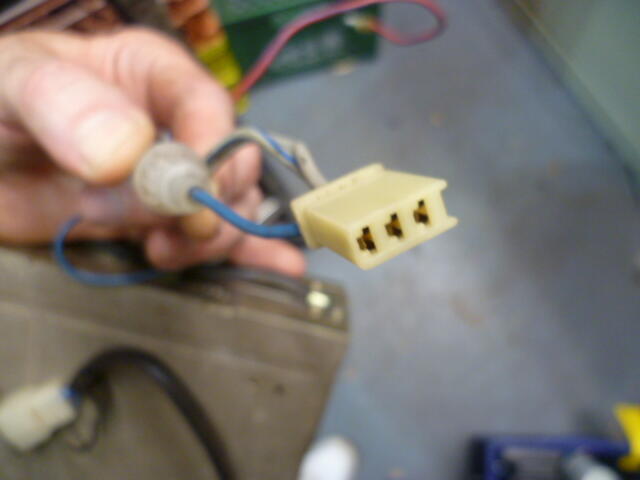

So here's a couple pics of an early radio, but not the earliest. It's the one with the horizontal antenna switch, not the vertical one:
I'm assuming the blue wire is 12V power in (because of the fuse and the noise filter choke ). Then that would make the other two the speaker connections:
And here on the chassis side, I've got this connector:
This connector seems to have basically the same colors as the one that goes to the radio. Blue power, plus the W and W/B for the speaker:
But the connector shape and is different than what you posted above? And your's has four wires, while what I have here only has three? I guess I need to see where that W and W/B go.
Agree, and the R/L is illumination and a male bullet on the radio makes sense as the harness side would have voltage with gauge lighting on. So in the FSM diagram above they show those four wires in a single connector. I'm going to check the 240Z in my driveway.
edit: nope. The Z I have is a friends 11/72 that I'm doing some electrical work on. The harness radio connector(s) apparently destroyed by radio installers in the past. It has the 3-pin at the harness for power and speaker - only the power is attached as he now has STEREO! So that's no help. Not a shock as most radio installations have been butchered over the years to get better tunes...
Interesting that the 1970 FSM Body Electrical shows a 4-pin connector for the radio and every other 240Z FSM shows the 3-pin pictured above and a separate lighting connector - including the 1971 Supplement.
