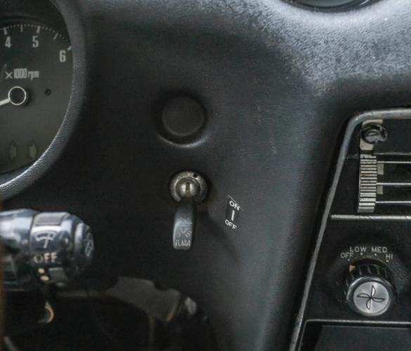

HS30-H Posted Monday at 10:33 AM #50 Posted Monday at 10:33 AM Won't win any prizes for photographic excellence, but here's an E4100 NILES early-type Fog Lamp Switch in its correct location on one of my other cars: 2
Captain Obvious Posted Monday at 03:17 PM Author #51 Posted Monday at 03:17 PM Thanks for the fog light pics. So my "F" switch clearly is just something that a PO stuck in there and I'll never know the intent. I'll pull it and plug the hole.

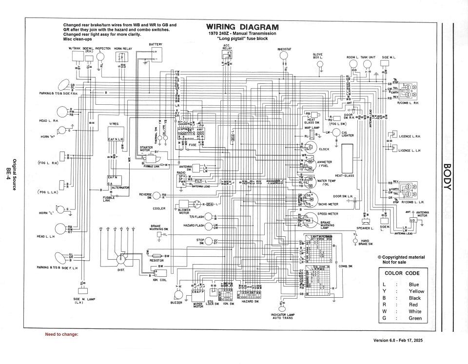

Captain Obvious Posted Monday at 03:28 PM Author #52 Posted Monday at 03:28 PM Here's the latest wiring diagram. I changed the wire color leading to the rear tail light assembly. At the hazard switch and the combination switch, the rear brakes/turns use a W/B and W/R pair, but somewhere inside the harness, they change to G/B and G/R pair by the time they get to the rear of the car. I also changed the portrayal of the rear light assemblies to show the bulbs inside. Note that in later 240's they changed one of the dual filament lamps in the back to a single filament. The car I'm working on is mid 1970 and I've got two dual filament bulbs on each side in the rear. <V6.0> _obvious 240Z Wiring Diagram 6.0.pdf 2
inline6 Posted Monday at 04:26 PM #53 Posted Monday at 04:26 PM (edited) This is great - thanks for doing this! Edited Monday at 04:30 PM by inline6
Captain Obvious Posted Tuesday at 01:15 PM Author #54 Posted Tuesday at 01:15 PM Glad to help. And as I continue to work through stuff here, I'll keep the documented updated if I find anything else that needs attention.

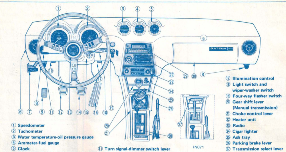

CanTechZ Posted 1 hour ago #60 Posted 1 hour ago Just to add to the discussion, here are a couple instrument panel pics from a 1970 JDM Fairlady Z brochure that I have. @HS30-H, Alan are you able to translate item 17. I'm guessing "optional fog light switch" 🙂 1
