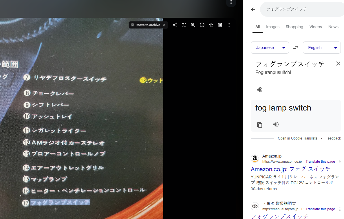

10 minutes ago, CanTechZ said:
Alan are you able to translate item 17. I'm guessing "optional fog light switch" 🙂
Indeed, it translates as "Fog Lamp Switch" and other factory literature identifies them as being an extra-cost showroom option.
Thanks Alan, just for fun I tried using the translate feature on google lens. It worked well.
