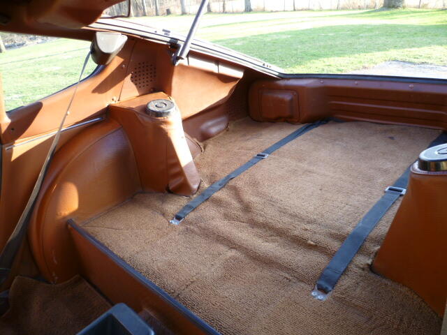

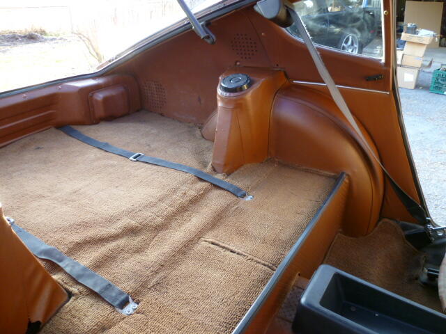

I believe you'll find that the interior panels are going to be more like the 280Z (75-76) than the 240Z. If I can remember to take photos of my 260Z when I get home, I will post them. Then you can visually compare them to the 240Z trim panels.

Of note are the vent holes above the strut towers. These look like speaker holes but are for the C pillar vents.
The bump out for the expansion tank is larger than the early 70-71 cars that had the plastic tank. Also I believe the 77-78 were different as well. (Raised Floors)
Your 260 should be the same as late 240 (72-73) to early 280 (75-76) and the 260 of course. 1974
Bump outs for the taillight access too. Early cars were flat panels.
