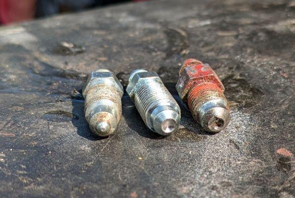

August 14, 2024Aug 14 comment_668240 8 hours ago, Jeff Berk said: Does anyone have an opinion on machining a modern bleeder screw to match the one used in the mk63? Before you go to that trouble, check out your national suppliers of old Jaguar parts (mossmotors.com for one) and investigate caliper bleed screws for the Girling-Dunlop brakes used on 50s and 60s models such as the MK.1 through Mk.10, XK150 and early E-Type. The Sumitomo MK63 licensed a number of Girling-Dunlop patent designs which also used the ball-bearing type bleed screw system. On 8/10/2024 at 8:42 PM, Jeff Berk said: I have a Wilwood 1-inch master cylinder I bought off someone that I'm trying to figure out what to do with since I'm no longer going with the Toyota 4X4 brakes. Is there any advantage to installing this unit over staying with the OEM? Larger bored master cylinders are not required. I have used both solid rotor and vented rotor type MK63 calipers on many of my cars over the years (still use them on four current cars) and I always use the stock 7/8" master cylinder. I even use the 7/8" bore on my 432-R replica with its Master Vac delete (pedal motion ratio is modified) and they work well. Nissan's own recommendation was to use stock MC. A friend over here fitted a Wilwood 1" MC on his rally 240Z with vented rotor type MK63s and found that it gave a high and firm pedal feel but was hard to use. Switched back to a stock 7/8" MC which I supplied to him and he was MUCH happier. Link to comment https://www.classiczcars.com/forums/topic/69054-help-id-brake-calipers/?&page=5#findComment-668240 Share on other sites More sharing options...
August 14, 2024Aug 14 Author comment_668247 HS30-H I learned of the similar Jag bleeder last night while researching the Sumitomo. It appears to have also been used in some Studebakers like the Avanti. A post on a Studebaker forum suggested just cutting off the tip of a modern bleed screw to create one. The Jag screws, at least the one I found a reference to were 3/8" 24 thread although they also used a 3/16-inch ball. Captain Obvious The treading was a little messed up on the original bleed screw, possibly from being over tightened but the caliper's threads seemed to be fine. The old screws were tightened to the point where the flat tip was deformed by the ball bearing. I just came back from the makerspace where I modified a pair of bleeder valves I had on hand. The photograph shows from left to right, an unmodified bleeder, a modified, and the original. The original likely had a flat bottom when new but was damaged as mentioned above. I decided to mill a shallow 3/16-inch diameter concaved surface to secure the ball instead of just making a flat surface. This was likely unnecessary. I then spun the 3/16 end mill by hand in the caliper where the ball seats to clean it up a little. I might try and assemble this and see if I can draw a vacuum with the valve closed to test for leaks. Link to comment https://www.classiczcars.com/forums/topic/69054-help-id-brake-calipers/?&page=5#findComment-668247 Share on other sites More sharing options...
August 15, 2024Aug 15 comment_668253 Cool. I didn't think they were hardened, but had to bring it up just in case. Nice work. Edited August 15, 2024Aug 15 by Captain Obvious Link to comment https://www.classiczcars.com/forums/topic/69054-help-id-brake-calipers/?&page=5#findComment-668253 Share on other sites More sharing options...
