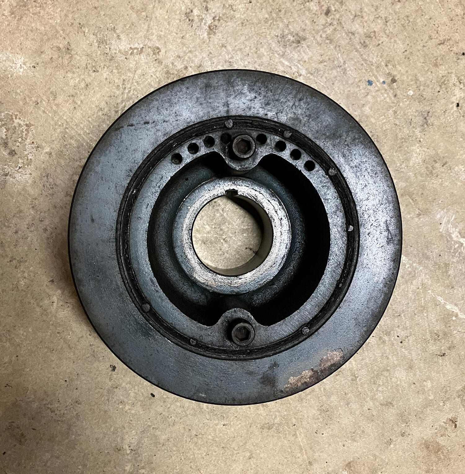

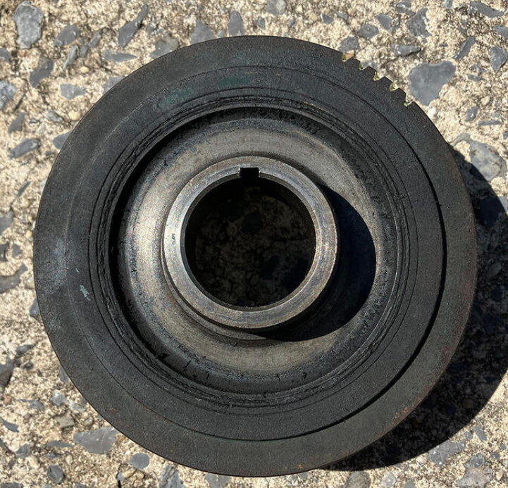

September 4, 2024Sep 4 Author comment_668917 53 minutes ago, Zed Head said: Looks like a bad damper. How about a picture of the face of it? That second pulley has seen some weather. Looks very old. Don't be afraid to really give it a tug to try to pull it apart. It's supposed to be very firmly bound. Here's the face. A pic of the back of it can be seen earlier in the thread. 95% sure it's original. The A/C (front-most) pulley came off easily when I removed the crank bolt. The harmonic damper itself has two belt grooves (middle one for air pump and rear one for WP & alternator) and I don't see an obvious parting line between them. I was hoping someone with an extra (known-good) damper lying around could tell me if the timing marks are in the right ballpark relative to the keyway based on the picture of the back. Does anyone have a source for a replacement? The usual suspects seem to be out of them. Link to comment https://www.classiczcars.com/forums/topic/69086-240z-will-not-run-right/?&page=3#findComment-668917 Share on other sites More sharing options...

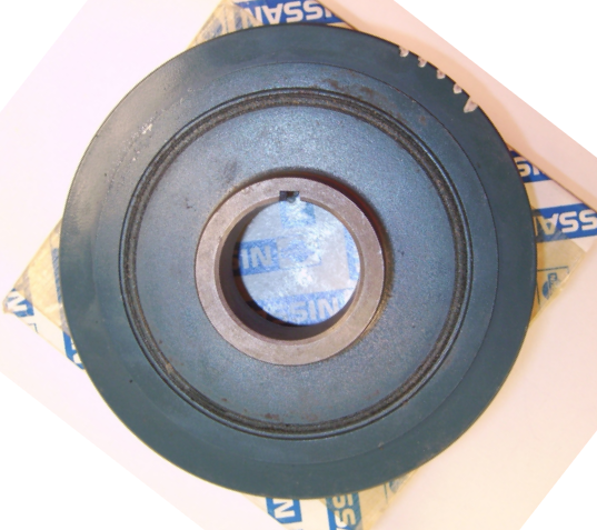

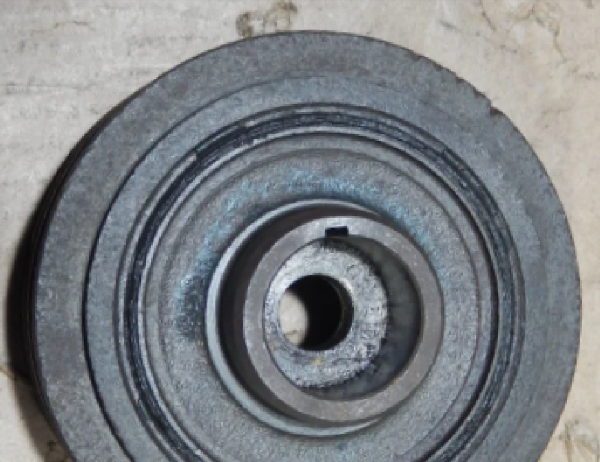

September 4, 2024Sep 4 comment_668918 I found an ad for a "Euro" damper and it looks like yours. Don't know how it's different from State-side. I'll look a little more. https://datnissparts.com/x-euro-crankshaft-damper-pulley-harmonic-balancer-240z-260z-280z-510-all-l-engines-12303-e4100/ Spun the picture in Paint 3D. Yours Link to comment https://www.classiczcars.com/forums/topic/69086-240z-will-not-run-right/?&page=3#findComment-668918 Share on other sites More sharing options...
September 4, 2024Sep 4 comment_668919 It's hard to tell without a close up but it looks to have a sheared line in the rubber going around Link to comment https://www.classiczcars.com/forums/topic/69086-240z-will-not-run-right/?&page=3#findComment-668919 Share on other sites More sharing options...
September 4, 2024Sep 4 comment_668921 I found another that doesn't say Euro. It looks about the same. Not sure what's going on here. I'd probably take the time to verify TDC and mark it on the damper pulley. Then use a dial-back light to set timing. https://maseraticompound.com/products/datsun-240z-main-crank-shaft-pulley-with-extra-ac-belt-pulley Link to comment https://www.classiczcars.com/forums/topic/69086-240z-will-not-run-right/?&page=3#findComment-668921 Share on other sites More sharing options...
September 4, 2024Sep 4 comment_668922 It was fun looking around at the different dampers out there on the internet. Seems like your damper is fine. I'd rotate the engine around twice by hand and put that bottom/left side mark on the pointer. Then see how the cam sprocket lines up. If you use the cam sprocket to turn the engine make sure that you turn it backward before checking your marks. So that the slack is removed from the tight side of the chain. That might explain some of the discrepancy in your notch and groove. Ideally, everything is assembled and the engine is turned clockwise via the crankshaft bolt, or the fan belt, looking at it from the front, to keep the tight side of the chain tight. Assume that the TDC/zero mark is the farthest to the left, looking from the front. Edited September 4, 2024Sep 4 by Zed Head Link to comment https://www.classiczcars.com/forums/topic/69086-240z-will-not-run-right/?&page=3#findComment-668922 Share on other sites More sharing options...
