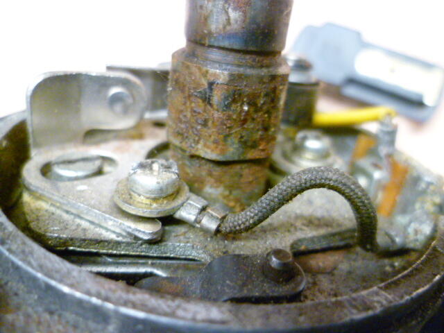

September 12, 2024Sep 12 comment_669211 3 minutes ago, inline6 said: If absolute accuracy matters to you, the spade for the wire hook up points upwards instead of to the side originally. Like this? Link to comment https://www.classiczcars.com/forums/topic/69086-240z-will-not-run-right/?&page=5#findComment-669211 Share on other sites More sharing options...
September 12, 2024Sep 12 Author comment_669213 ^Thanks for that. You'd be surprised at how hard it is to find a pic of a stock distributor's wiring online. Link to comment https://www.classiczcars.com/forums/topic/69086-240z-will-not-run-right/?&page=5#findComment-669213 Share on other sites More sharing options...

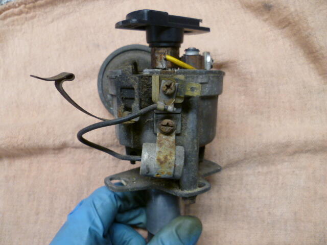

September 12, 2024Sep 12 comment_669214 Glad to help. So comparing your pic to what I have here, there are some other differences. I'm not sure which is correct, but the wiring inside my distributor is a little different than yours. On the inside of mine, the ground wire went to the other side of the points than yours, and I've got this yellow wire on the high side of the points. Functionally it doesn't matter where the ground wire goes, and I'm guessing that my yellow wire was put in by a previous owner. Here's what I got. Input on originality appreciated: Link to comment https://www.classiczcars.com/forums/topic/69086-240z-will-not-run-right/?&page=5#findComment-669214 Share on other sites More sharing options...
September 12, 2024Sep 12 comment_669215 i kinda like the way your ground wire runs to the other side of the points. I wasn't completely comfortable with the way they were sharing a slotted hole on the points with the big washer AND the electrical connection. After seeing your pics, I'm thinking that wire should go to the other points screw like you have yours. Link to comment https://www.classiczcars.com/forums/topic/69086-240z-will-not-run-right/?&page=5#findComment-669215 Share on other sites More sharing options...
September 12, 2024Sep 12 Author comment_669216 I thought about securing the left end of the wire to the side you have it, but I was a little concerned with the wire being pulled taut when the timing is advanced. Electrically it doesn't make a difference since they both connect to the same big plate. Link to comment https://www.classiczcars.com/forums/topic/69086-240z-will-not-run-right/?&page=5#findComment-669216 Share on other sites More sharing options...
September 12, 2024Sep 12 comment_669217 1 hour ago, Captain Obvious said: Like this? I mean for the wire from the harness, not the capacitor wire. Like this: https://jdm-car-parts.com/products/euro-spec-distributor-for-datsun-240z-w-manual-transmission-nos and this: Edited September 12, 2024Sep 12 by inline6 Link to comment https://www.classiczcars.com/forums/topic/69086-240z-will-not-run-right/?&page=5#findComment-669217 Share on other sites More sharing options...
September 12, 2024Sep 12 comment_669219 2 hours ago, BoldUlysses said: Awesome, thanks. I mainly wanted to make sure I had hooked the condenser up correctly. Dielectric grease OK for the cam? Wasn't sure, so I did a search and found this 🙂 "Yes, dielectric grease can be used on a distributor cam. Silicone dielectric grease can be used to lubricate the cam lobe rubbing block contact on a distributor, and it can also be used to seal electrical connections and ensure conductivity. Some recommend re-lubing the cam lobe rubbing block contact every 3,000 miles." Edited September 12, 2024Sep 12 by inline6 Link to comment https://www.classiczcars.com/forums/topic/69086-240z-will-not-run-right/?&page=5#findComment-669219 Share on other sites More sharing options...
September 12, 2024Sep 12 comment_669220 Might as well check the condenser before you get too far along. It should have "OL" from the wire to the condenser body metal. No continuity. You can also measure capacitance if you have the right meter but it's not commonly done. And .020 is your point gap. It should determine the dwell on a new cam but a dwell measurement is more precise. It's measured in degrees with a dwell meter. As the cam wears the dwell could change. Mechanical ignition systems are more complex than they seem. Kind of amazing that they work like they do at high RPM. Here's a pretty good article from Pertronix. https://pertronixbrands.com/blogs/product-higlights/understanding-ignition-dwell?srsltid=AfmBOooVjLx4762Zc7UGTaiEOiTUuhwututQ4aKVsDB2ZJPHPywx_gMZ Link to comment https://www.classiczcars.com/forums/topic/69086-240z-will-not-run-right/?&page=5#findComment-669220 Share on other sites More sharing options...
September 13, 2024Sep 13 comment_669221 10 hours ago, inline6 said: I mean for the wire from the harness, not the capacitor wire. Like this: https://jdm-car-parts.com/products/euro-spec-distributor-for-datsun-240z-w-manual-transmission-nos Hmmm... So on my and BoldUlysses distributors, the electrical connection to the coil sticks out sideways instead of upwards towards the cap. I had tried before to swing the condenser connection to the side (instead of from the bottom), but I changed my mind because of the poor fitment. It got in the way of the other spade to the coil. So the spade to the coil should point upwards instead of sideways? As shown on the euro distributor you linked to: Link to comment https://www.classiczcars.com/forums/topic/69086-240z-will-not-run-right/?&page=5#findComment-669221 Share on other sites More sharing options...
September 13, 2024Sep 13 Author comment_669223 41 minutes ago, Captain Obvious said: Hmmm... So on my and BoldUlysses distributors, the electrical connection to the coil sticks out sideways instead of upwards towards the cap. You can orient the little metal tab whichever way you want; just loosen the screw & rotate it 90°. It may have originally been oriented up when I had the points on before; I don't remember. To the side just kind of made sense to me this time around, given the direction the ignition wire comes from. Link to comment https://www.classiczcars.com/forums/topic/69086-240z-will-not-run-right/?&page=5#findComment-669223 Share on other sites More sharing options...
September 13, 2024Sep 13 comment_669236 10 hours ago, BoldUlysses said: To the side just kind of made sense to me this time around, given the direction the ignition wire comes from. Me too. The coil tab to the side made sense to me as well. But orienting both the connections in the same position didn't work well. In any event, it's really not a big deal. Thanks for bringing up the questions so I could tag along for the ride! Link to comment https://www.classiczcars.com/forums/topic/69086-240z-will-not-run-right/?&page=5#findComment-669236 Share on other sites More sharing options...
