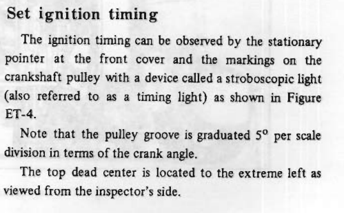

  • With the crankshaft in the proper position (#1 piston at top dead center at the end of the compression stroke), verify that the "correct" mark on the crankshaft pully is in "perfect alignment" with the pointer on the engine front cover.  If I remember correctly, the "correct" mark (0 degrees) is the one on the far right when standing at the front of the car and looking down onto the pully marks.

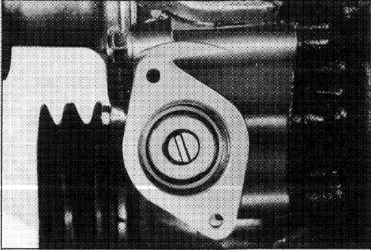

  • With the crankshaft in the proper position, verify the oil pump/distributor drive gear "tang" alignment is "correct".  Reference page EM-32 in the factory workshop manual:

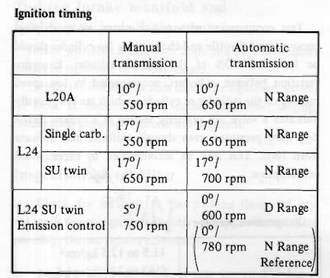

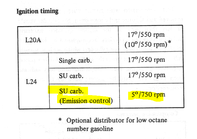

The correct initial timing specification is dependent on which distributor you have.  From the factory workshop manual - if I am not mistaken, US cars were "SU carb. (emission control)":
Which do you have?  Please post the markings/identifications on your distributor here.  17 degrees initial is the correct spec for the euro distributor.  That one is relatively rare.  Confirm the correct initial setting for the distributor you have.
Ignition timing is two different things - initial and "with advance".  For driving around the block, the "with advance" isn't going to be your problem, but it is worth checking while you are at it.  After you have set initial timing for the distributor you have, check the maximum timing also by revving the engine.  Rev to 2k to 3k to 4k and note the timing.  Generally speaking, you should see a progression from your initial value to something between 32 degrees and 38 degrees and it should reach its maximum value before 4k.  If you do not see the timing change from the initial amount to something like this, report back what you see.

Yes a major effort of the thread has been to ensure everything in the engine is in sync.  I verified that TDC on the #1 cylinder matches the bottom mark on the front pulley, like it should.  The distributor drive tang is correct.  The distributor is timed to 17° because all the emissions controls have been removed from the engine.  Is there something internal about the distributor for emissions-controlled cars (weights, dashpot, etc)?

I was asking if there was something internally different (e.g. different weights/dashpot = different advance curve) about the Euro distributor that meant that setting a US-spec one—which I assume I have—to 17° (the non-emissions-controlled spec) would result in poor running once the car was under load and the advance started to kick in.

The groove picture above is taken with the engine at TDC, timing pointer aligned with the bottom mark on the front pulley when viewed from the fuel pump side of the engine.  We established earlier in the thread that my front pulley is OK and not separated, so I'm going to trust that its TDC mark is accurate (also confirmed by the position of the #1 piston).

I meant in your driving video.
But, apparently that's the right number.  Assuming that the distributor is the original.
The FSM does not say anything about removing the hose though.  That is definitely a US domestic old car thing.  I'm not sure how Nissan did theirs.  They don't say.
