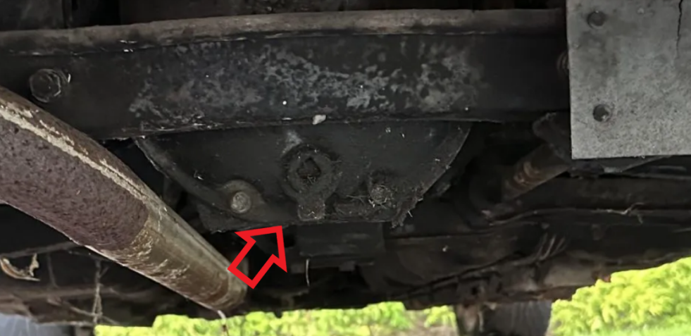

September 3, 2024Sep 3 comment_668913 11 minutes ago, Homepup said: I notice the strut housing is almost 2 inches higher along with being a larger diameter. That does sound like the 280Z strut. The strut towers in the body of the 280Z are taller than the 240Z's. I've never heard of anyone doing that swap, seems like there would be very little suspension travel and the springs would be designed for more wight. The back end would be higher. If you look closer you might find more modifications. Cut springs maybe. The shocks might be fully compressed already. I'd guess that you'd be better off resintalling the 240Z suspension. Here's a link to the parts page. Not much interchange. p.s. you can tell an R200 from an R180 by the rectangular block of metal under the drain plug on the cover. https://www.carpartsmanual.com/datsun/Z-1969-1978/axle/rear-suspension Borrowed this from a recent BaT listing. Link to comment https://www.classiczcars.com/forums/topic/69095-rear-strut-housing-replacement-or-not/#findComment-668913 Share on other sites More sharing options...

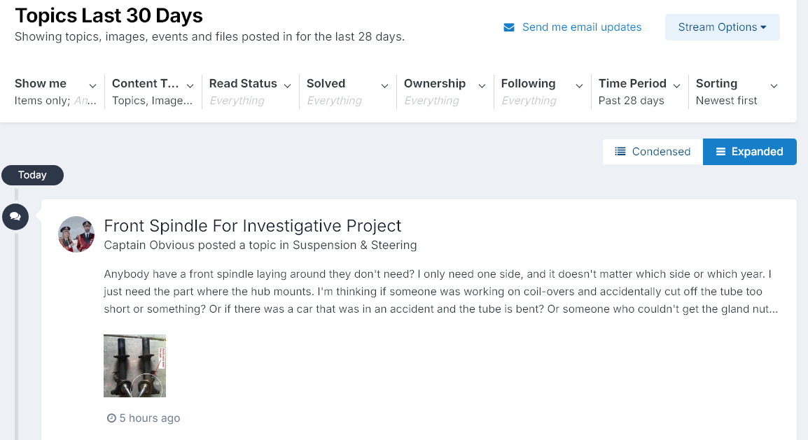

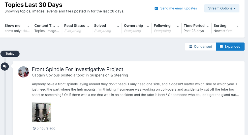

September 6, 2024Sep 6 comment_669006 @Mike Edit - but now it has come back. Strange stuff. Probably uncipherable. This thread has disappeared from the Activity page. It should be one of the top ones since I posted three hours ago. But I can get to it through the Notifications links. Weird. Here's the latest on the Activity page. CO's five hour old post is top of the page. Edited September 6, 2024Sep 6 by Zed Head Link to comment https://www.classiczcars.com/forums/topic/69095-rear-strut-housing-replacement-or-not/#findComment-669006 Share on other sites More sharing options...
